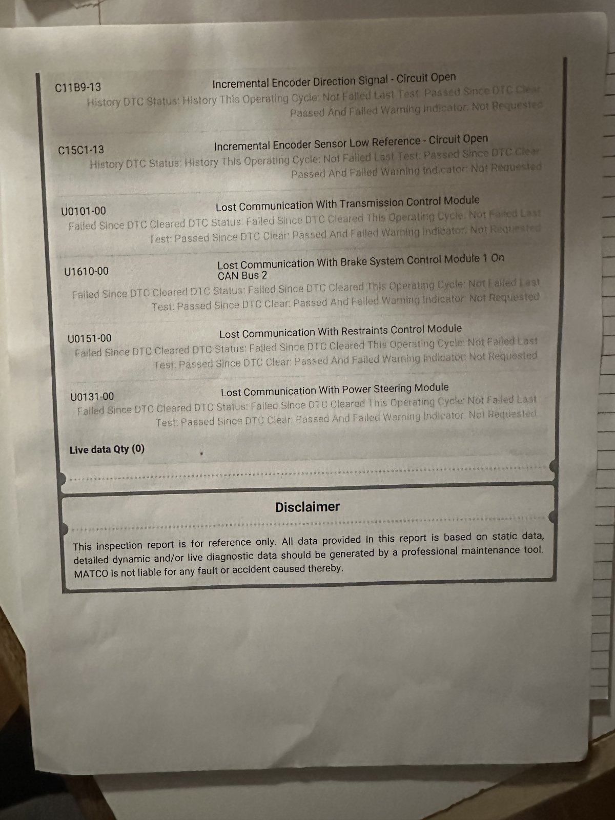

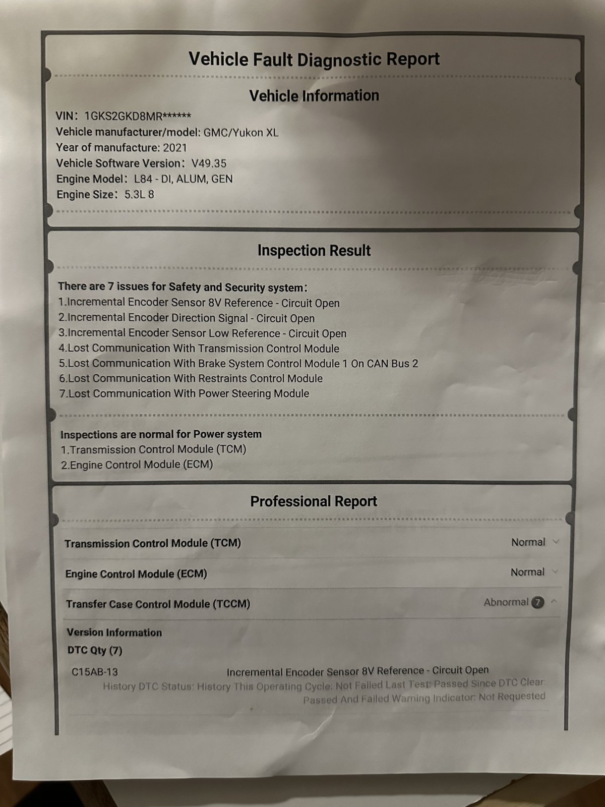

I have a 2021 gmc Yukon xl with just a few over 38000 miles. I had a bad wheel bearing at a little over 32000 miles. While driving the other night my service 4wd warning flashed on my dash. I pulled over into a parking lot and while turning into a spot the vehicle was struggling to go. I turned off the vehicle waited a minute and turned it back on it drove fine but still had service 4wd warning. I took it to a local garage and had them print of the error codes it was throwing. Today the dealership saw it. Apparently it’s a connector in my transfer case that’s bad. There is a service bulletin out about it they told me. It’s not covered under power train and my bumper to bumper warranty is 2000 miles expired. Has anyone had this problem with the new body styles of the Yukon and Tahoe. I know things happen with any vehicle but I’m so annoyed that I paid so much for a car that has had quite a few things replaced on it with so little miles. Just wondering what experiences people have had. I know because I have a ****** (lol) that sometimes the dealership doesn’t really talk to me like I know what’s going on. I appreciate anything you have to offer! I attached a pic of the errors my car threw.

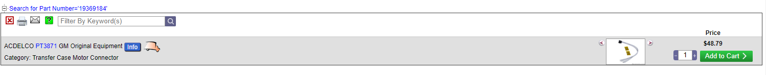

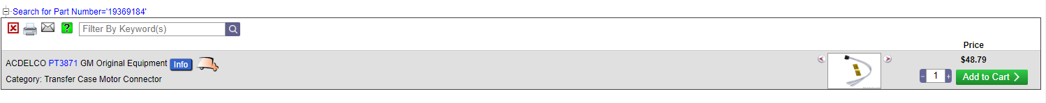

Saw the TSB on this one recently - when I get mine on the lift for my next oil change I'm going to take a peek at that transfer case connector and see how mine looks.
Here's the TSB - https://static.nhtsa.gov/odi/tsbs/2023/MC-10231427-0001.pdf
Part is available on RockAuto.com for $50 - shouldn't take more than 15-20min to splice in the new repair connector. I would first talk to the dealer, show them the TSB - GM is aware this is a defect and I think any dealer should give you a "goodwill repair" since you are so close to 36K. If that route doesn't work and you'd prefer not to do it yourself, then I would find an independent shop or a friend that is decent with basic wiring. Order the connector and have them fix it. Total repair bill should be ~$100.

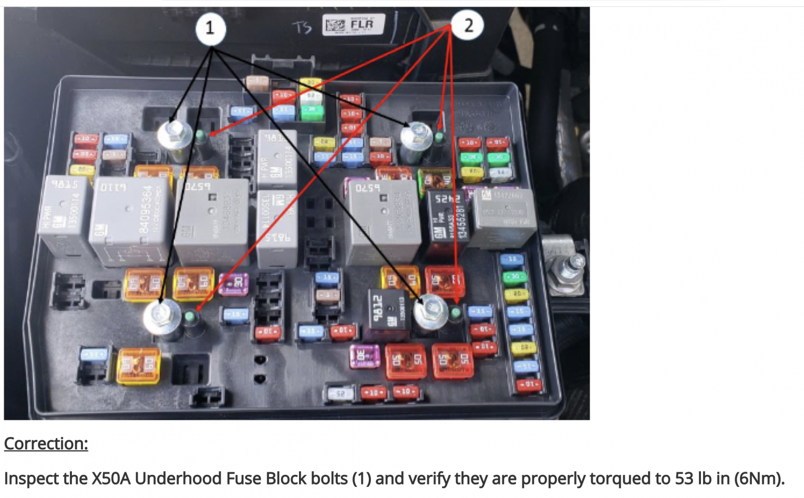

You may also want to check the 4 bolts holding the under hood fuse box together. The early T1 trucks/SUVs had loose bolts that caused all kinds of weird issues. My 21 Silverado had loose bolts and I was getting service 4wd messages. The bolts are tightened to 50 inch-pounds. The 4 bolts are light gay in the pic.
Also the OP should call GMC customer service. That close to the end of the warranty GM/GMC may pay for part of the repair (nothing to loose by calling).

Here is a better pic and it’s 53 inch-pounds.
