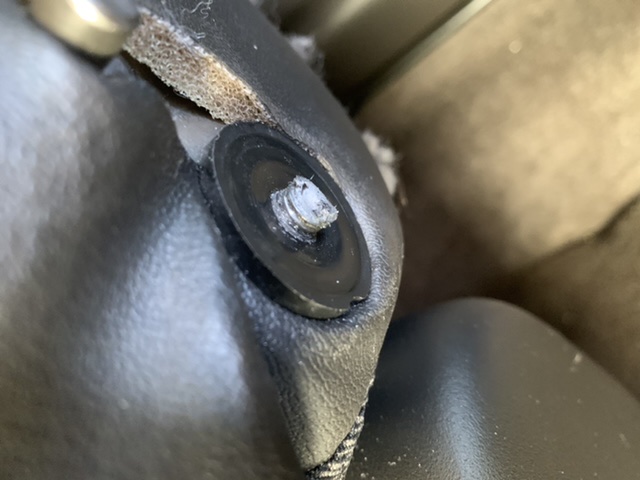

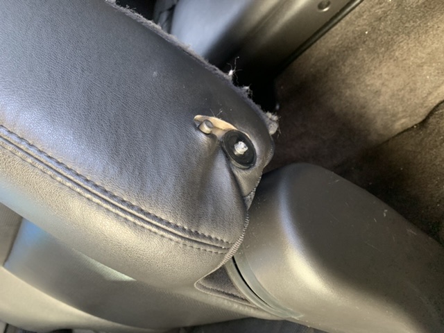

Here’s a couple Picts of the chair and bolt sticking out. I’m assuming this bolt screws in the the chair with standard threading (counter clockwise to remove)? I tried to JB Weld a nut on it then back the bolt out but that didn’t work, JB Weld isn’t strong enough. Thinking I’ll try to drill it now and see if I can get it out with an easy out. Thoughts?

Can you get a pair of vice grips locked on to the exposed portion and see if you can get it out that way?
If you drill it out, might try and find some left hand twist bits. They work well as they try and loosen the bolt as it grabs.

Good ideas. I’m not familiar with “code grips”. Same as vice grips?

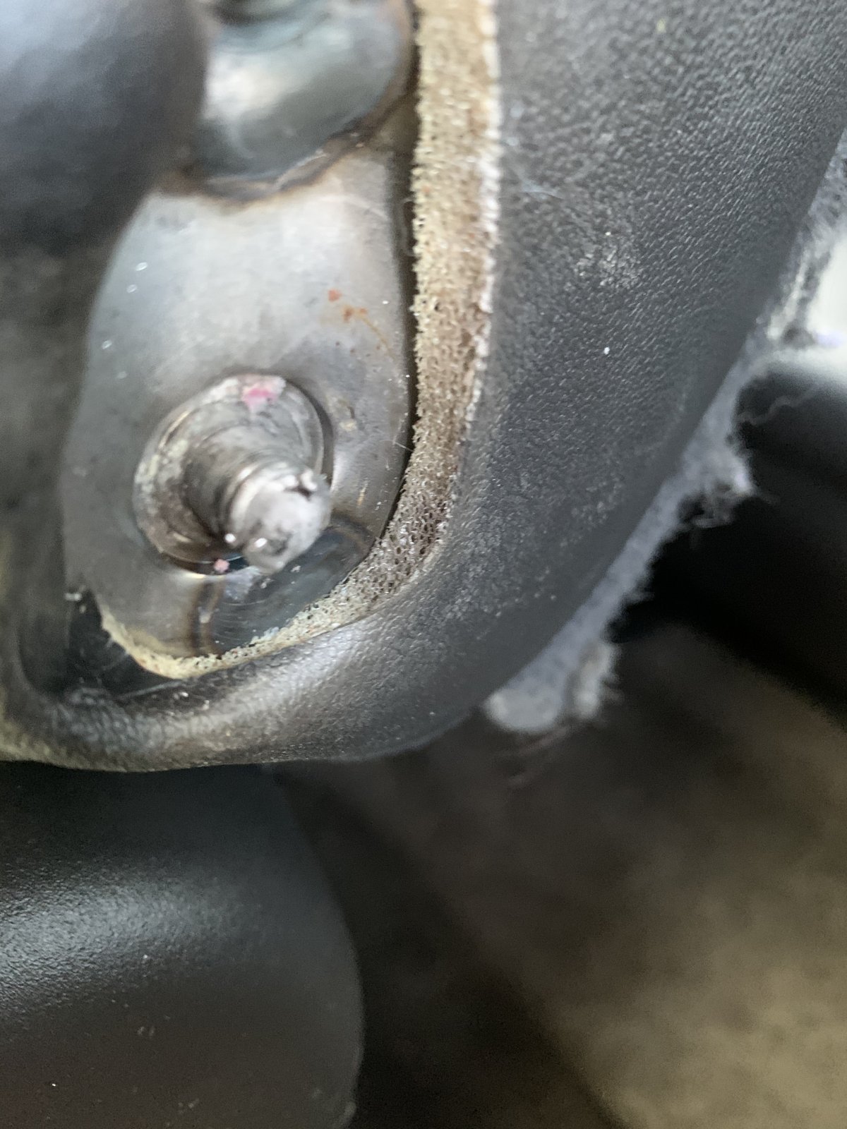

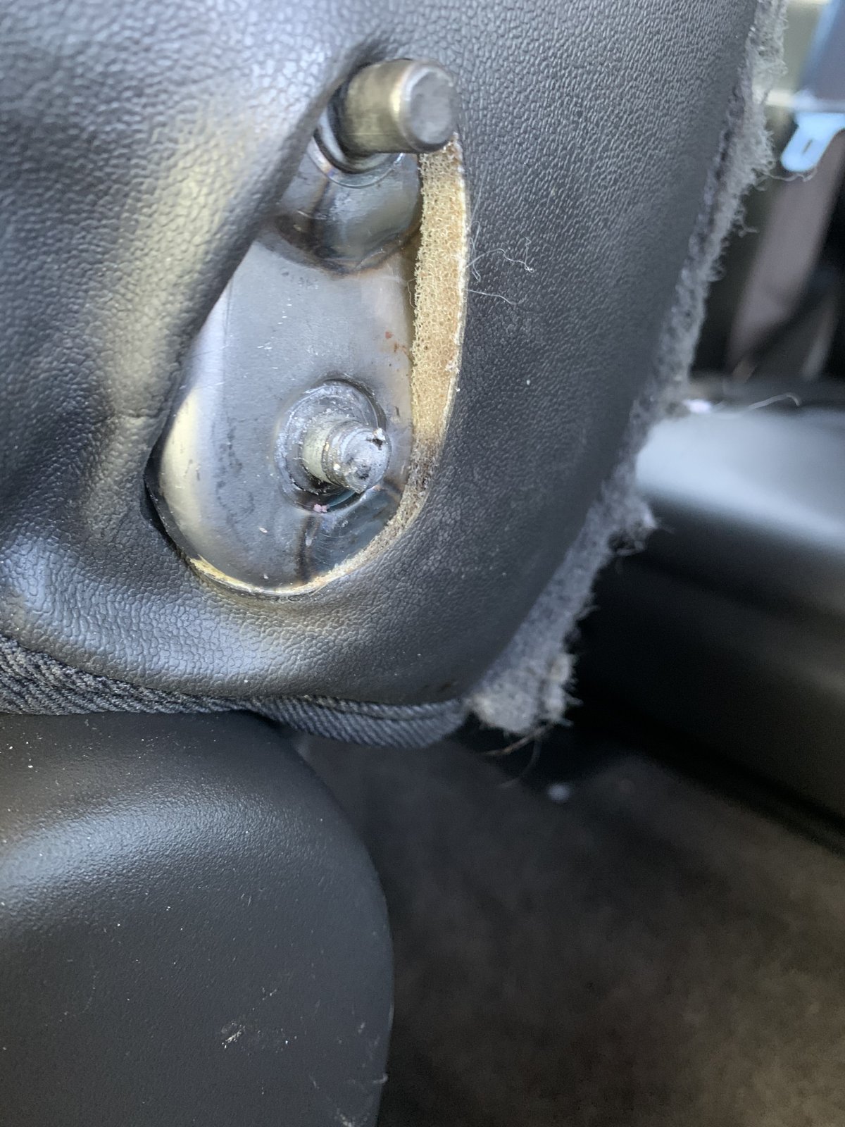

So, I exposed it further and it looks to me like this is a welded post that would hold the arm on the chair?

Well, it’s good to have friends that are welders. The bolt doesn’t unscrew so we welded the bolt back together. A little more slop in the armrest now but functional and seems to be strong enough (until the next 160 pound kid decided to step on it. Thanks everyone
