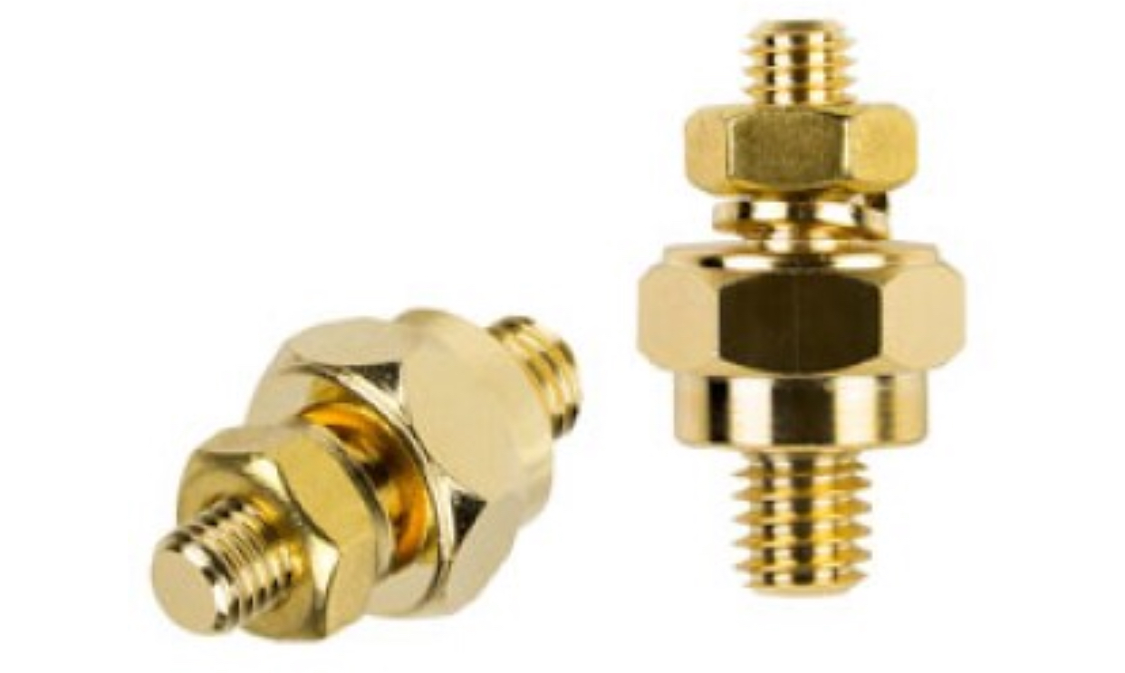

For those using an isolator, how did you connect the larger gauge wire (in my case 2 gauge) to the main battery that is side post? I know the top posts have those nice adapters that split off nicely but I'm having trouble finding something like that for side post.
Yeah, you can buy side post extenders are pretty good. I put those on first and those alone helped my truck start right up. I went from a 2 second crank to a 1/4 second crank. Theres always plenty of different options on ebay or amazon if you just search "side post battery terminals" I think they both have a section, if you are adding a few wires, and need more room.
Not sure if that's enough for you; When I put a large setup stereo in my pickup, I ended up getting a pair of these.
https://www.ebay.com/sch/50549/i.ht...r+audio&LH_TitleDesc=0&_sop=16&LH_TitleDesc=0
(they have a website, but its easier to go off ebay). I bought the smaller ones, but they are heavy and I didn't like them. They just wouldn't stay tight with how I drive because they are weighted off to the side. I found a boat company out of FL, that makes their own brand, almost identical but they made the battery post in the center so its balanced. I did a quick search and couldn't find them, but I will look a little more if someone is really interested. You can always just buy the raw squared out copper and use a drill press and a tap to make your own.
