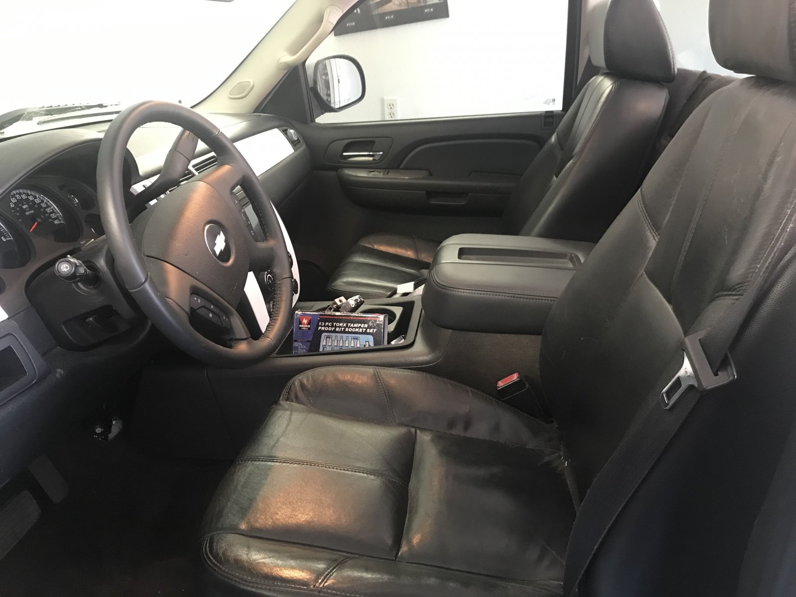

I have a 2010 Tahoe PPV and bought some seats off of eBay that came out of a 2013 Escalade.
Here's my issue... The power connector on my truck is maybe 1-1/2" wide and the seats have a connector about 3-1/2"-4" wide. Does anyone offer a adapter to get from A to B?

You will need the original seat wiring harness from the Escalade, thats the one you would cut from the floor, but giving you enough wire. I don’t know if the 2010 has the airbags in the seats... I do know the 2011+ does. Don’t know if you will receive air bag light on the dash
I just did this with my Tahoe. Find the original adapter that gets cut from the floor and plug into your matching harness. Then you cut your harness thats at the floor (leaving enough length) and match up the colors via soldiering. There will be left over wires from the Escalade seat harness. Here is a good video that I used
