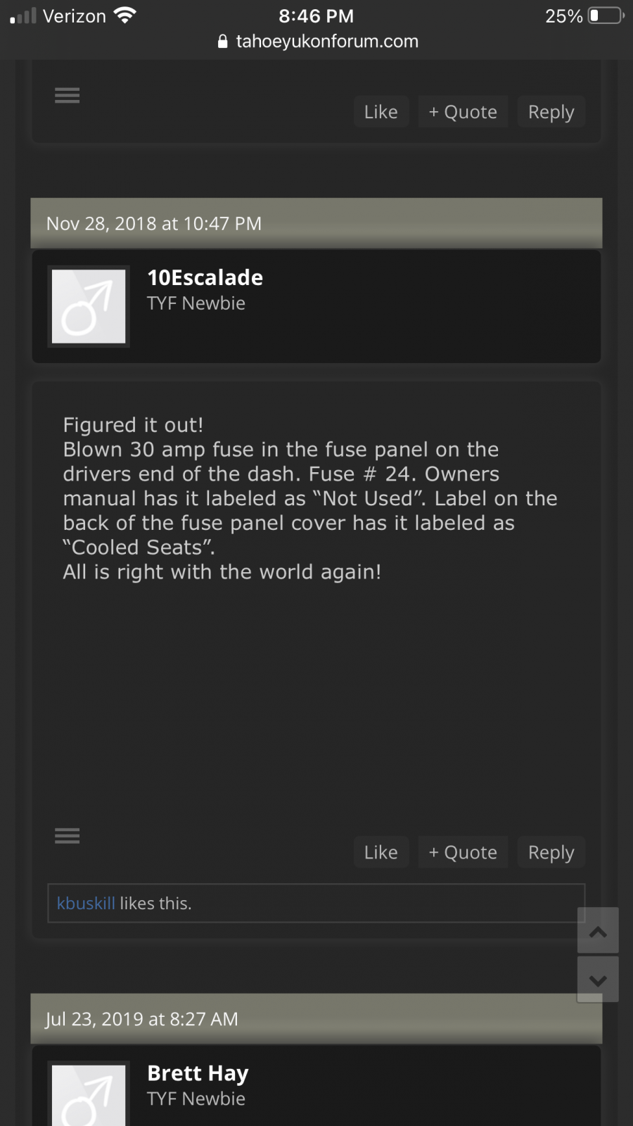

This thread is very detailed:
https://www.tahoeyukonforum.com/threads/escalade-heated-cooled-seat-fix.78105/
also this post from another thread talked about replacing either a fuse in the driver side interior fuse panel. You might want to check that out too.

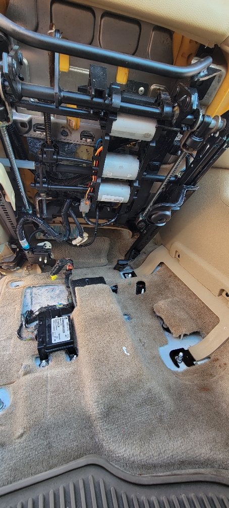

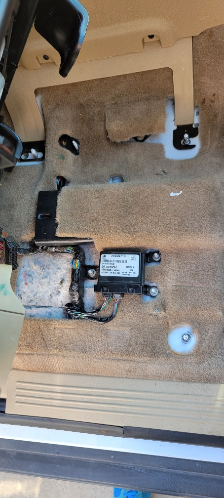

Bad news. No module. Fuse 24 is good. Perhaps the module is only on heated/cooled seats where I only have heated. Took passenger seat out and only found two modules on the floor, which appear to be park assist (first 3 pics). Tried disconnecting heating elements one by one (top then bottom) and activating the switch to see if any would work on passenger side but no luck. Again tested elements for continuity and all was fine. When activating the heating seat switch, heard relay click from under the driver side and took that seat out. Found seat module (last pic) and checked all pins and all were fine. WTF! I guess my next step of to take out door switch.
Edit: No codes on Tech2.
Edit 2: All of a sudden all started working. Gremlins! I wonder if it lasts. If it continues to work, I suspect the final solution was bad cable seating at seat relay module under driver seat (last picture).
