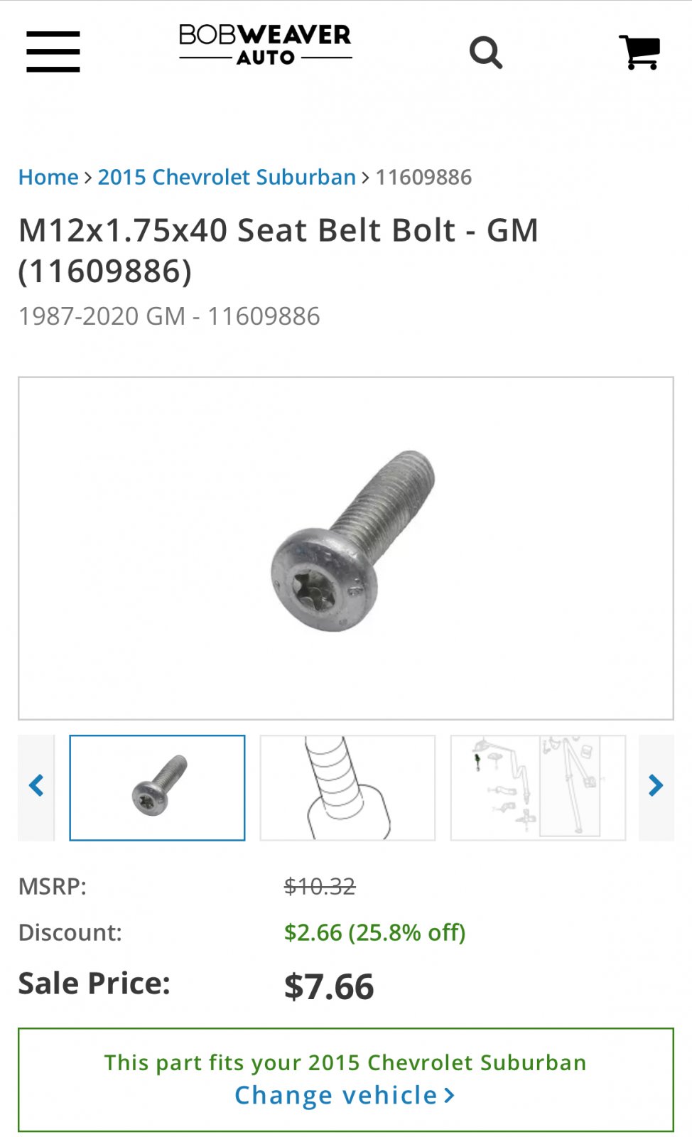

Is this the part?
My guess is that it should be 33 in/lbs.
It is only an M12 bolt.

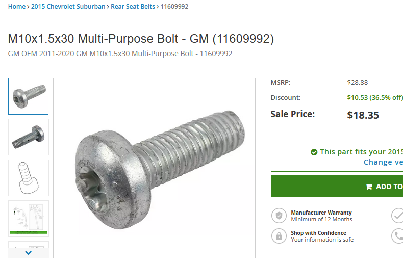

Measure the thread pitch, diameter, and the length to see what's what. Is the bolt fully threaded, or is there an unthreaded shoulder under the head?
Here's a possibility, but 30mm seems a bit long from what I can see of your bolt:
Might need to see the dealer for their detailed diagrams and part number.

Nope, not it. Yours and the one dps01 posted are a bit long. It's fully threaded and only 9/16 inch long. I'll just swing by the dealership tomorrow and see what they say.

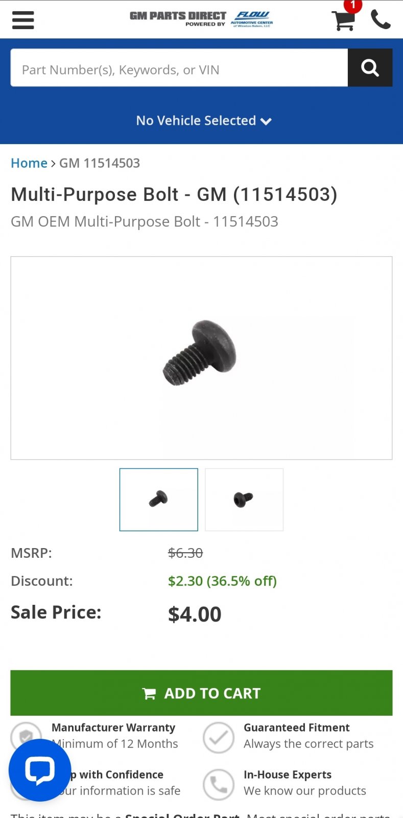

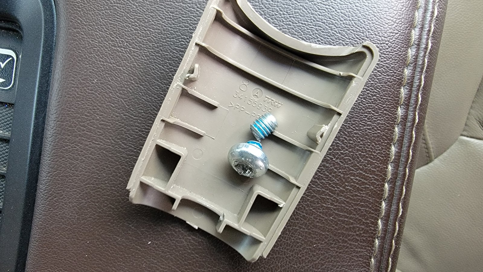

Ok guys, I know yall are dying to know the outcome
So the dealership found the part and we discovered it was a discontinued part.
Part #11514503. We couldn't find it anywhere. Even the parts websites couldn't get them.
So I found bolts of the same dimensions on Amazon.
The bolt was an M6 x 1/2". So I found some M6 1.0x12mm with a torx head.
A little dab of blue thread lock and it fit like a charm.
And on another note, I found universal torque specs for bolts and an M6 8.8 class is rated at 7.3 ft lbs. So yeah, 33 was a tad too much

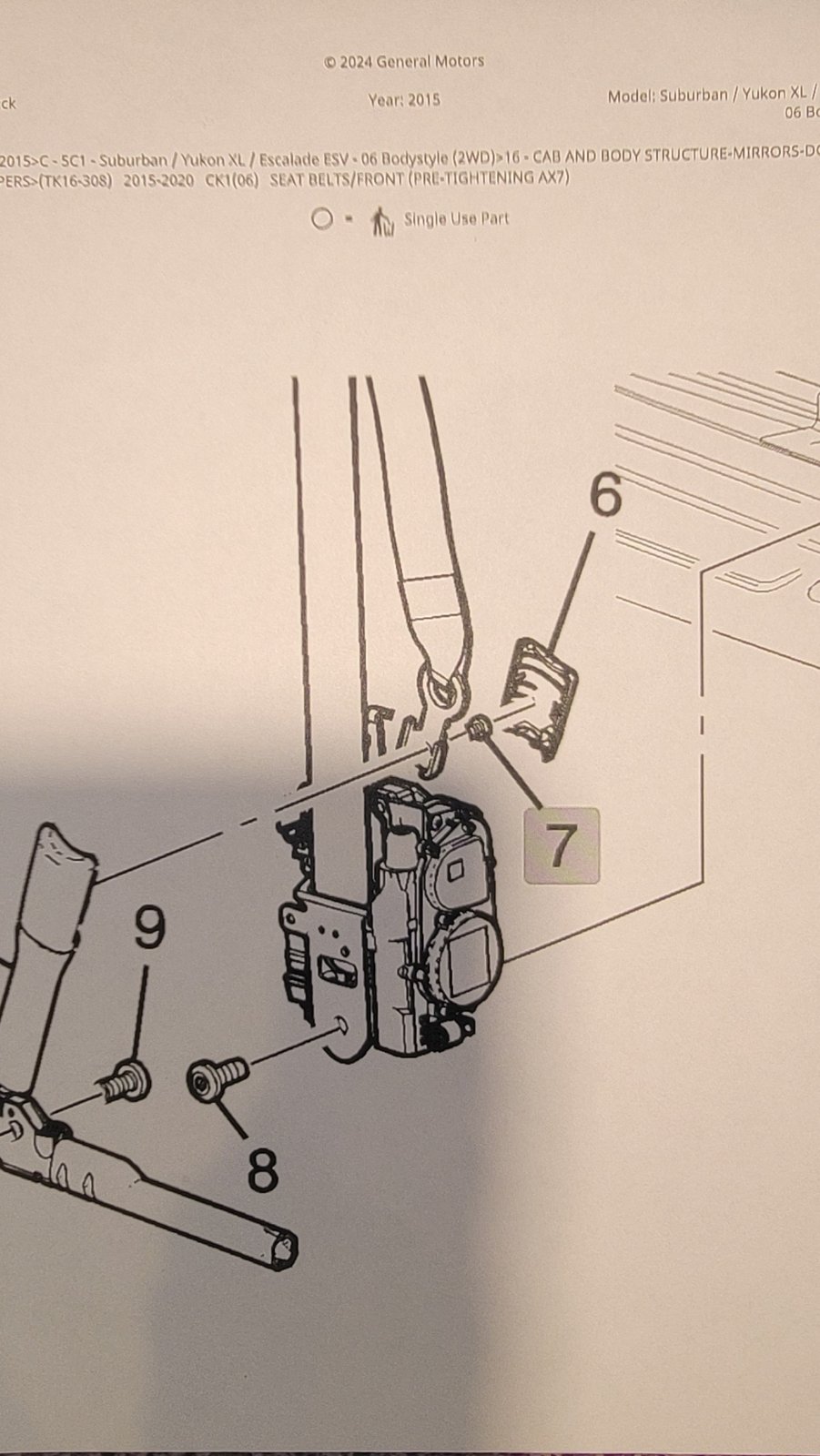

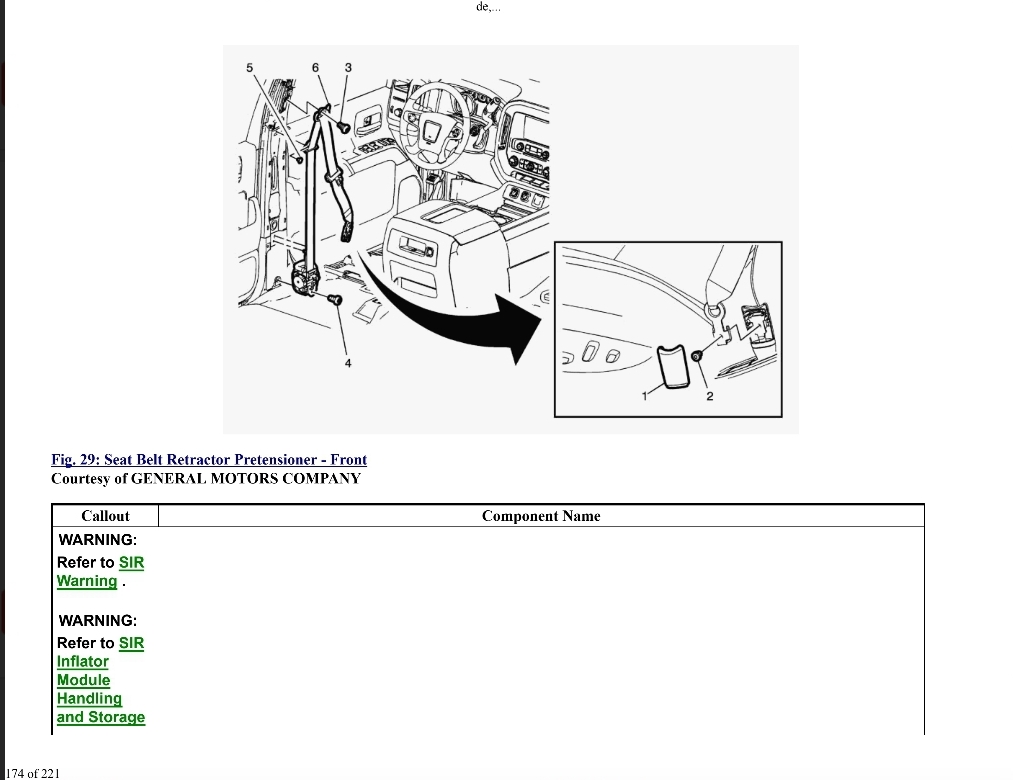

For the big, main bolts yeah. The belt and pretensioner are connected by two interlocking plates. This bolt just prevents those plates from sliding and coming unlocked. I just found a service manual from another member and it shows 44 in/lbs.
Thanks for everyone's input!
