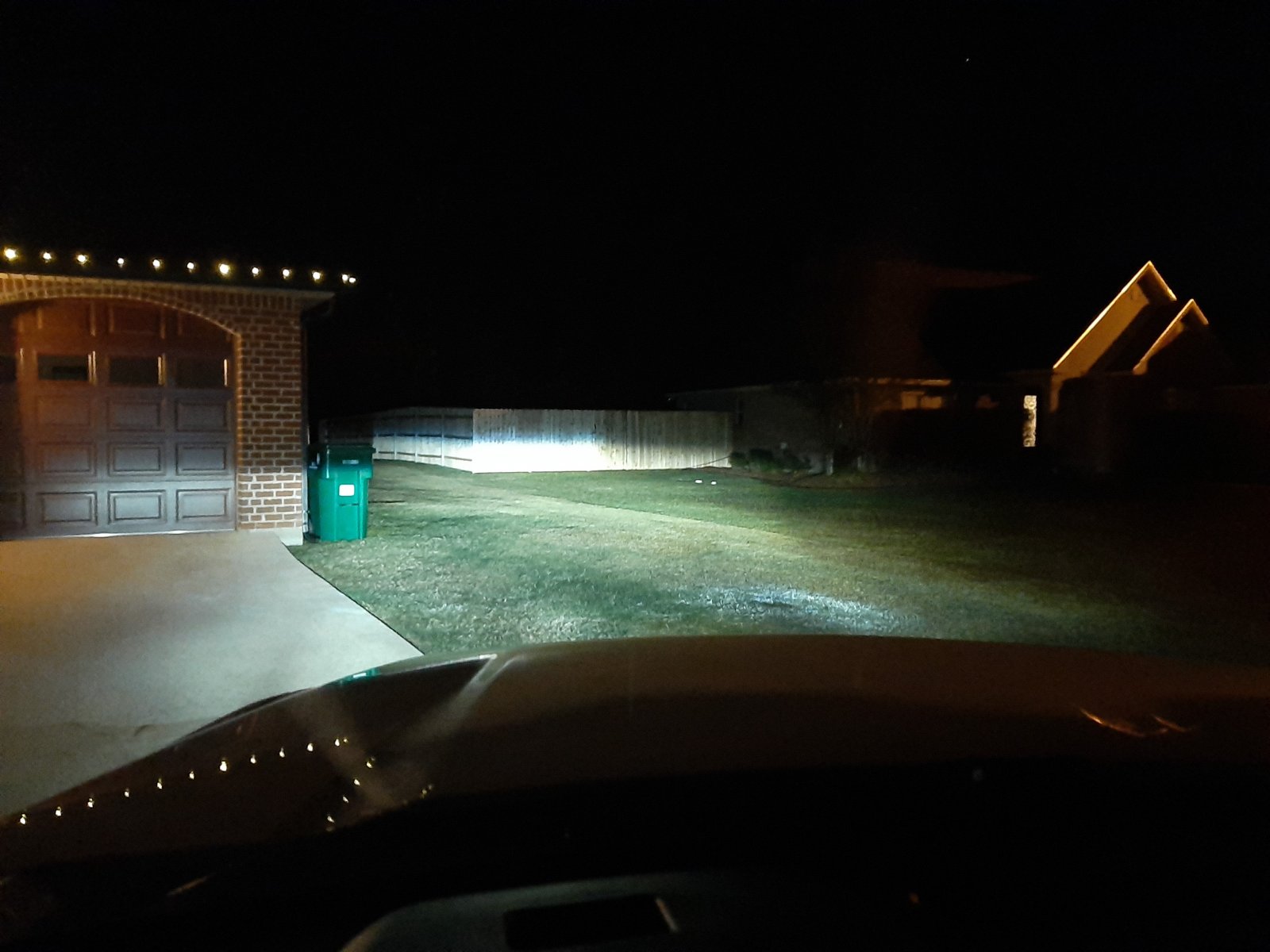

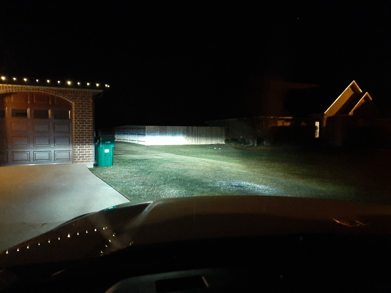

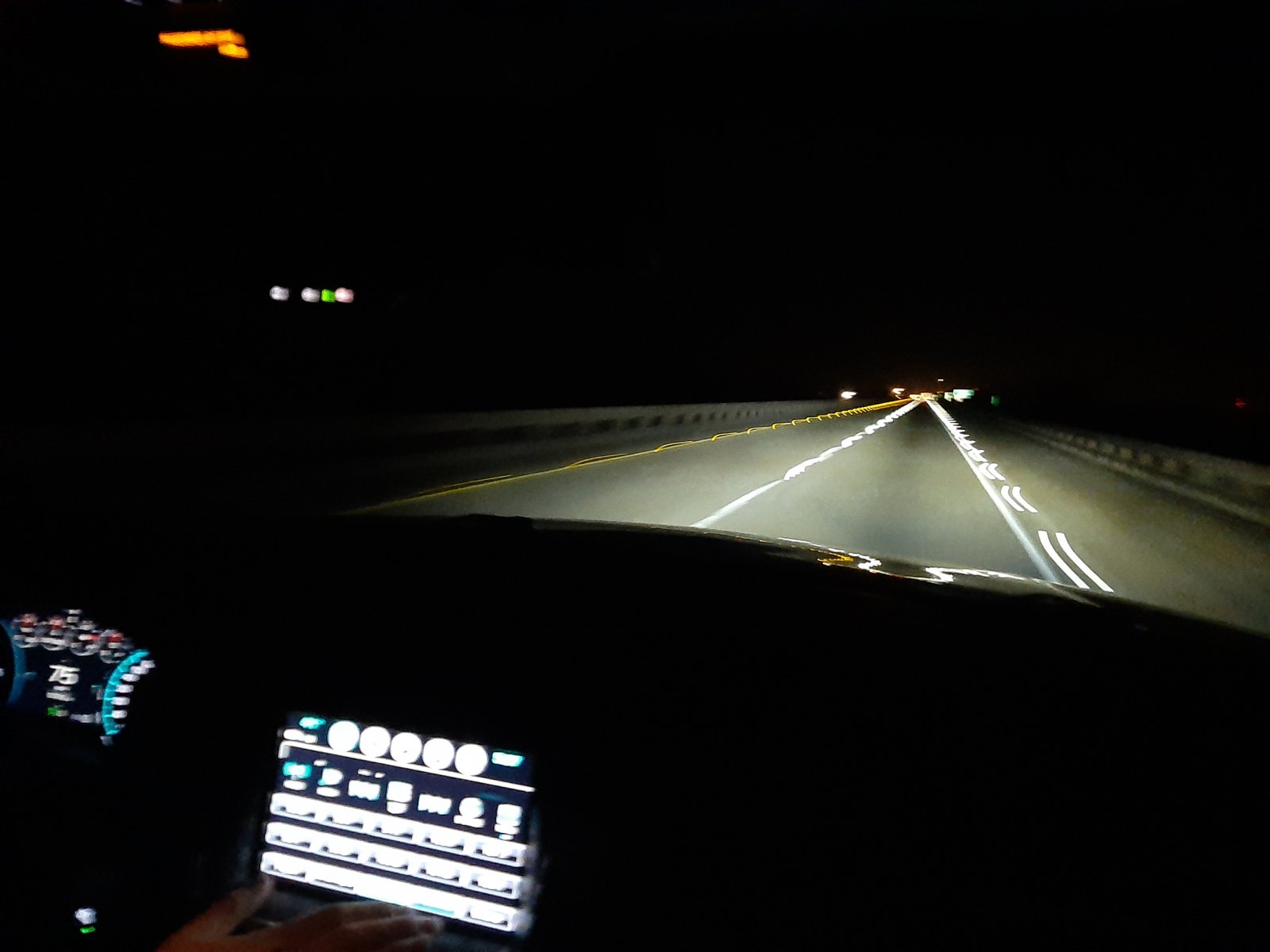

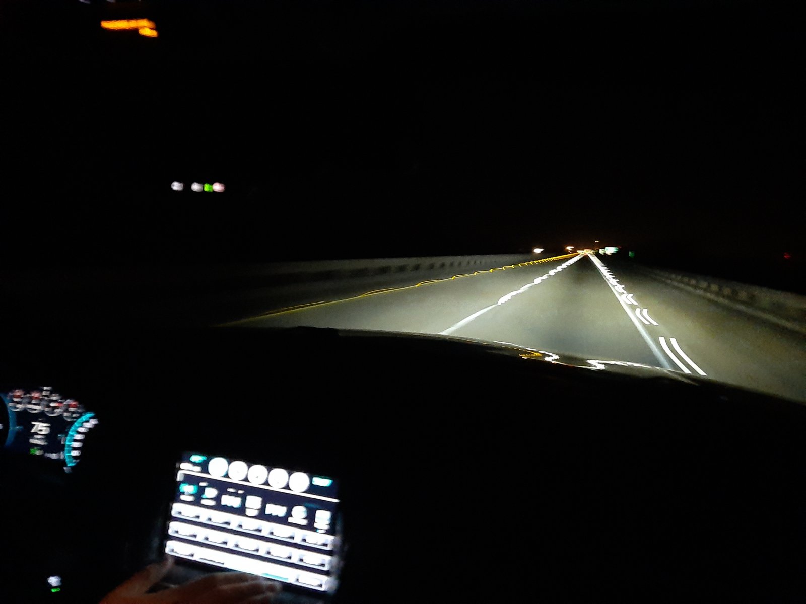

personally, other than appearance, you will get better performance form the OE housing...just doing the bulbs is great for output, but does retain stock appearance.
this is a morimoto 2 stroke 3.0, one sitting showing cutoff at 75ft ish, the other rolling at 70-75 mph.
View attachment 273750 View attachment 273751
Those are your low beams in the projector housing? Man I really love the look of the Spyder assemblies but I also don’t want to waste a bunch of money.
What mad you go LED over HID? I know the HID set up is more complicated but I’ve read they are better for projector lenses.
Yes, low bean in a stock Halogen projector housing.
i have done HID in the past, this time i decided to go PLUG AND PLAY, which these are. i could not be happier (other than stock fogs are garbage now)
this LED design positions the LED filament in the same location as the stock filamnet making the reflector / projector work as it should, rather than the HID world blinding on coming drives with scattered light. the HID needs a projector, where as in other vehicles, the correct LED should not.
