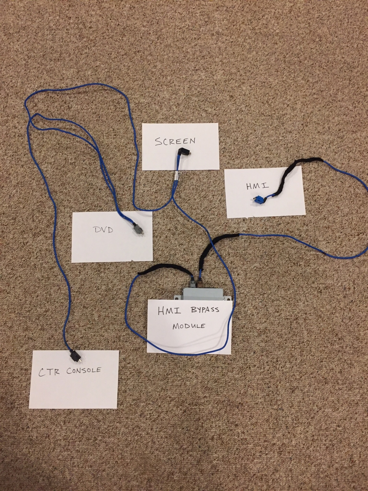

I found you guys because I stumbled onto this thread: https://www.tahoeyukonforum.com/threads/upgrade-16-denali-to-hdmi-input-from-17-models.86695/page-8
And specifically this picture:
So I would love to check the cable at the HMI bypass module but I cannot for the life of me figure out where that is. Any suggestions?

And specifically this picture: View attachment 430754
in most cases flickering is likely to be the lcd panel it's self. the only way to verify would be to plug it into another vehicle.
you could try dissasembling the lcd and see if the flat copper color connector has worked it's way loose. it can be replaced and that would be my first choice and cheapest in the parts cannon department.
