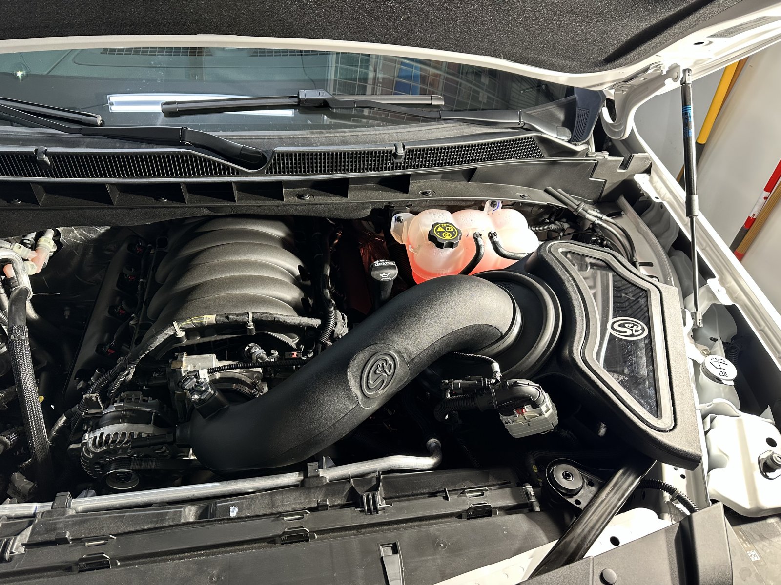

Well she fit. Got up to 19.4 mpg on a short trip to Costco. Only broke two clips, and the '23 doesn't have the extra support arm to remove.
It does sound way louder when you get on the gas, even my wife noticed.

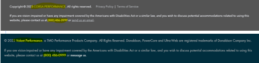

Looks to be one in the same; Volant is most likely the child company both owned by TMG Performance Products Company.
The Volant is about $40 cheaper. I'll be changing the plexi window anyhow..so the $40 Corsa sticker is not needed lol.

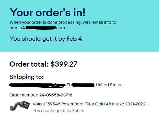

Well I canceled my Volant order after informing me there was an 8 week lead time....inline with Corsa. Apparently they (maybe) only drop ship (this seller on eBay), so I opted for the S&B intake which was delivered yesterday and will be installed tomorrow morning.

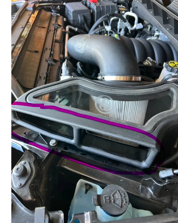

So I was getting a CEL and after many days (and new MAF) at the dealership they suggested I get my stock air box back on to see if the CEL returned. After having it installed for over 2 years apparently the S&B intake was causing the CEL after a GMC update. So I rode around on the stock air box for better than 3 weeks and no CEL. Last night I reached out to S&B and they had me snap a pic of my air tube. It was an older version that apparently on the newer version the MAF is located in a different location. They are now sending me the revised version. For reference, here is my "old" tube that needs to be swapped out.
A+ for a great company doing the right thing even 2+ years after said purchase.
