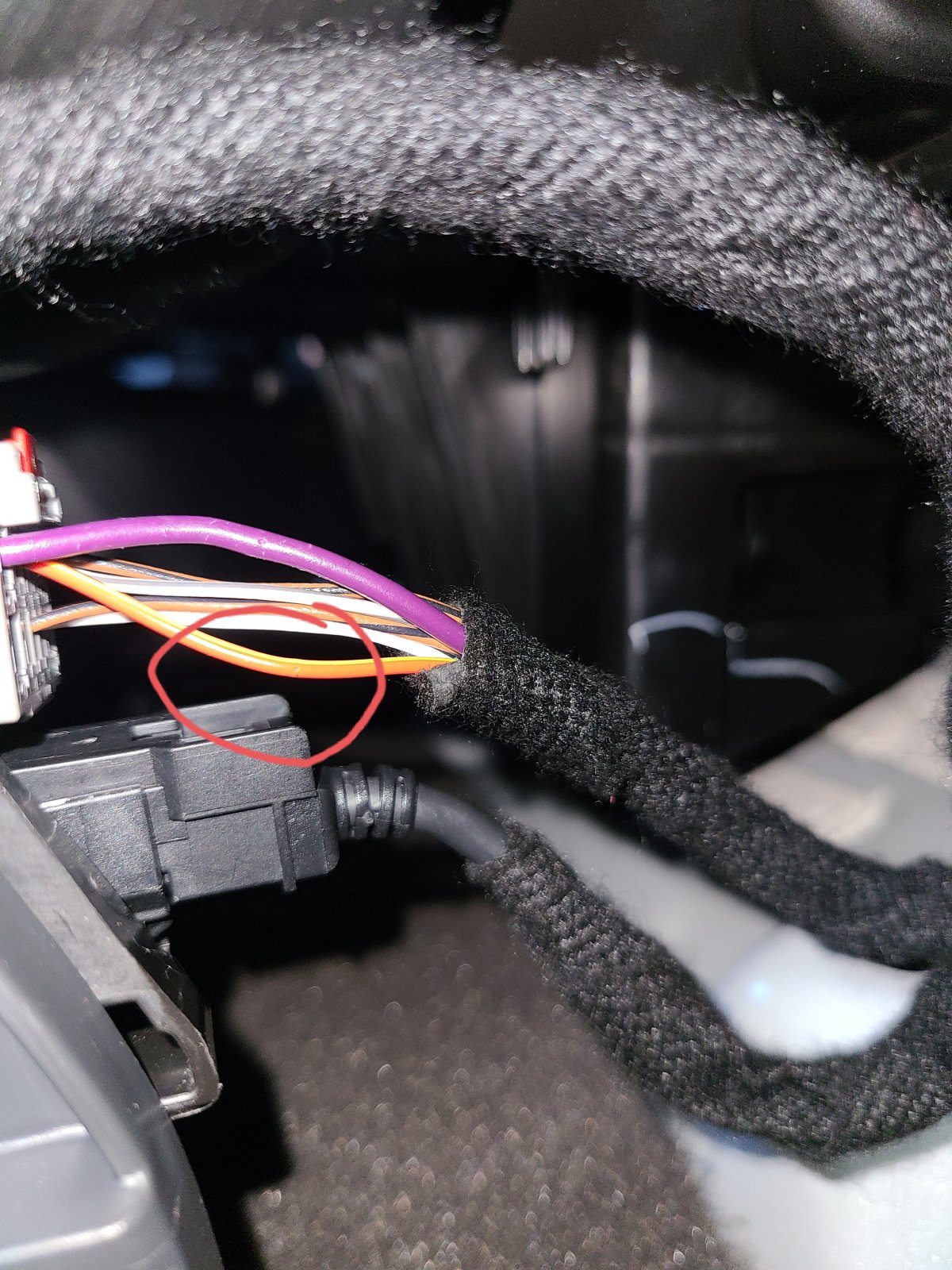

Pull the panel off on the passenger tunnel (pulls straight off). Right under the dash, there is a bundle of wires. The orange/yellow is always hot. I wired a 12V cig lighter to it so I can use my quick charger for my phone. Works well so far and I don't think it cycles with the auto stop.
