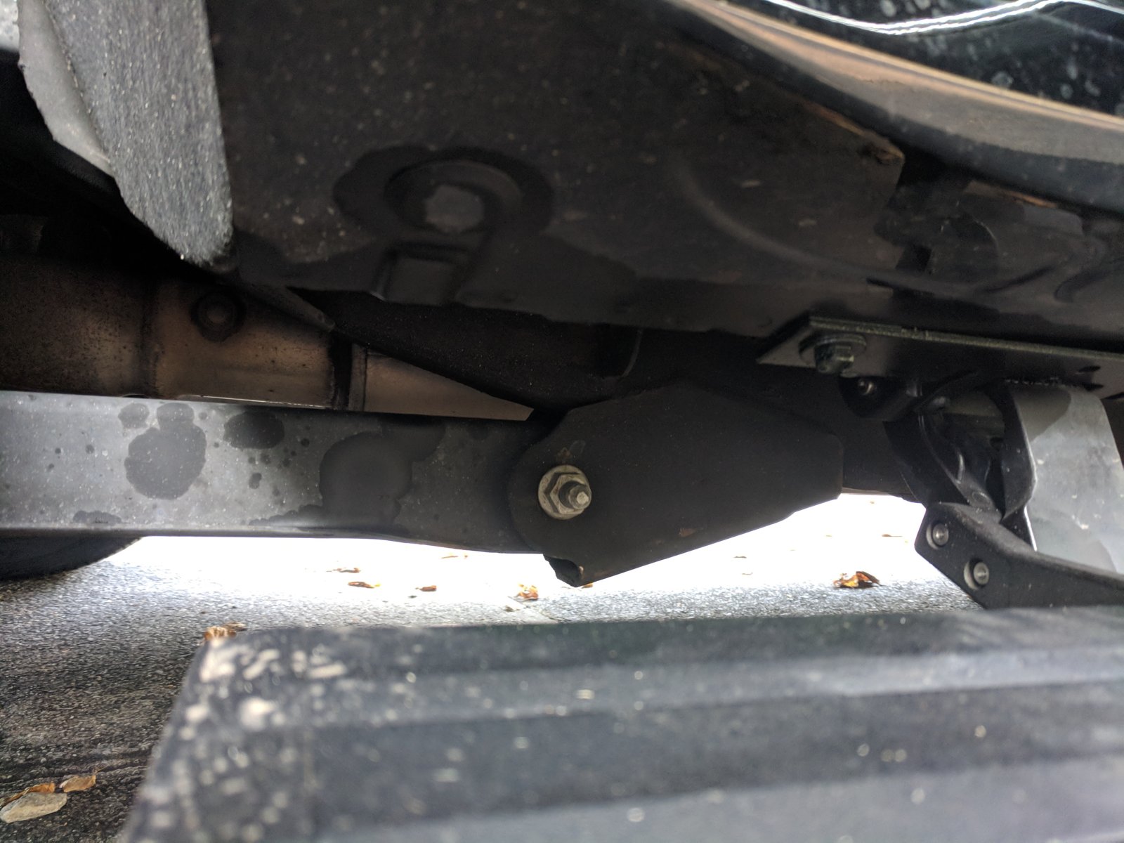

Hello. Passenger running board retracted then dropped. Happened sporadically thru the day today. I leaned down to check it out. Green fluid leaking by the rear hinge. Buttttt these things are electric though, right?!
I'm running errands and can't really get under it for a while till I get home and it might be too dark then, so figured I'd ask here what that might be.
Any help appreciated. Tks
Clarifying.. It didn't drop like gravity, freely. It dropped motorized, as though it hit an obstacle... which it isn't.

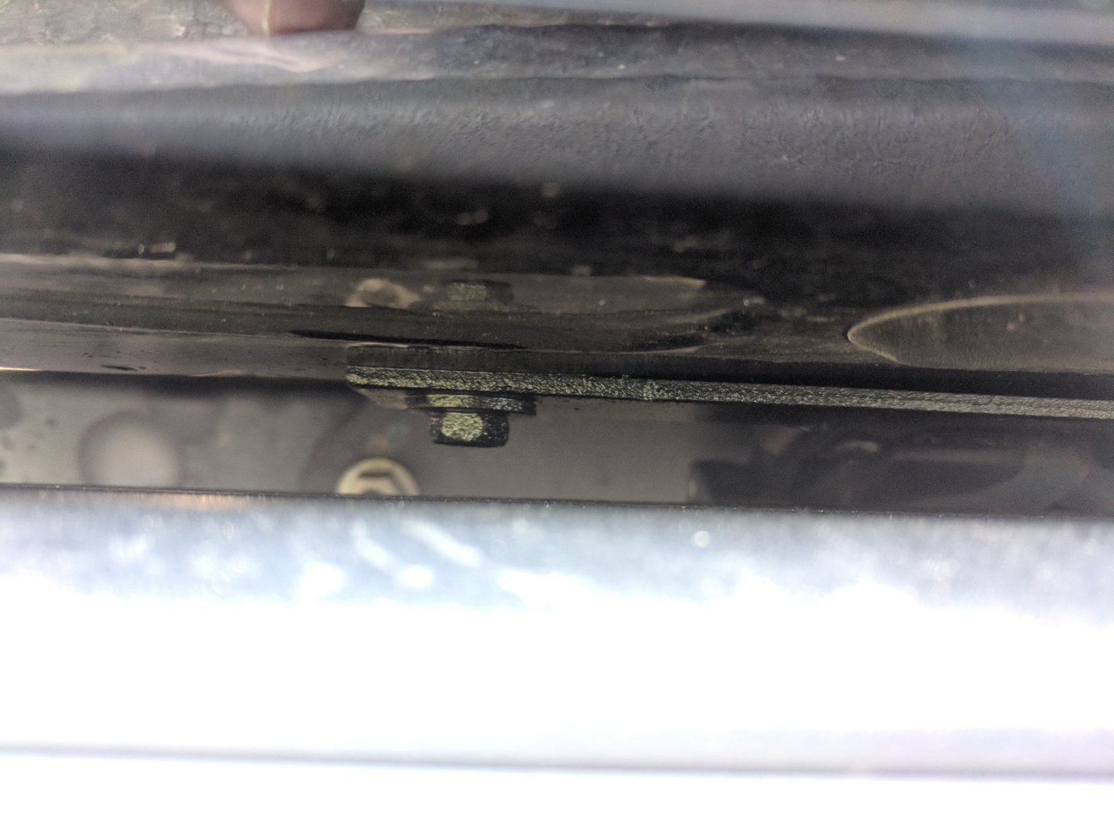

Stock coolant. Greenish yellow fluid at the rear hinge, but only traces. Also looks like it splashed on the frame a bit. The dark areas are wet from what appears to be that liquid. Second pic shows the bolt, but the greenish hue from the fluid on it doesn’t show well in the pic.
No wet spot under it, and nothing near the center seems wet as best I can see. Still not in a position to really get under it...
