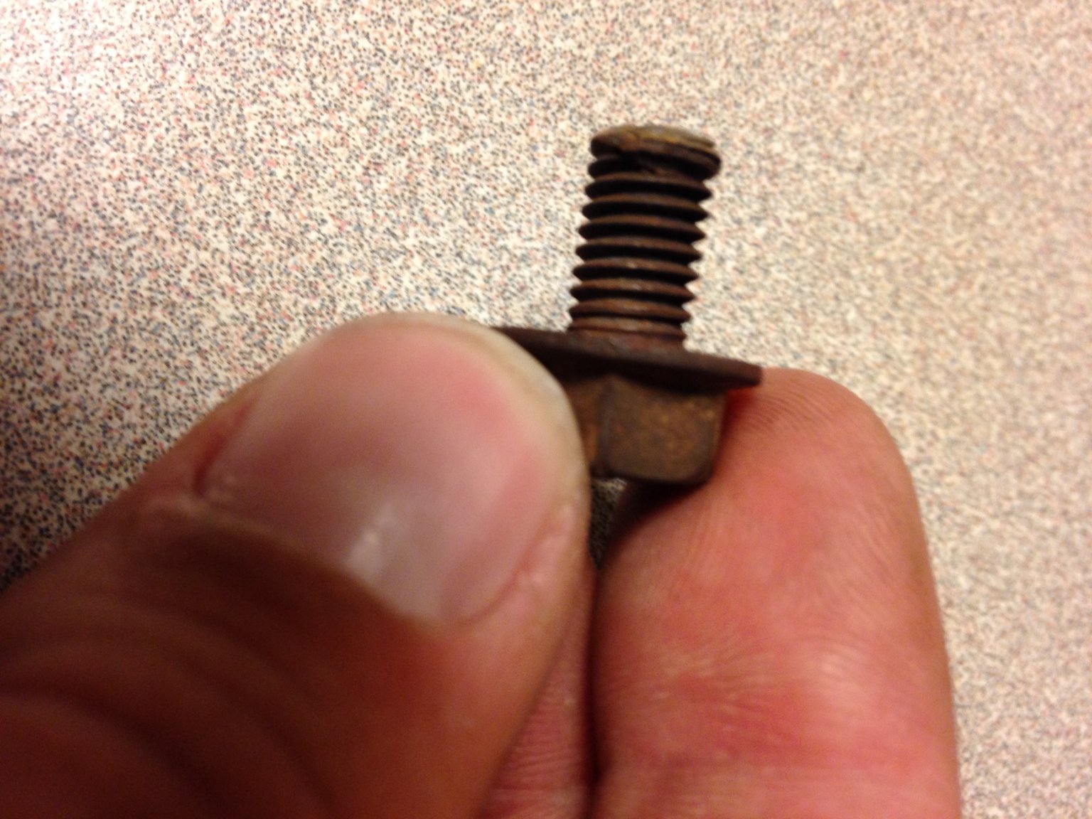

So got to looking for any type of vacuum leak and nothing, used carb cleaner all over and still nothing. Did notice this... Was able to pull it out and was not enough threads to screw back in. Cleaned throttle body and hardly anything.. Don't think this rear driver side manifold bolt had anything to do with the problem, so guess I'll keep looking. Hopefully the manifold holds tight cause there is no leak yet!

At some point you will probably want to replace that broken exhaust manifold bolt. It is not easy to remove the broken end of the bolt from the head (right angle drill motor, short bits, easy out etc.)
