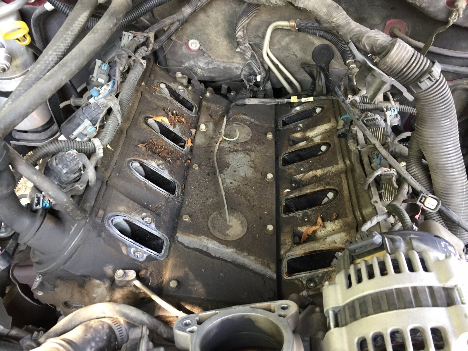

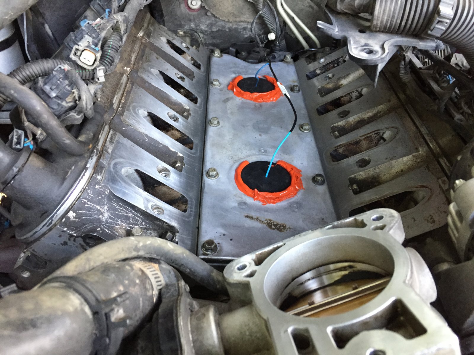

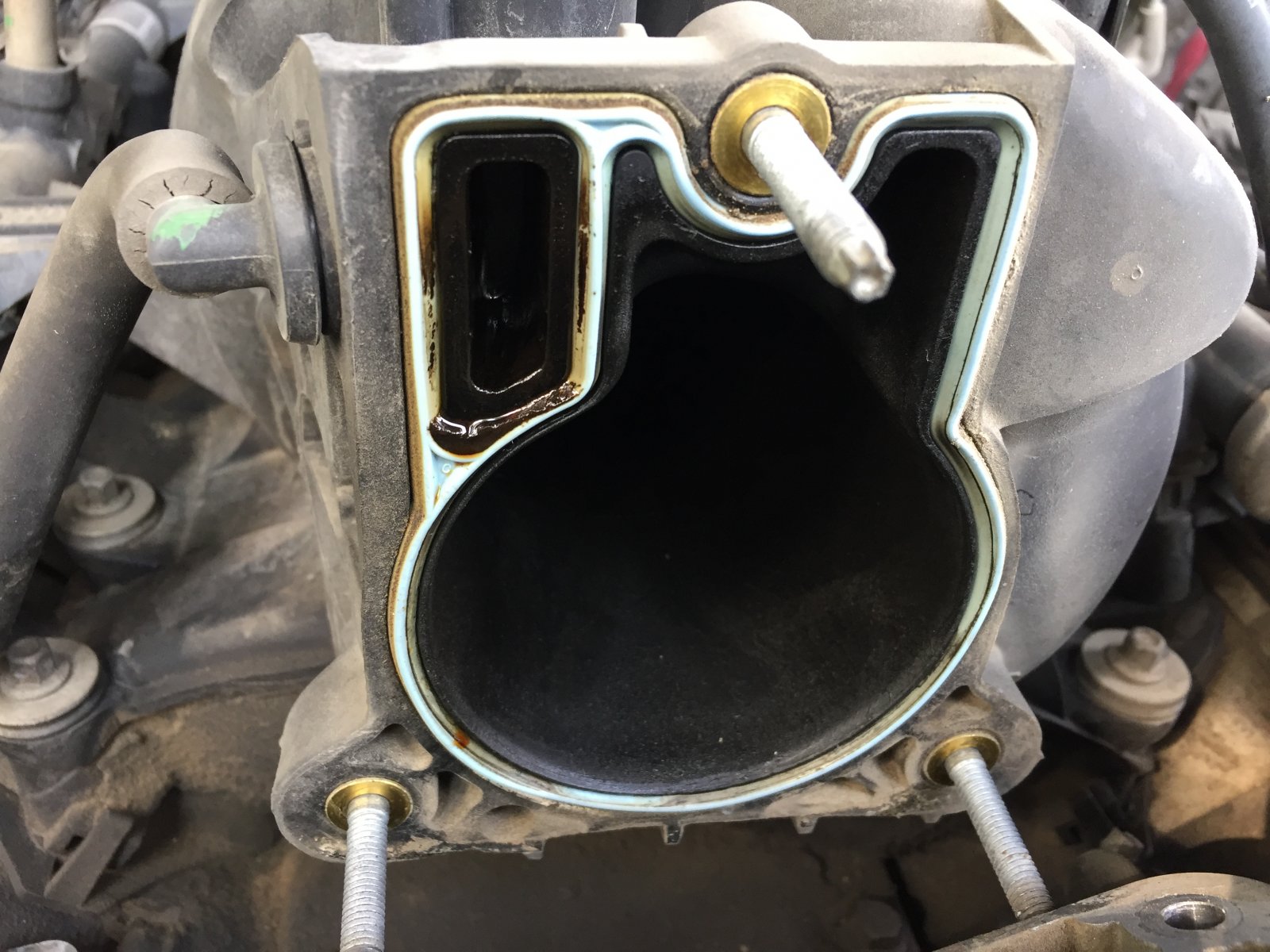

Actually... Now I think about it, I did have the throttle body off about 2 years ago while I was working on the old engine. I managed to take some photos of the back side of the throttle body too. In the last photo you can see how much I cleaned it up but I didn't get everything because I didn't want to screw it up. I didn't open the butterfly. Do you think it looks bad?
20180908_180450917_iOS.jpg 20180908_184506865_iOS.jpg 20180908_235618596_iOS.jpg

its dirty in the pics there, and that was 2 years ago, so its more dirty now.
but thats not the cause if the flashing cel. thats gonna cause hard starts poor idle.
