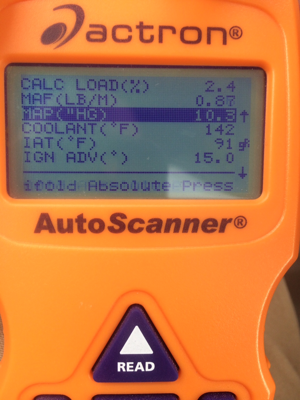

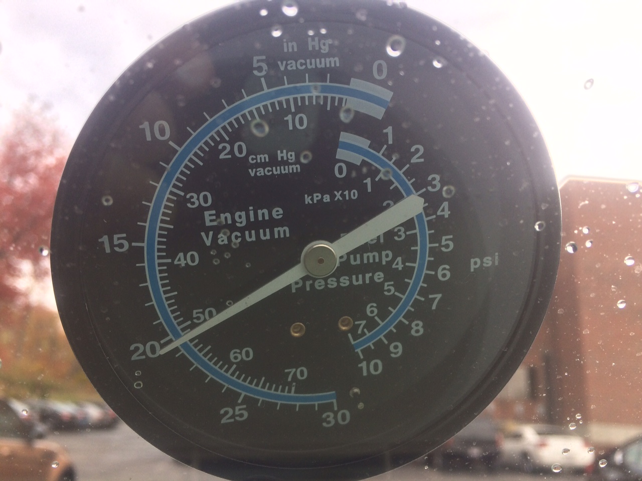

I bought a vacuum pressure gauge after reading thru my Haynes manual. Hooked it up in-line with the brake booster vacuum line. Healthy engine vacuum is between 17-22 inches of Mg (Mercury). The gauge indicted 20 inches with little to no fluctuation at idle (Less than 1/2 an inch). A quick hit of the throttle to 2,500 rpm and vacuum went to 0 (expected) then spiked to 25 inches and back to normal idle pressure within a second or so (Normal operation following hit of the throttle as indicted by Haynes manual). This seems to rule out a vacuum leak, bad valve, rings, plugged exhaust, etc.
I have an actron diagnostic scan tool. According to the scan tool my idle vacuum is between 10 and 12 inches of Mg and my gauge reads 20 inches? Could I have a bad MAP sensor?

Gauge and scan tool readings at idle...
