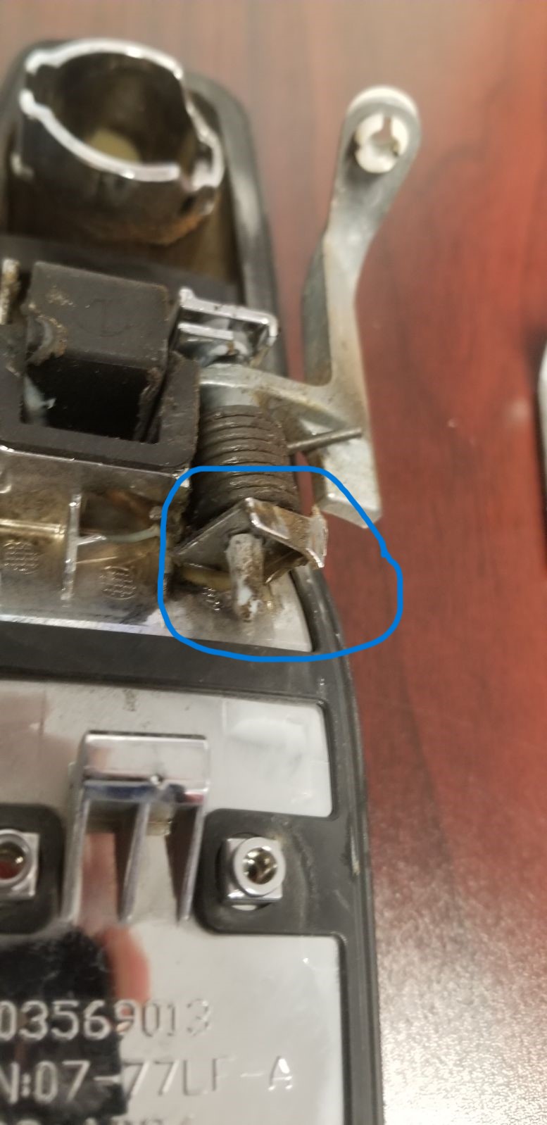

GMT800 handles are stout.
That's funny, my driver's door handle randomly broke about a week ago. The spring-loaded metal lever that sits in the "loop" of the handle that makes it go back into position when you pull it snapped off. It lasted 21 years so no complaints, luckily I snagged a replacement out of one of the parts trucks and it was a 10 minute fix.
