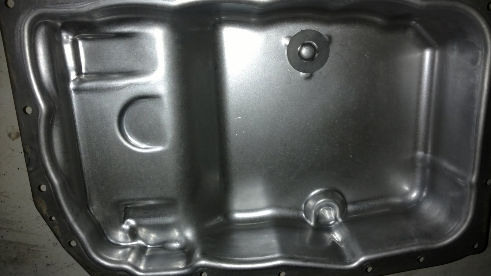

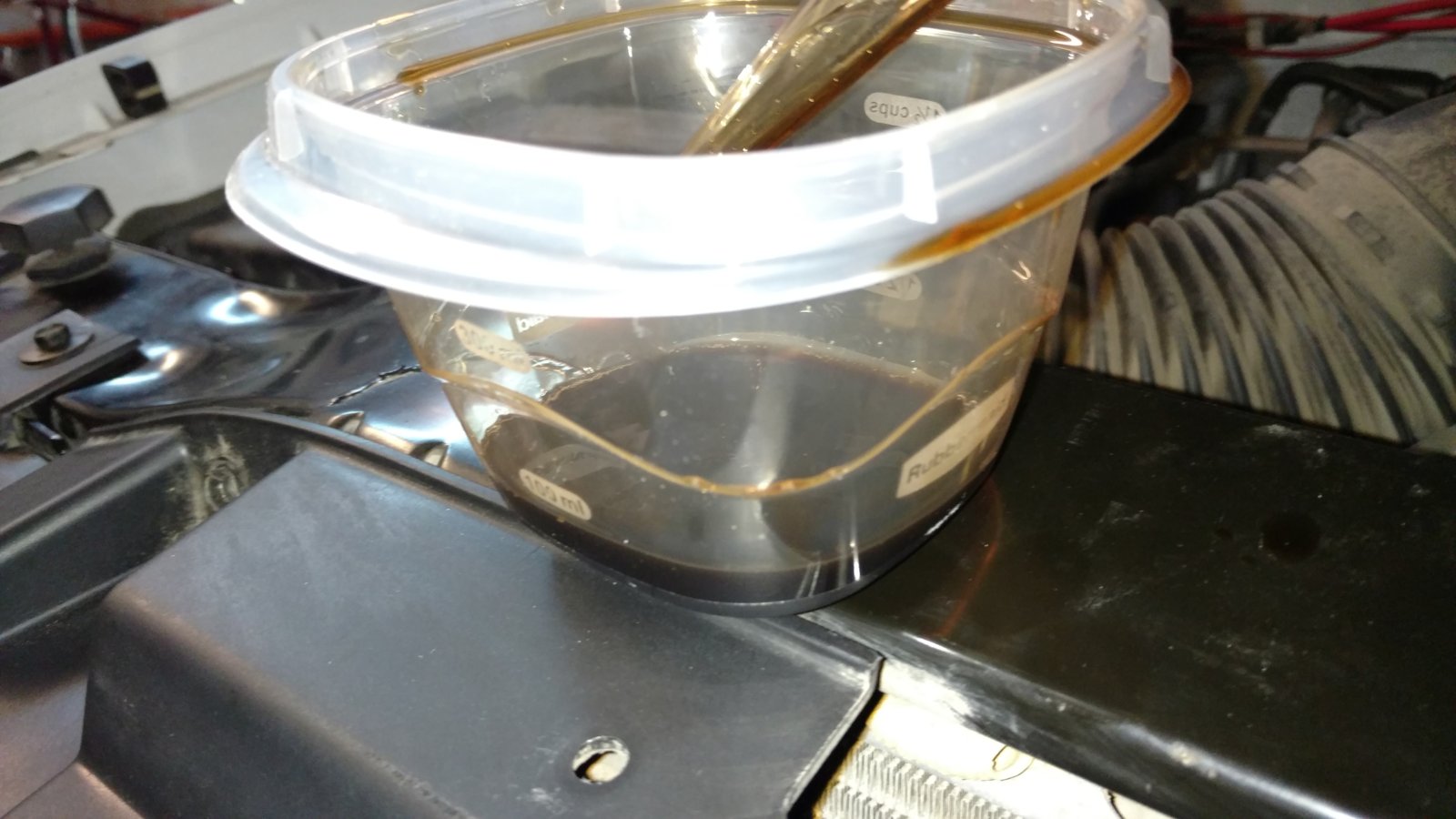

I made some progress today:
1. I filled up the coolant. There does not appear to be any trapped air.
2. After testing, my motor mounts appear to be good. :)
3. Discovered that my HP power steering hose and one of the AT cooler hoses is leaking. I have ordered a new HP power steering hose and will keep an eye on the AT cooler hose.

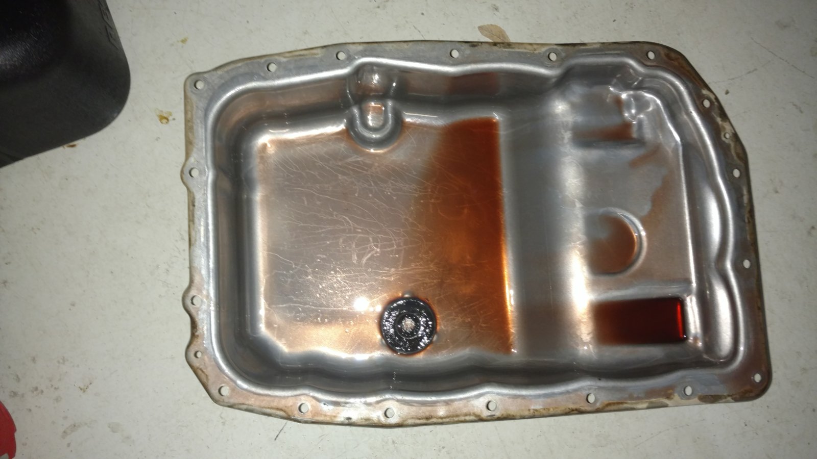

4. Dropped and cleaned my AT pan (see attached). The pan was coated with a thin layer of black grime and the magnet was coated with metal mush. Going to install a new filter and reinstall the pan tomorrow.
5. I am getting a bit of vibration at idle. Since it isn't caused by a bad motor mount, I bet that one of the fuel injectors is dripping. I will probably place an order for a new set of AC Delco fuel injectors. No reason to risk flooding out the oil.
Tomorrow, I will begin work on the suspension! New struts, end links, etc. on the way.

@techbiker The pre-cleaning pictures of your transmission pan are quite good, nothing to worry about with it despite the shavings and grime. The ATF colour would be considered 'normal' for the mileage & age.
Have you replaced that shift linkage bushing yet? Curious about that part as my truck has way higher mileage and I'd like to know if it's worthwhile doing.
As before your notes and pictures are greatly appreciated.

Thanks for the feedback. I hope that people benefit from some of my updates. For a bit of background, I am performing all of this maintenance on jack stands in a garage without much fancy equipment. Let me know if you have any questions.
-I haven't replaced the shift linkage bushing yet. I wanted to get the AT service out of the way first (just in case I have to order more AT fluid). I do feel a bit of play in the old bushing. As long as the job is simple, I would probably go ahead and replace it on a truck with much higher mileage.

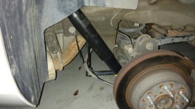

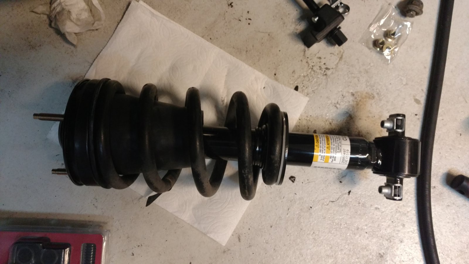

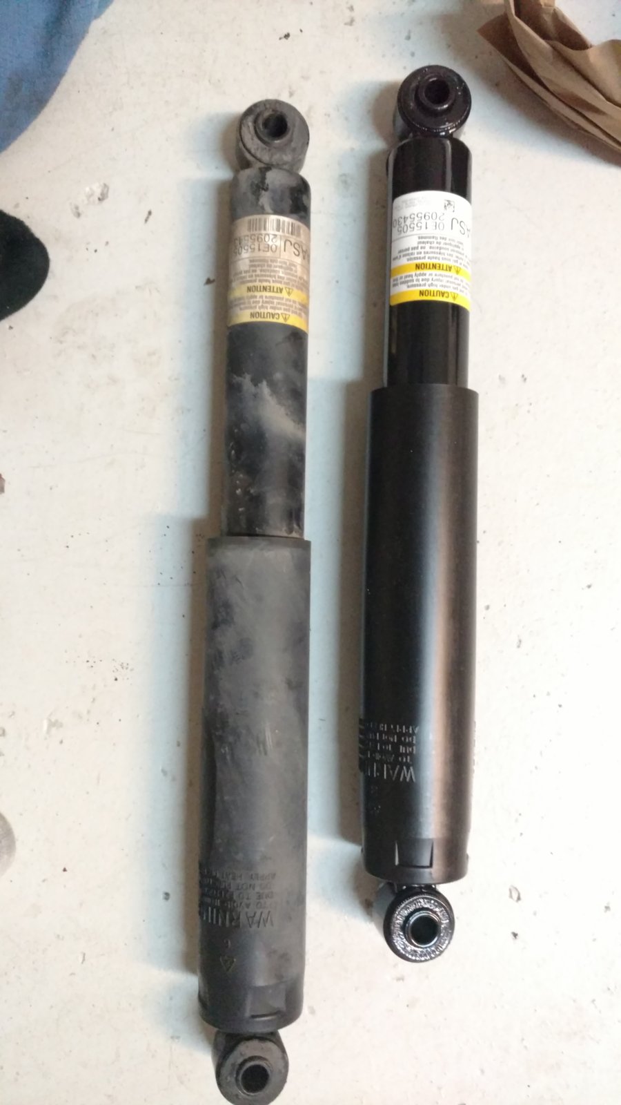

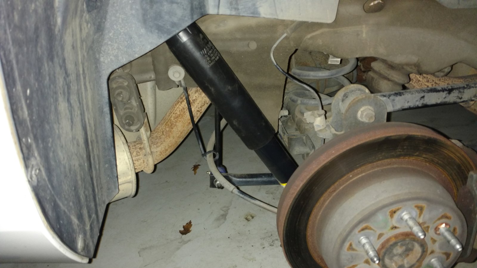

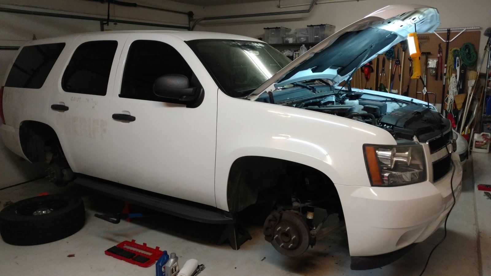

Updates:
Yesterday:
I finished my AT service. I ended up adding 5-3/4 quarts of new fluid. Make sure to check your AT fluid level while the engine is running, even if you are checking the "cold" level. I also could not remove the AT filter seal easily so I left it in when I changed the filter. The filter seemed to seat well.
Today:

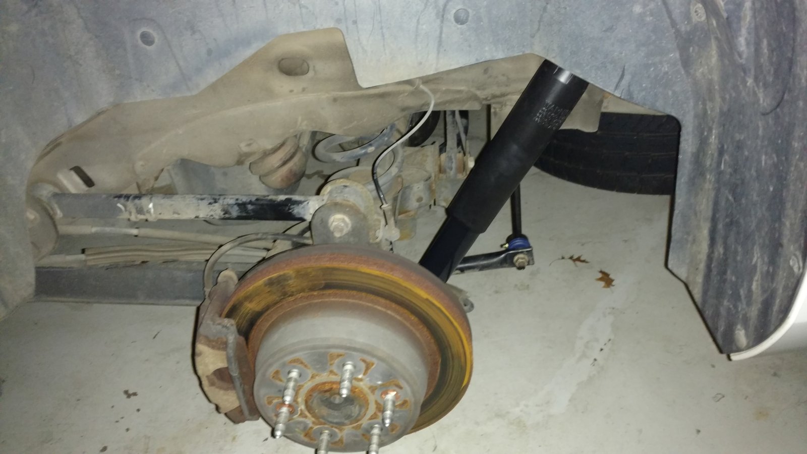

I began repairing the suspension (finishing the rear). The process went fairly smoothly, however I ran into some quirks:
-The top bolts for the rear shocks are not welded to the frame. I had to use a 6" extension to reach the bolt head on the inside of the frame. This was a bit of a time sink.
-The Monroe front top strut mounts did NOT fit. The 3 top mount bolts are longer (and thinner) than OEM. The longer bolts kept me from angling the new assembly into place. These were Monroe's recommended mounts for the 2011 Tahoe without active suspension. I have ordered some ACDelco mounts. If these have the same issue, I will cut off the end of one of the top mount bolts to give me enough clearance.
-Neither the top mount kits or front struts come with lower spring insulators. Make sure to have a pair on hand before starting work. You can get them separately from Moog.

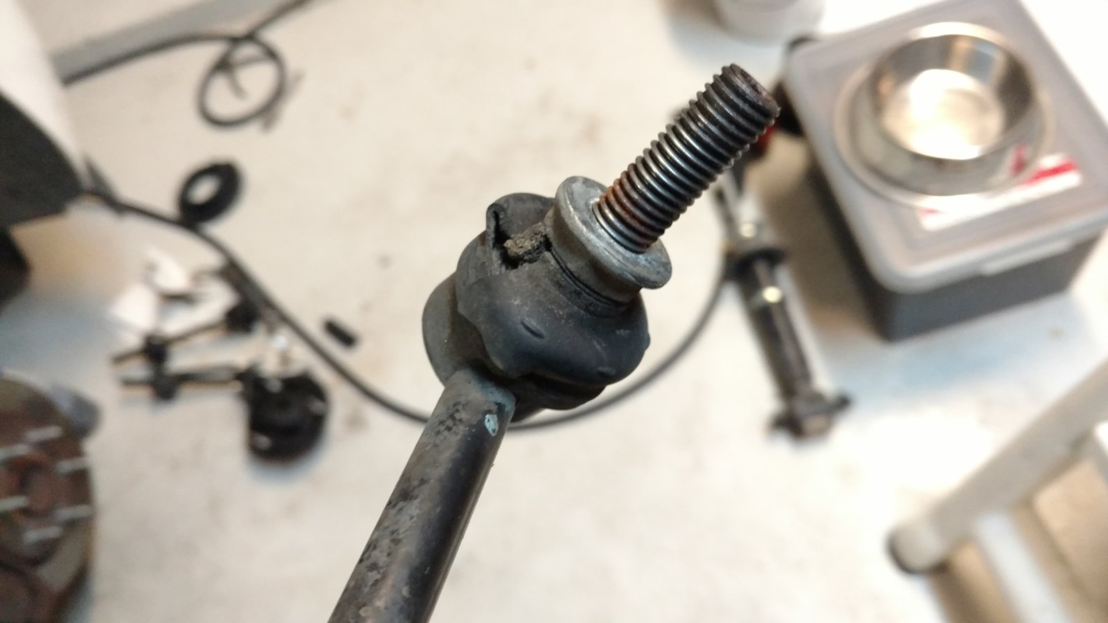

-The rubber on my front end links is rotten. I measured the center spacers and determined them to be 3-3/8" long. Autozone recommends end links with a 3" long center spacer (too short). I plan to replace them with Energy Suspension end links intended for a 1988 Monte Carlo. Are the front end links unique to the PPV?

-The old front right and rear right struts provide similar resistance to new struts when compressed. The rear left has clearly failed though because it takes very little force to compress and produces a strange squishing noise. I will check the front left when I receive my new top mounts.
-The new ACDelco rear end links come with zerks.

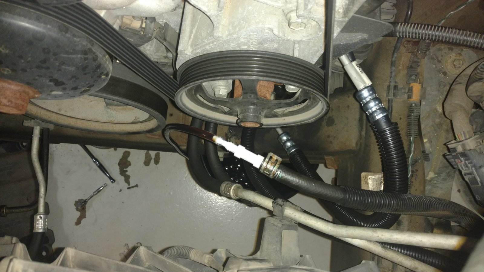

My high pressure power steering hose never arrived so I just disconnected the old HP hose and drained the power steering fluid from the reservoir. See circa-2011 blackness in attached. I'd say this PS fluid is just a couple shades lighter than my old brake fluid. If you replace the high pressure hose, I recommend replacing the rack to cooler return hose at the same time. Both connect through the same flange.

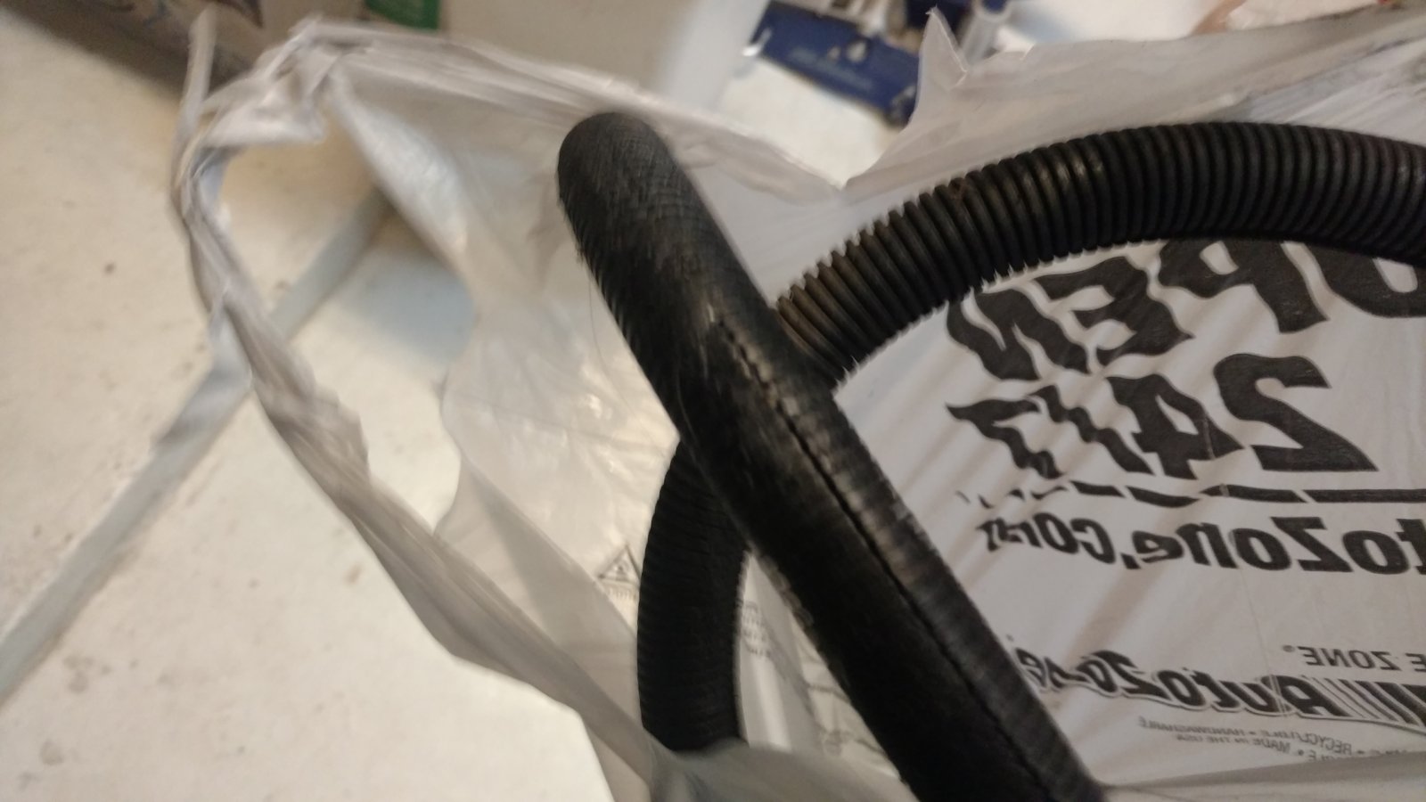

Updates from the last 2 days.
Yesterday:

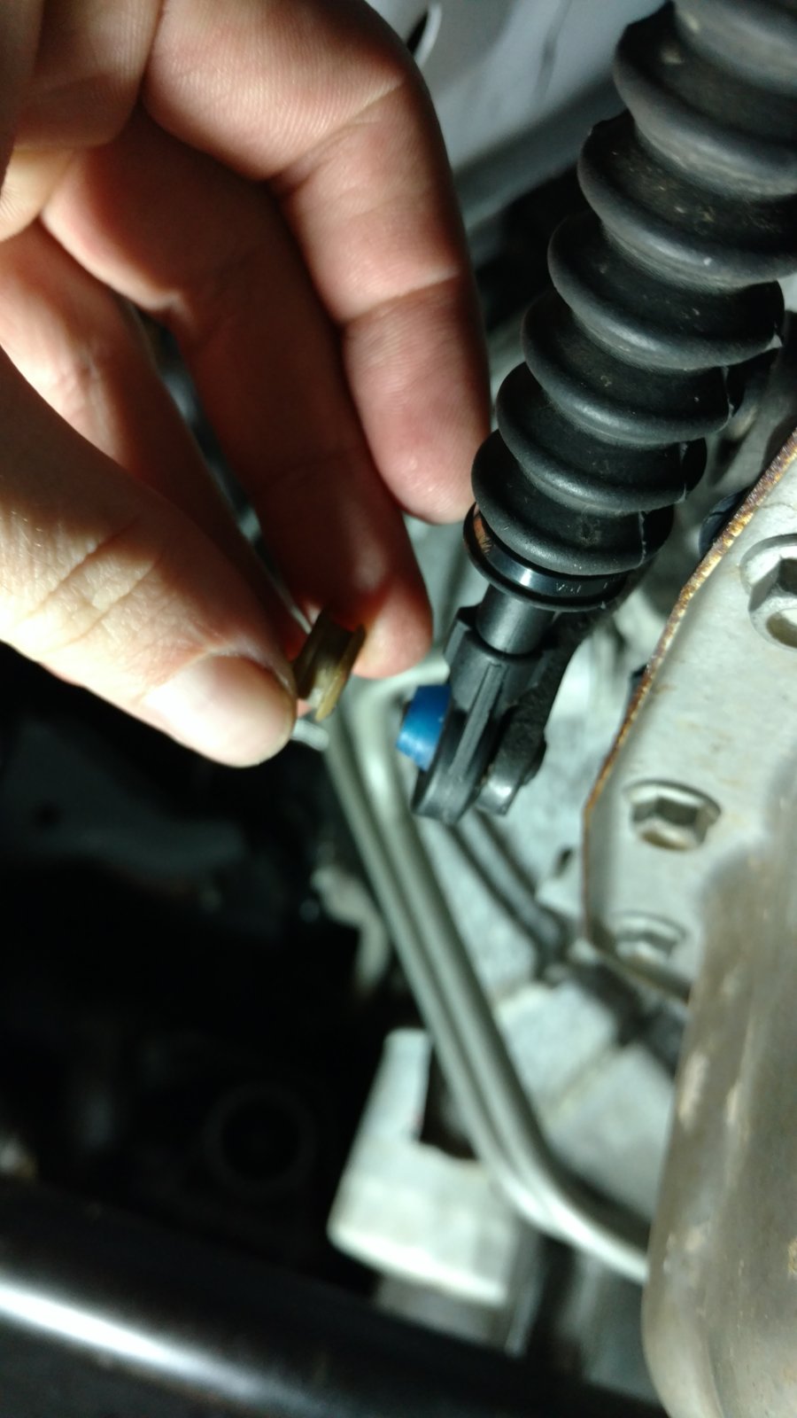

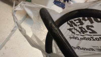

-I attempted to change out the power steering pressure hoses (to and from the rack). Unfortunately, the seals were leaking and replacement was a PITA! I spent about 6 hours meticulously scraping out the old cup seals and installing new ones. This part of the rack was very difficult to get to on jack stands. The new seals were very snug so I am keeping an eye for leaks. Bottom line is replace the entire steering rack if your rack is older and you have leaking pressure hoses. It's not worth spending an entire day scraping and pounding new seals into the rack. I might end up replacing the whole rack in the next year anyway.
-I installed the new AT shifter bushing. The process went smoothly and there is less play in the new bushing. Worth it. Overall, I suspect most of the shifter play is in the column though.
Today:

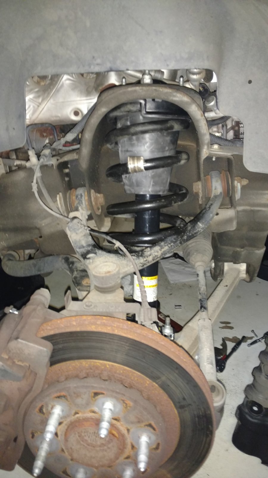

-I finished replacing the PS hoses and flushed the fluid. To flush, I just disconnected the return line (to the reservoir) and extended it into a catch can. Then I plugged the reservoir inlet. I filled up the reservoir and turned the steering wheel back and forth. Each turn from lock to lock empties the reservoir. Soon the old black fluid was gone!
-I installed both front strut assemblies. The AC Delco professional upper mounts fit properly! The Monroes are getting returned. Make sure you "clock" your strut bodies and upper mounts precisely so they line up with the chassis and control arm mounting holes.
-I couldn't install the new Energy Suspension end links because the center bolts were too short. I am buying longer end link center bolts tomorrow.
