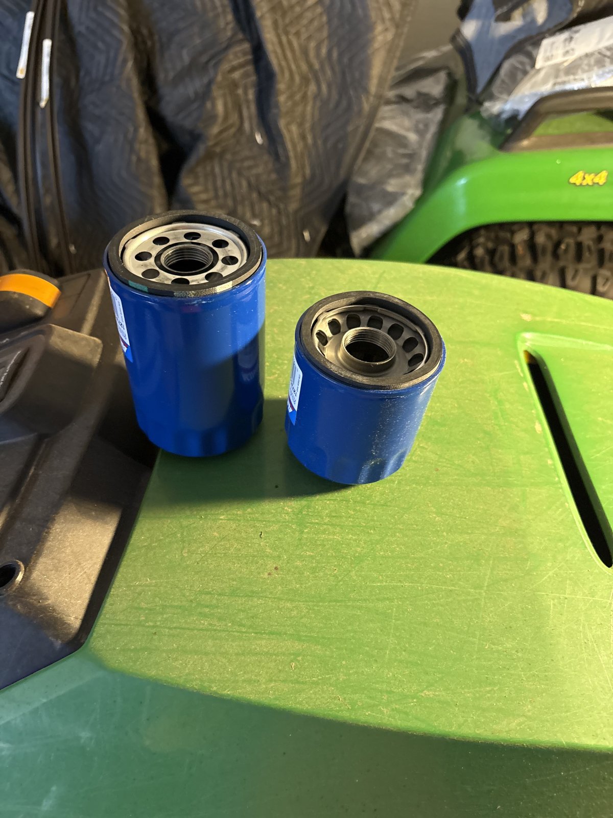

the smaller filter is the 3.0… larger is 5.3/6.2 filter.. the diesel is really not any bigger than a 3 cyl kubota filter.. i can see it is way too small.
