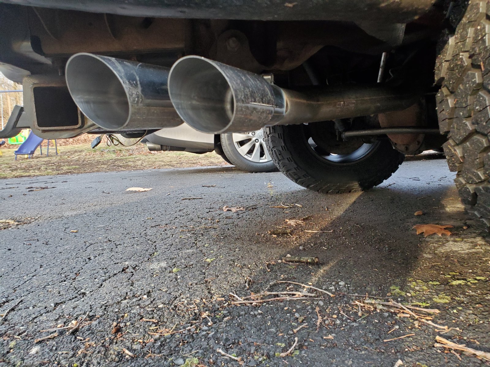

ok here is my Gibson info/ review. i finally got the system after waiting 17 days for fedex to get me the exhaust. over a week for them to even attempt to deliver it. anyway....
so as per the instructions that come with the kit it didnt fit quite right and the way i would have preferred. typical crap ubolt exhaust clamps just dont get tight enough and im not about to break them. with the muffler rotated the way the instructions state with the tailpipe slide on the y pipe for the system was being pulled down into the cross member. the tailpipes are not the correct length and dont slide into the muffler correctly. one is bottomed out and the other is only in maybe an 1 1/2. the bolt tab that holds the tailpipes together pulls them together so tightly the tips cant be put in.
so tomorrow i will try to reorient the pipes a bit so i feel better about it. i also have my welder still setup for stainless wire so ill unbolt the tab and weld the tab together in a position the tips can actually be put on.

instructions state muffler inlet should be at 6 o'clock and the image of the outlets show them at the bottom of the muffler. so i potentially got shipped the wrong muffler in the kit. as per instructions wording and pictures the inlet and outlet of the muffler should be at the bottom of the muffler. the muffler is offset top and bottom so thats impossible. parts list seemed correct before i started ill double check tomorrow. ill take some pictures and a video tomorrow maybe.

well so far i do like the sound. seems almost the same as my diy thrush setup that i already liked. it might be slightly deeper but pretty sure im losing some hearing on one side. so i can correct the issues with the exhaust myself. i mean no discounts this exhaust is like 650 range so i really wasn't expecting to have to do anything besides put it on.
so would i buy it again no
so far it does sound good
quality is in the middle

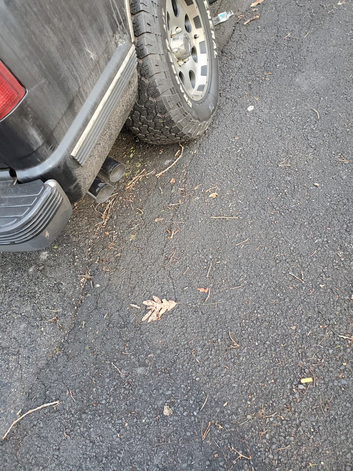

quick shot of the tips before we head to my dads.
