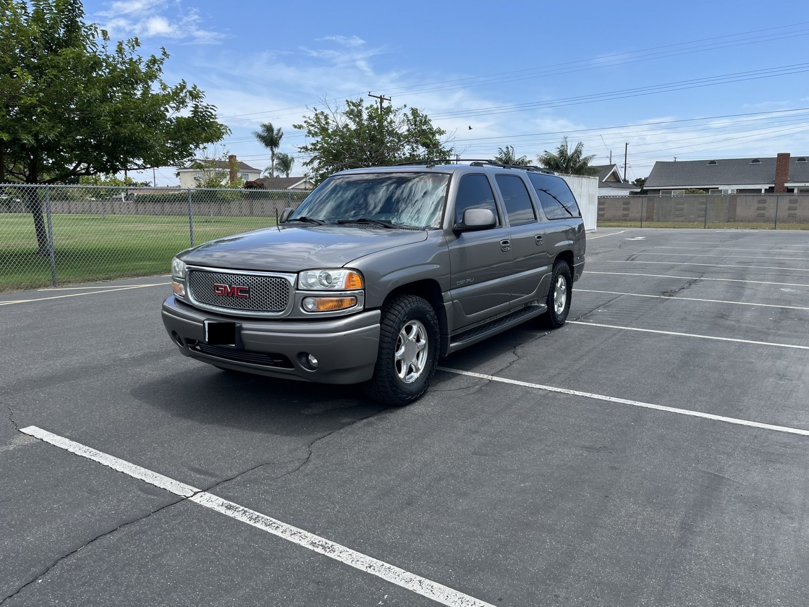

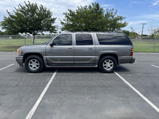

This is my first GM, and I researched quite a bit before buying into the gmt800 platform. It was gmt800 or pre 2010 6.2L gmt900, mainly wanted to avoid AFM. I have a lot to learn! Rig has treated me well so far, going on a year of owning it, was a 1 owner 173k miles when I bought it. Been working on cleaning it up little by little. Here are some pix , and thanks again for all the info!

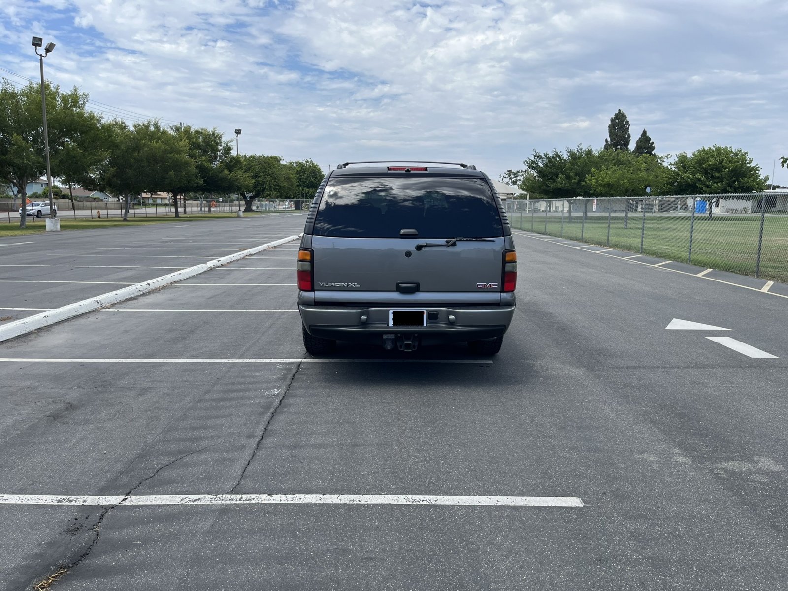

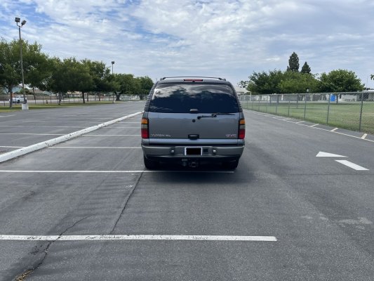

Alright so I installed the rear 5100's and Moog springs! got enough lift and tires don't rub any longer! Now I have a question about the front.
Do stock front shocks stop the torsion keys from lifting the front more? I noticed my driver side torsion key was tightened a lot more than my passenger side (bought it like this), so today I did 3 full turns on both sides, driver Side has maybe 1 full turn before maxing out, and passenger side has plenty more to go, but the rig isn't as lifted as I heard some say you can go with stock keys, so I'm wondering if the stock shocks are "stoping" it from going higher ? I have the 5100's for the front and I'm wondering if I remove the stock shocks and install the 5100's , will that lift the truck more without turning the keys more? not sure if it works like that. Thank you ahead of time!
I attached a before and after.
