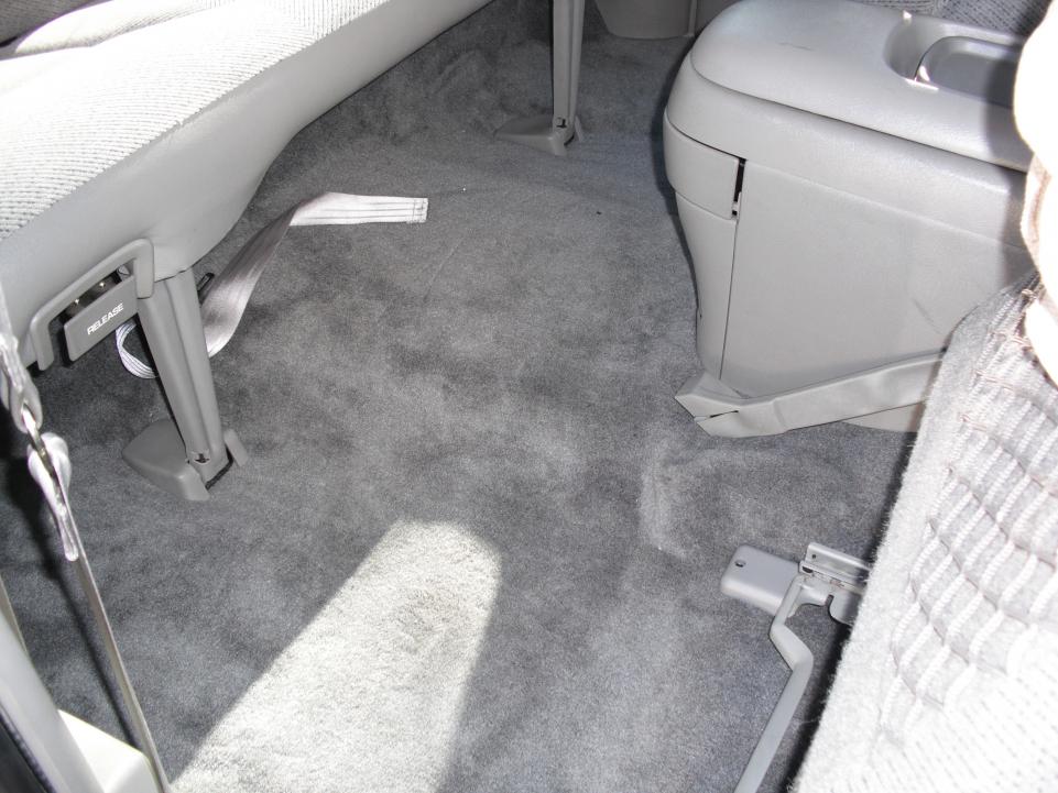

Thanks...it only cost $200 total for everything. I took out all the plastic inside and gave them a bath, so it came out looking pretty clean.
As far as looking for something more plush, I don't live in it, so I didn't see the point in spending $800 on carpet. Thanks for the input though.

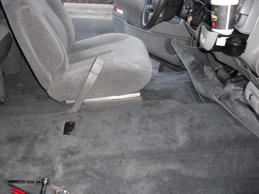

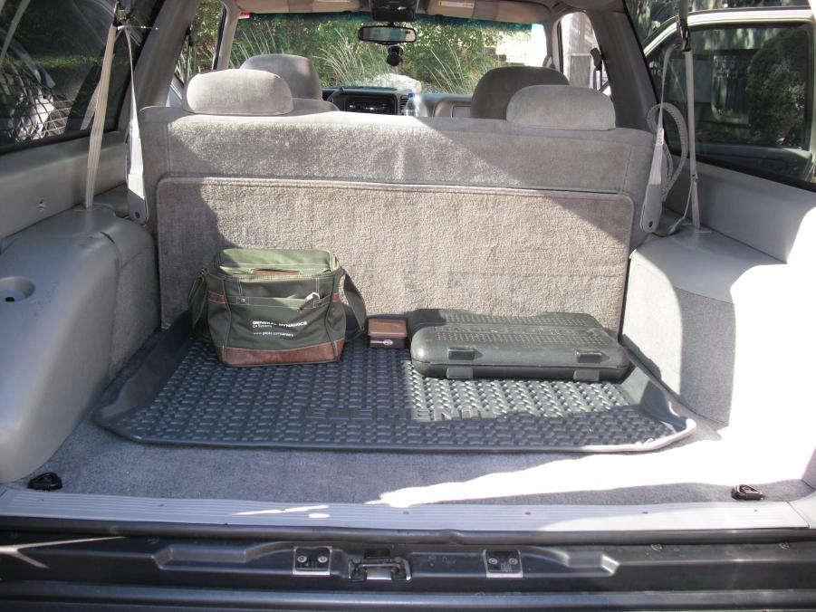

Couple more pics

no tools needed really. But youll need a phillips screw driver for the door sills, torx bit for the seat belt and rear cargo hooks, a knife for trimming and thats it..

Ya not too many tools, like Atomic said, screwdrivers (helps to have a cordless), torx bits, scissors, knife, beer, not any special tools or anything though. It is a fairly easy job, but have to have some patience.
Ya, I ripped everything that was in there out, it was in pretty rough shape. I laid down some extra carpet insulation down though.
Like I said before, I wasn't looking to spend alot of money on something "plush". I wanted something functional that was a decent quality for a decent price, but won't have to take my shoes off when driving for fear of getting it dirty. If I wanted plush I wouldn't have bought a 10 year old vehicle. Sometimes spending a little LESS and doing it yourself goes a long way.

Got it done today! Looks pretty good
Hey bro! Greetings from Austin, TX as well. How was the overall new carpet install? I'm looking at replacing the carpet on my 2 door.
Did you order your kit from accmats.com and did the kit come with the rear/hatch carpet as well? Sorry for all the questions I'm really looking forward to doing this! Thanks again for your help!
