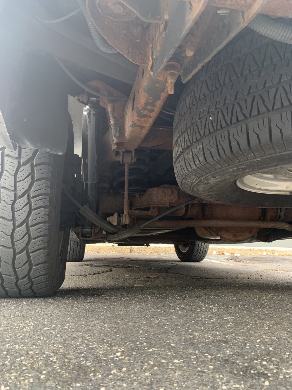

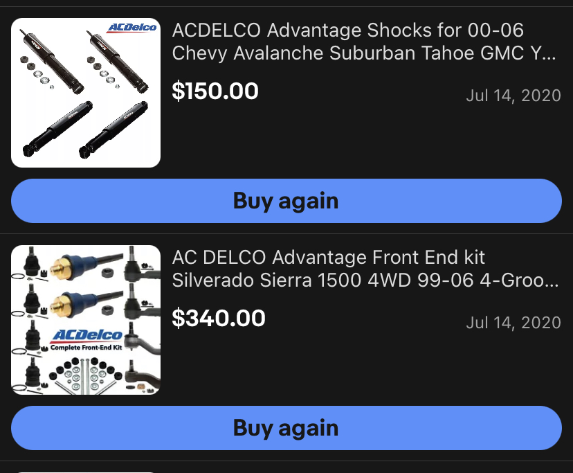

As mentioned I’m attempting to get the ride a bit smoother out of my 03 Yukon, but geez it absolutely bangs and smashes over the smallest road imperfections. Maybe next replace springs? I’m lost. Thanks

the advantage line is one of gm's cheaper quality lines. I would go with some Bilstein 4600 or 5100 in the front. they will be about the same price or maybe a hair more but are a better shock. **edit, if the shocks you took off the back were bigger than the advantage line I would put the rears back on the oem nivvomatt's are hard to beat, they are pricey I think around $5-600 each or they used to be anyway
