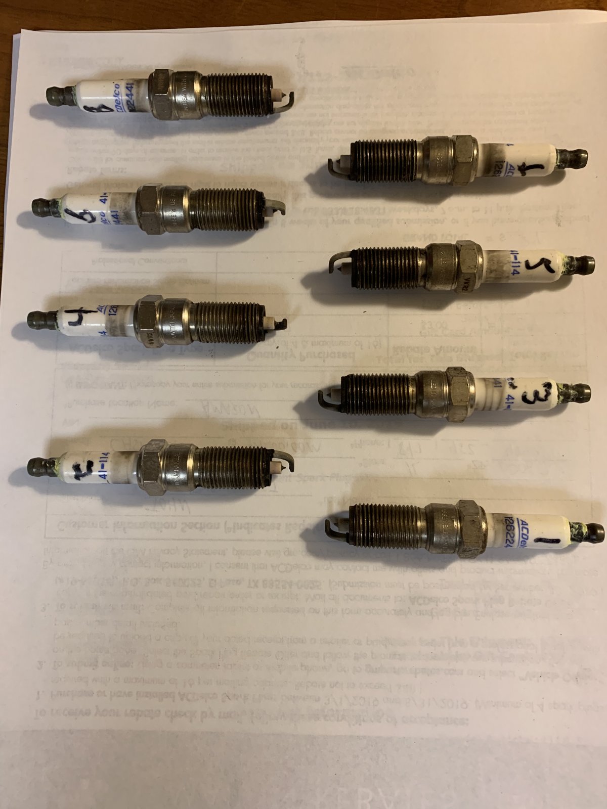

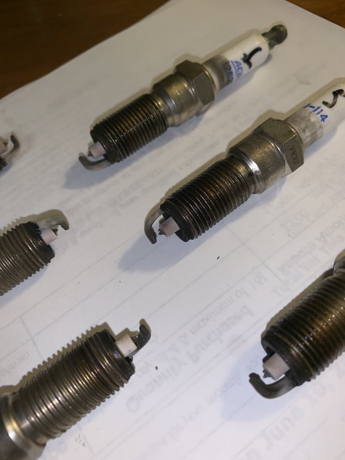

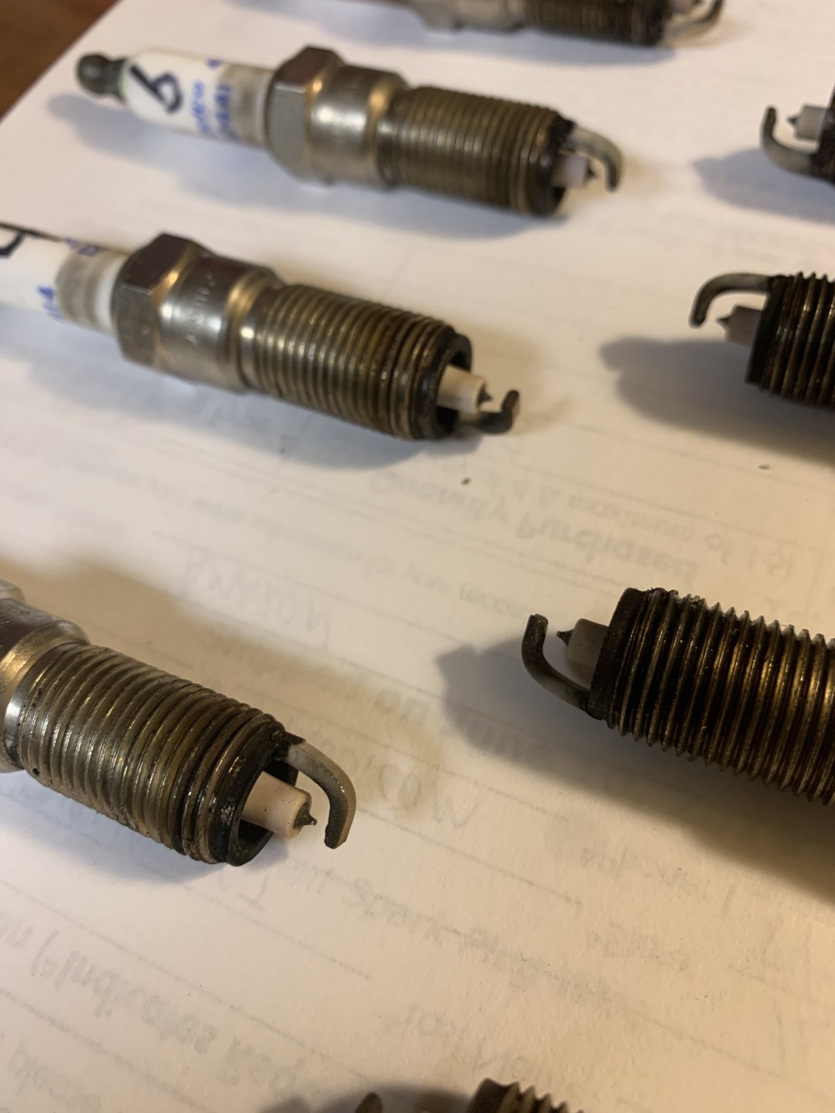

Sharing pics of plugs at 76k. Changed wires as well.
Manual states 97,500 miles to do this, but I tend to do routine maintenance early, since I don’t drive in ideal conditions. Waiting until 100k might also make it hard to get plugs out...
They look great. Probably no issues going the full 100k interval.

They do look pretty clean! Any noticeable difference in performance/mileage etc from the change? I’d be more curious if you found any defects in the wires due to age etc...

I can’t really tell a difference. Maybe a little smoother idle, but I thought that could be placebo effect.
Wires looked fine and I resistance tested one and it was fine.
I really just figured:
1- we don’t drive in ideal textbook conditions, so 100k seems long
2- the longer those plugs stay in there, the harder they can be to remove
3- I’ll never have to do it again, since the longest I’ll keep the truck is to 150-200k (I hope, if it doesn’t fall apart before then)

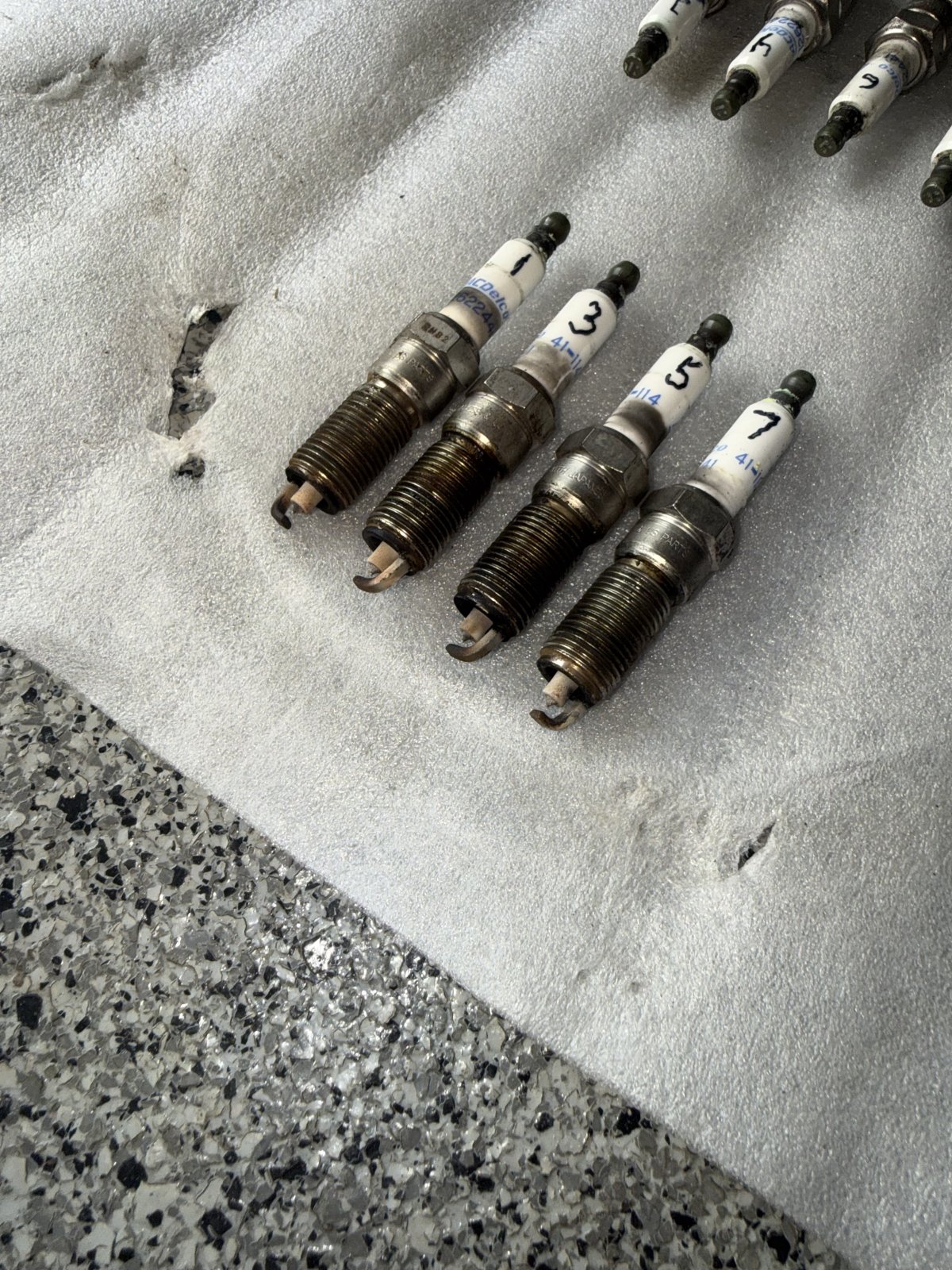

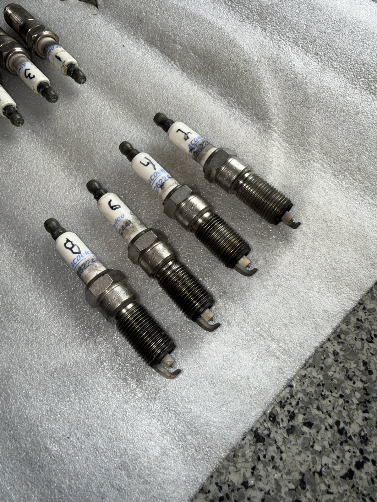

OP with next set of wires and plugs - 172k on truck and 96k on the old wires and plugs.
Took me from 12:30-2:15 start to finish. I did remove the passenger wheel liner again, it’s the best way.
Plugs were not terrible, but it was time. All gapped at .040 except cyl 1 which was tighter at a little more than .030.
Hope to get another 50k out of truck….
