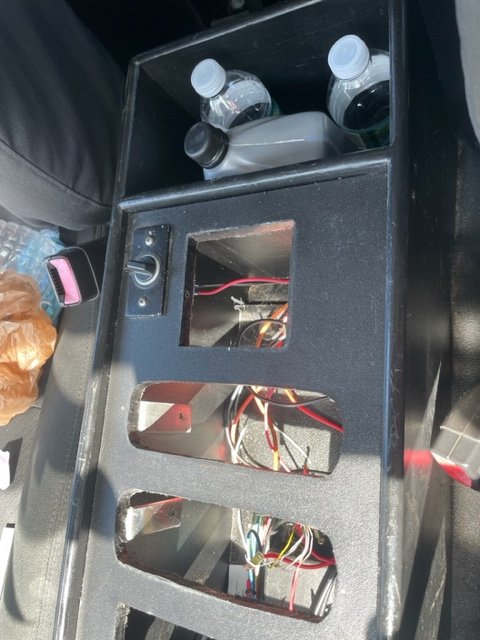

Please anyone know how I can go about removing the SSV center console and associated wiring. The last image is inside the console looking to the front.

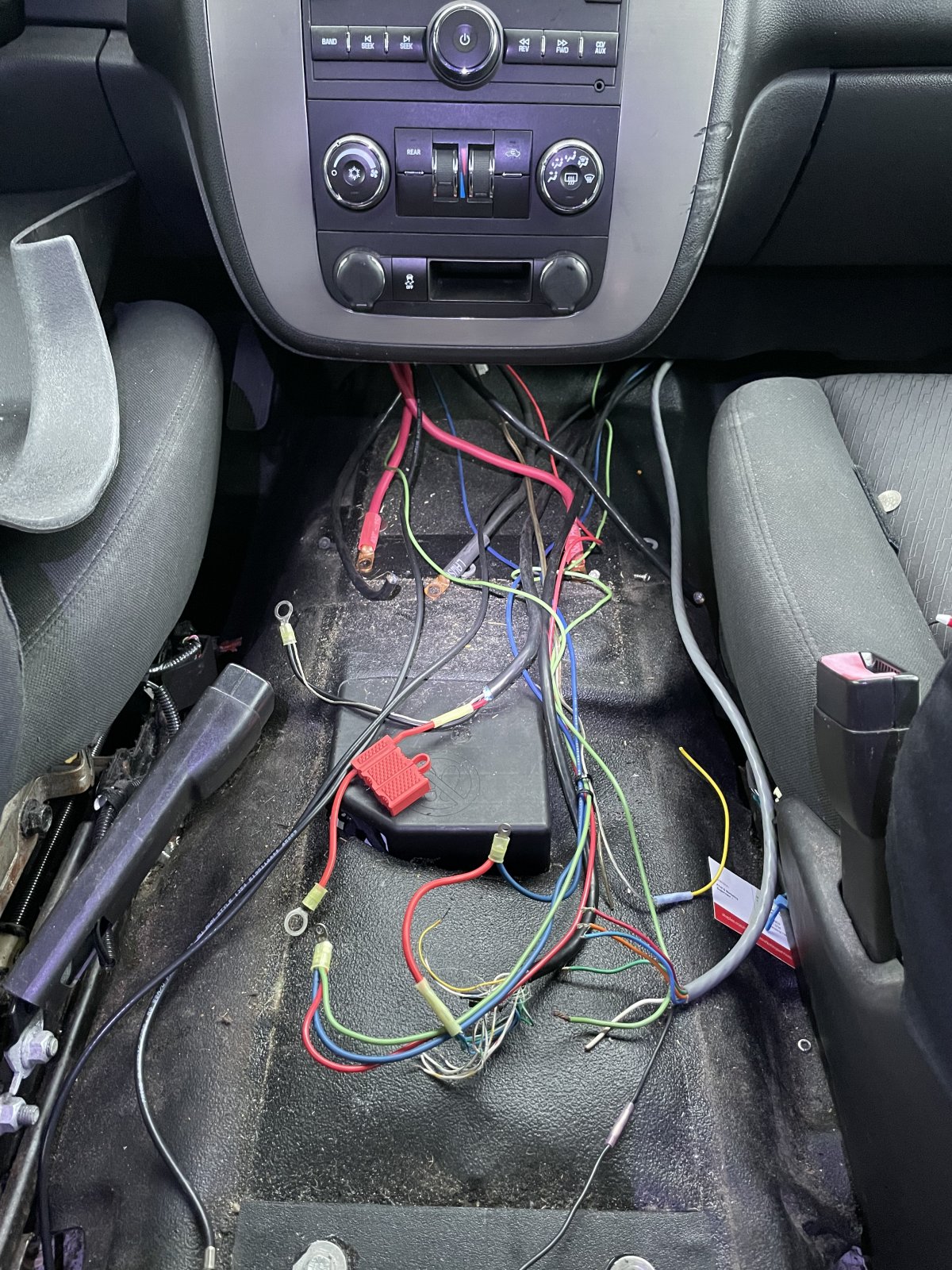

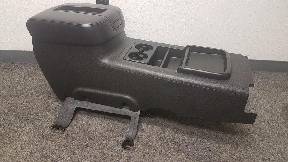

Just an update I got the center console dismantled. All it was held together by screws along sides.
I’m left with a mess of wires that seem to run up under dash. Does anyone know how I can go about getting to other end of wires?

If you have a Volt meter or DVOM or test light I would check what wires are live and what are dead. I would follow each wire to the dash if you cant trace it anymore I would cut it and cap the end (Closed End Crimp Caps).
I had to pull most of my interior to trace all the wires - Radio, ac controls, glove box, kick panels, A/B/C pillars, back trim and etc. lucky 75% of all the panels are held in with clips.
Also Each wire you Cut or remove Start the SUV to check if you cut a main wire or etc.
Also I would take advantage of all the extra wiring in the console add on a fuse block to wire up other things IE radios, chargers, and etc.

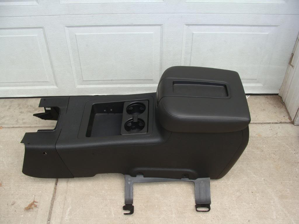

You found one of my old post, it is a direct fit our center dash sticks out more then the truck model see attached photo it is more common for a Jump seat then a full console in a truck and a SUV (attacked both consoles), you will need to cut the airbag cover a little sometimes they bolt in fine some you need a little trimming. Make sure you take the airbag cover off before cutting.
I have a harbor freight multimeter but never used one before. Any advice on how I go about doing this?
S
shoop
Feb 8, 2023
34
17
Thanks but I only see one terminal for each of these wires. If I just put one test probe on the terminal will any value, if it is measuring volts, indicate the wire is live?
