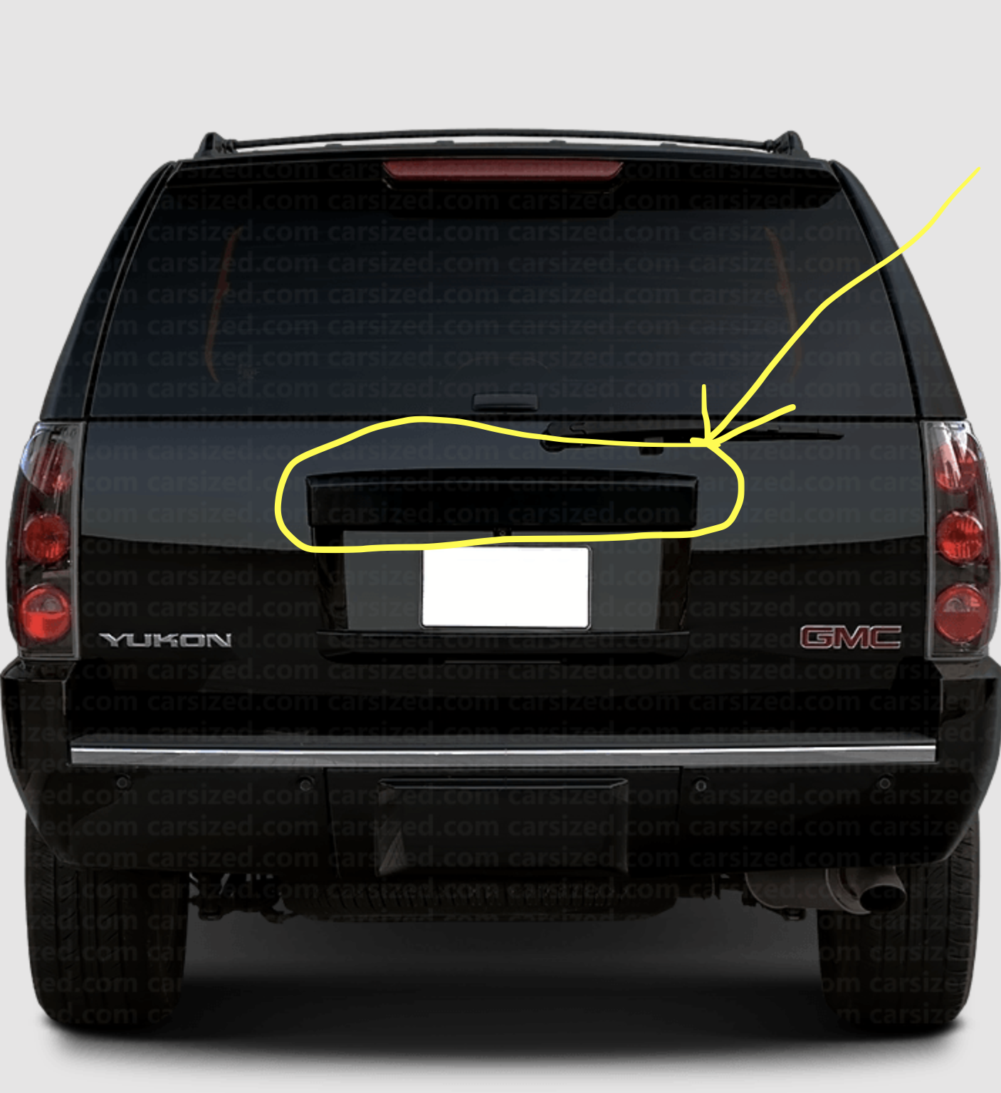

Need to pull off the upper trim panel to fix some chipped paint. Does anyone have the plan of attack? I did just buy some trim tools to help.

once you have the inside plastic trim off then there are access holes to remove the bolts that hold that trim piece to the rear hatch skin, if you try to just pry it off you will break it

Awesome, thanks for the tip. I was going to just try to pry it off with the trim tools.
I found this video that shows the process:

you might not have to remove the wiper motor, from what I saw in the junkyard you might be able to reach in with a small box wrench and get the covered bolts loose that way, then the license plate lights and rear view camera can be disconnected from the trim panel

GM decided to put some strong thread locker on those four small screws that hold the rear applique on. When you unscrew them, the metal square nuts in the applique will turn and ruin the plastic. Luckily there is enough "meat" there to put the square nuts back on with some strong 2-component glue. When reinstalling make sure to put some light-strength thread locker on those four bolts, otherwise they'll loosen up in a couple of weeks. Also make sure that you reinstall the little foam gaskets around the four bolts, water could leak in otherwise.
That's what I did, I never touched the wiper motor.

Thank you for this advice.
I have some blue loctite, which should be fine. I also just received some Rocksett for those pesky high-temp firearm related situations.
When you say two component glue, do you mean some plastic epoxy 2-in-1 schmoo? I suppose I'll know it when I see the damage. I just want to buy some chemicals now before I get into the process. Tia.

if those nut post's are known to break I would just use a box wrench on all of them and hold the post with a set of pliers or vice grips while breaking the nut loose

You make a good point. I think some some of them are only accessable with a deep socket, and can't be reached with a vice grip on the top of the threads to stop it from spinning.

from what I saw you should be able to reach them with a grip "if" the wiper motor is removed, otherwise those inner 2 would be a bit tricky the area is tight inside
I have a full set of vice grips from small to large I think the small one would fit
something like these, mine are the more pricey vice-grip brand but these are pretty similar
