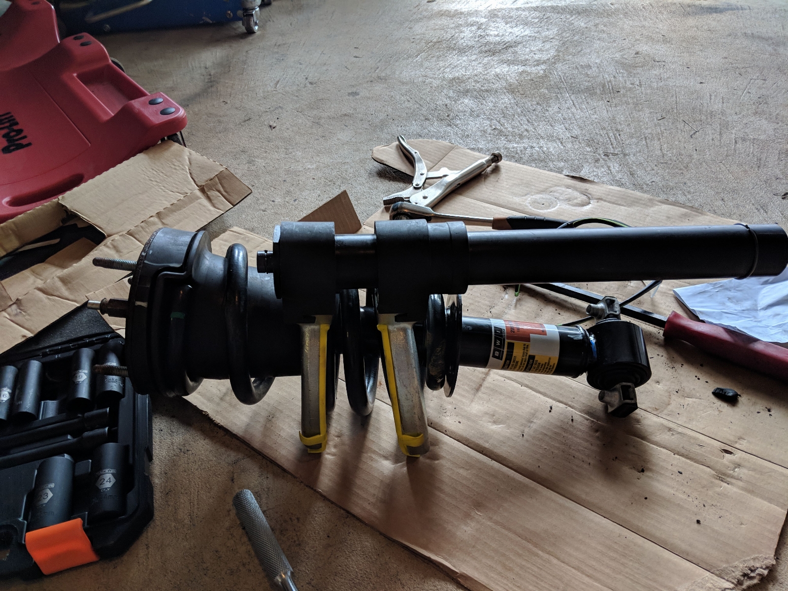

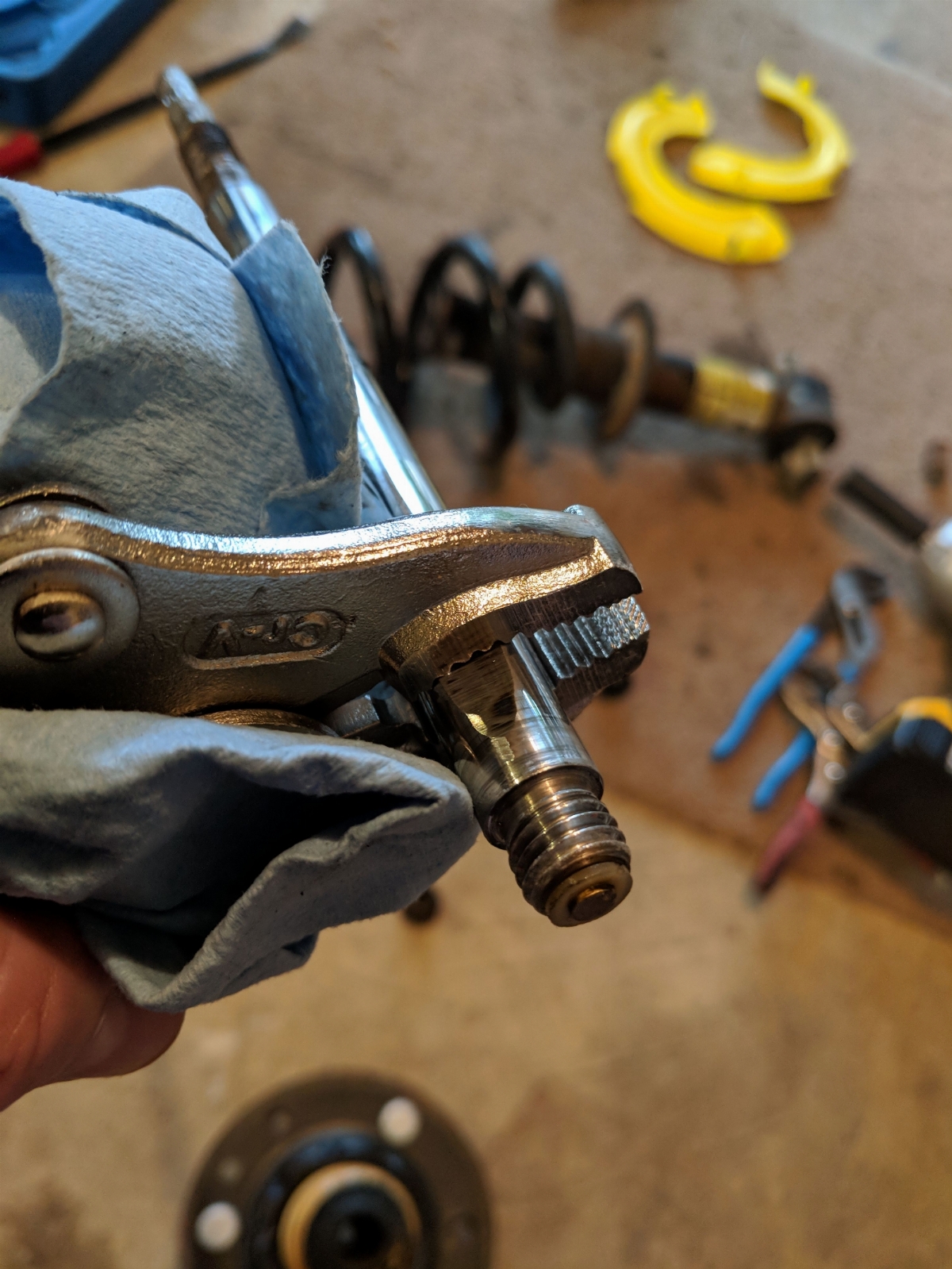

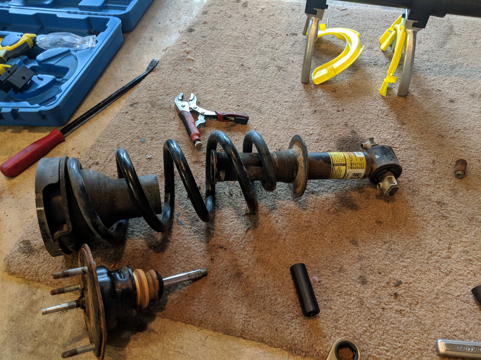

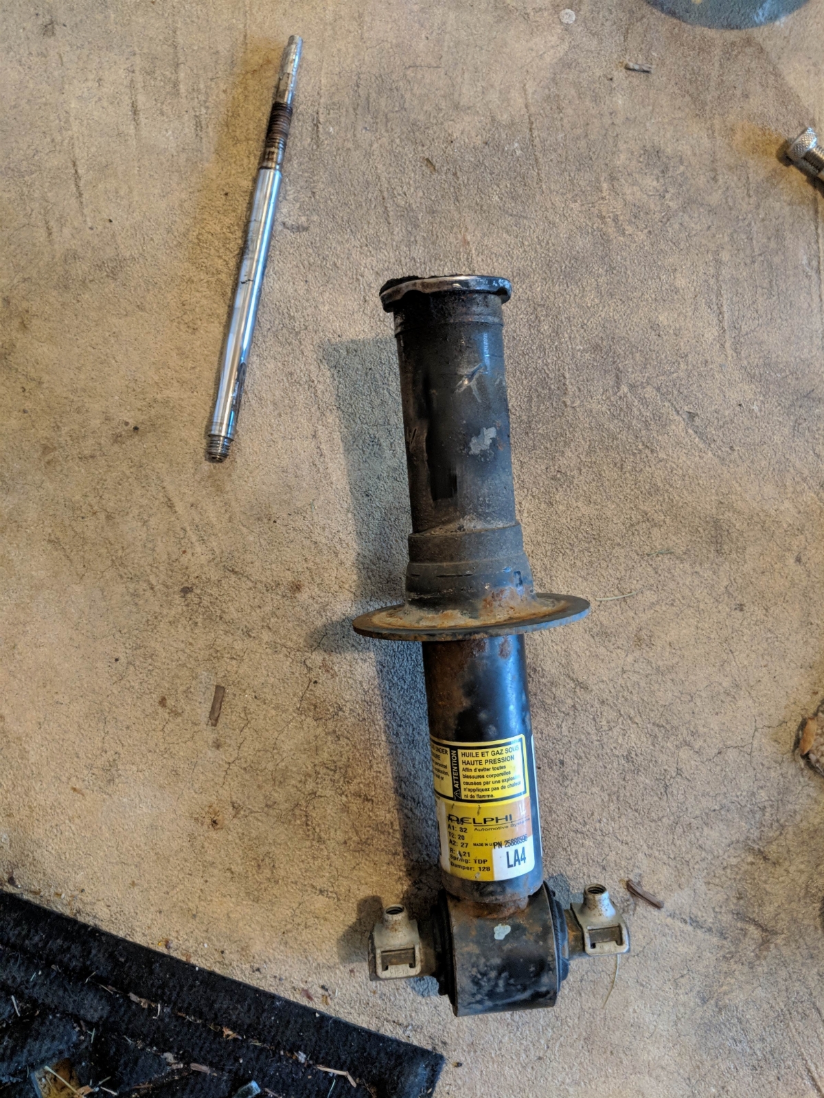

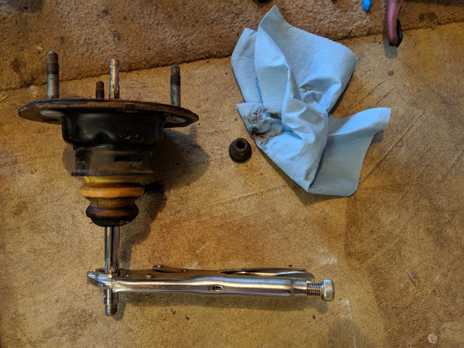

***** apart now. Not like I anticipated but it happened. The spring compressor worked well. The 2nd nut on the strut was fairly welded in place. I actually had to grind a place to clamp to remove it. Also the strut broke in half. Yeah....
Broken apart
Ground place to grasp
Ready to twist with fancy sockets
All in pieces
Well I guess that explains why they say not to let the shaft rotate... it's threaded on the lower portion as well.
Thats exactly what I was thinking! Finally, proof!
