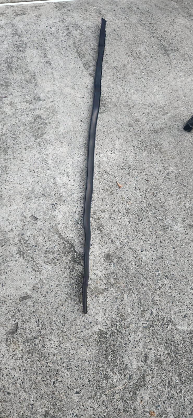

At $80 a piece for new ones a work around is going to be needed. Or just leave the seam exposed.

They never go back to the normal shape. Wind grabs them easily and they are ripped up again. Clean and install new is the best option.

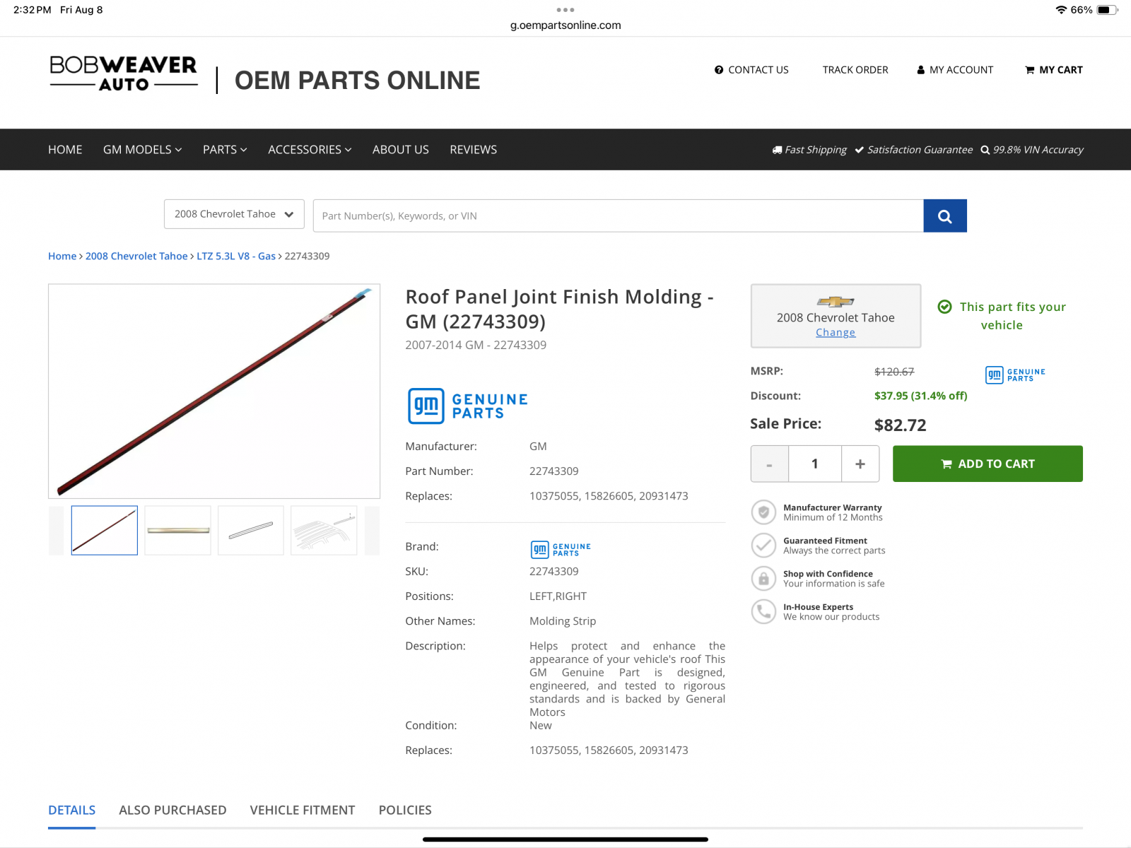

Psh. you clearly don’t understand how body panels are assembled. I will say i completely disagree with what you consider that strip of rubber to be. What you think is going to be damaged is called panel seal and once cured, UV and has zero effect on it. It’s in literally every body seam of your vehicle, and none of those are covered by anything except possibly paint. If you’re still convinced that’s a gasket, here’s the part description. It states it ‘protects and helps enhance the appearance of your SUV’s roof” but it also does state it’s a “finish molding” and thus not a true gasket. It will not keep water out. Your expertise is clearly not in vehicle bodywork so please quit trying to act like you know. You’re being misleading to people who don’t know any better. That piece is not to seal, it’s only for looks. Like I said, my pickup had neither side of those rubber strips in it for years and d n ever leaked. You could have left those out of yours too and it wouldn’t have leaked.

Psh. you clearly don’t understand how body panels are assembled. I will say i completely disagree with what you consider that strip of rubber to be. What you think is going to be damaged is called panel seal and once cured, UV and has zero effect on it. It’s in literally every body seam of your vehicle, and none of those are covered by anything except possibly paint. If you’re still convinced that’s a gasket, here’s the part description. It states it ‘protects and helps enhance the appearance of your SUV’s roof” but it also does state it’s a “finish molding” and thus not a true gasket. It will not keep water out. Your expertise is clearly not in vehicle bodywork so please quit trying to act like you know. You’re being misleading to people who don’t know any better. That piece is not to seal, it’s only for looks. Like I said, my pickup had neither side of those rubber strips in it for years and d n ever leaked. You could have left those out of yours too and it wouldn’t have leaked.View attachment 464586
