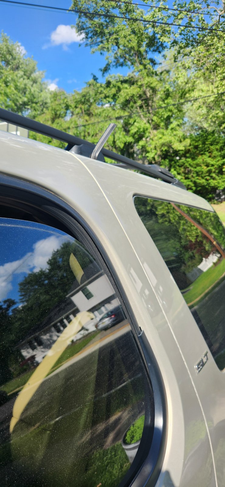

Y'all,
After a year and a half of ownership, I'm finally about to treat my Tahoe's exterior to some TLC. I'd like to take care of as many nooks and crannies as possible, so I'll be removing & reinstalling various pieces. As part of that, does anyone have any advice or experience with the "Roof Panel Joint Finish Molding" (the black strips along the top sides of the rear portion of the roof)? Will it matter for sealing if these are simply left off? These things are absurdly expensive, so I'd like to not damage them or any panel sealing.
Before anyone asks, yes, I understand (and have used multiple times) the "dental floss trick" for removing trim pieces held by double-stick/foam.
Thanks in advance,
Scrappy

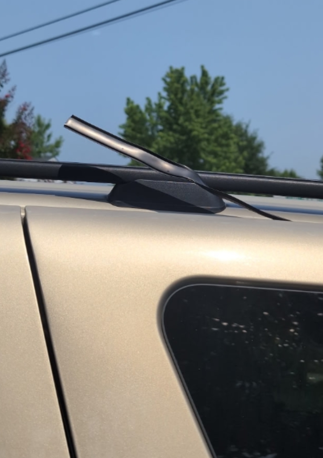

I currently do not have any experience with them but I will soon since mine started peeling up. I think they're just glued in there.

Yes. When you buy a new one it comes with the adhesive. Best way is to remove the old one, clean all the residue off with alcohol mixture, and apply new one.
52,954
They’re only for looks, they serve no purpose as far as sealing. They are used to cover the body seam thats welded and seam sealed along the roof line. They’re held on with 3M Hi Bond tape.
I used 4" black gaffers tape on the leading edge...... So far so good... ( you can't tell the gaffers tape is there.
( "Gaffers tape"...... The concert stage flat black 'anti-reflective' type duck tape..... Actually lasts a long time.

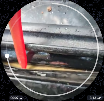

I've just teared them off. Was a pita to straighten them back for reinstallation.
All they do is help to prevent water gathering up on the sealant that's underneath. If you leave them out, be prepared to re-do the sealant because it will definitely crack after some freeze-unfreeze cycles in winter

They are beauty strips, they do not seal water out. They don’t fit in there super tight like a gasket would. Nothing will happen to the seam sealer if you leave them out. And the seam sealer used there is the same that’s used everywhere on the truck where two pieces of metal come together in a seam that needs to be sealed, and water has zero effect on it. I bought a pickup that had those pieces missing for years and the seam sealer was unaffected of course. If you have an opinion that’s fine, but if you state something as if you know it as a fact you need to be able to back it up in which case you can’t on this. For another thing, there is no sealant on any vehicle that I have ever heard of being affected by freeze/ thaw cycles. If there were, there would be leaks from panels everywhere. Nonsense.

That sealant there is not covered up by paint and has no UV resistance, that's why it will eventually fail without these beauty strips. Freeze/thaw cycles will help it fail faster because more water will build up on top and on already flaring edges of completely solid sealant with almost zero flex/expand capability. Every sealant is indirectly affected by freeze/thaw because water gets in the tiniest cracks and flares and then expands significally when frozen.
English is not my native tongue so I may not have made myself clear enough, but your reaction seems to be excessive, to say the very least. I had to re-seal this exact place on my '08 hoe this spring: with a lot of ice buildup on it during winter and being constantly freezing and unfreezing the whole sealant strip on both sides came off with only a half an inch piece keeping it on the roof.

I was thinking ( ??? )… Remove them, lay them out in the hot sun… soften them up, then re-install??
I wonder what the part number is, and buy new ones….
They never go back to the normal shape. Wind grabs them easily and they are ripped up again. Clean and install new is the best option.
Depending on your vehicle and the color will determine the p/n. Mine was GM 15826605
