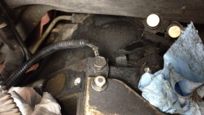

mine has voltage problems i looked at some videos and found out if i move this ground point to the firewall would it be okay if i take the risk heres a pic of the bolt on back of the engine block help please

For anyone else that runs into this issue, I highly recommend following Maximus1's advice. I, too, know my way around under a vehicle. I fought the P1516 and P1518 for 3 days. First, removing the ground from the right rear of the block extending it to a firewall stud. Checked ground continuity. 1.6 ohms. I thought that that was a good ground. It would easily light a test light. Still had the codes. I then changed the TBS, TBS harness, TAC module, APS and finally the TB. All to no avail. At that point I used Maximus1 advice above. Opened the harness right off of the underhood fuse block. About 12 inches from the fuse block you'll find a factory splice of 3 blacks w/ white stripes going into one. Jump off right there with a new ground going straight to block. I went to one of the lower bolts on the alternator bracket. One holds two grounds already. I went to the other one. Ohm'd that new ground at 0.00. Cleared the codes and cranked it up. No codes.
This is an old thread but curious if anyone can point out which wire was grounded. See below what I found and please confirm for me. Thank you!
