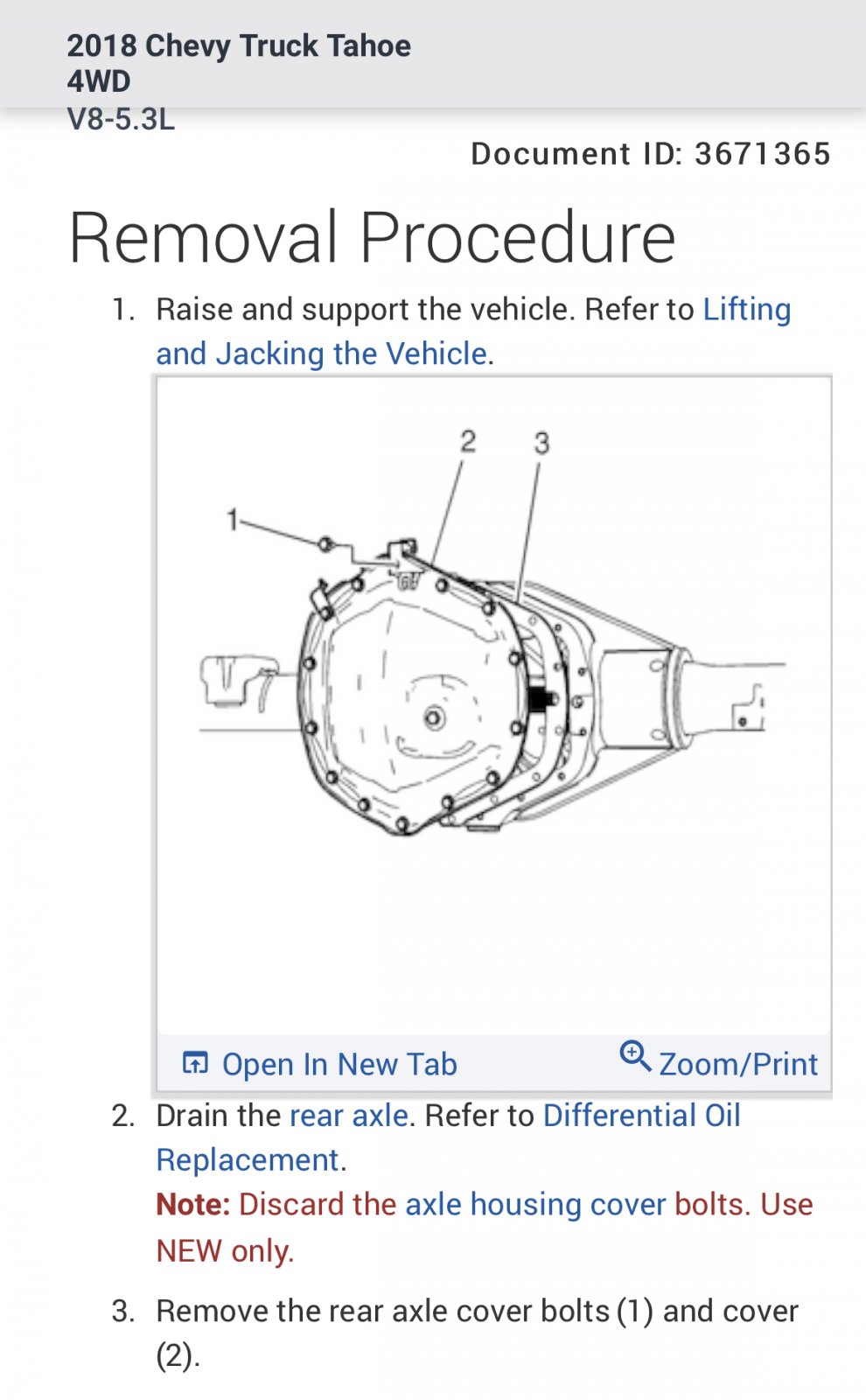

Something I just found out. The service manual actually calls for using new bolts when installing cover. Hmmm. I reused my old ones. Oh well. Torque is 30 lb ft.
Yep, you won't have any problems. They probably do it to ensure the bolts can be torqued as close to the spec as possible. Old bolts with rust and crud on the threads will have a wide variance in clamping force for a given torque.
