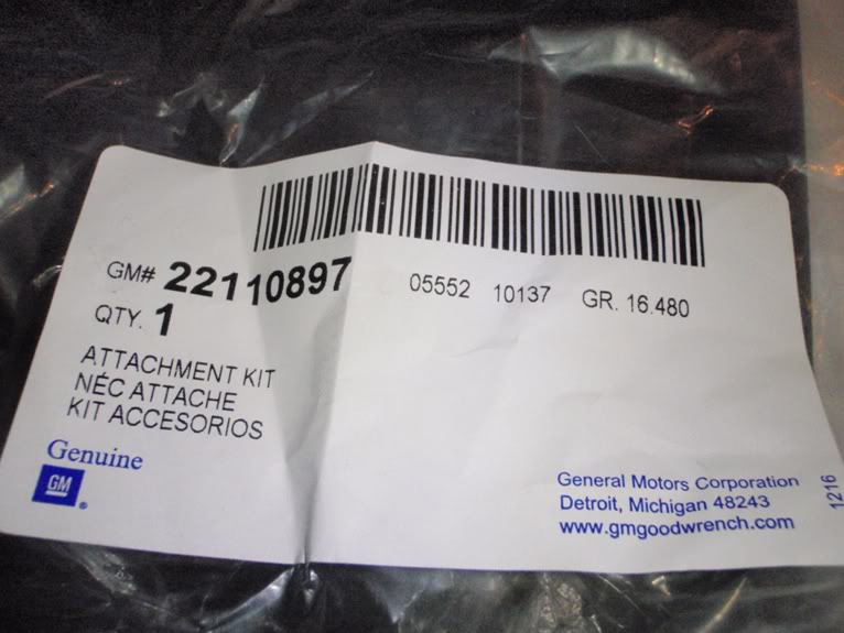

This is the dealer part illustration. Looks like Im going to the dealer to put an eye on it.
92TxBlazer
Jun 8, 2010
So I found the part number at the dealer (22087418). But its called a rear wiper mounting kit and doesnt come with the button plug piece. They sell the pieces separately and dont even have any in stock in the US. There are 3 in Canada. Price? $30 plus about $10 shipping. You have got to be kidding me. That price includes a and a .20 screw. Cant find it aftermarket. Looks like a junkyard trip or making something myself.
This is the pieces that cost $40.
92TxBlazer
Jun 8, 2010
The top 2 pieces are from GM parts. $30 Finally got the piece I needed.
In the process of everything I broke the nut that holds on the wiper motor shaft. Bought that and the screw for the top left piece for $4 total from LMC. Finally...its over.
