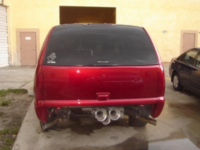

shaved rear wiper arm
i love the shaved look and with the deleted rear wiper arm it looks even sexier,ive already shaved handles and rear wiper and tailights and roof rack completely off and its looks sick but all depends on the person and overall look your going for. i have a 2000 suburban ...good luck

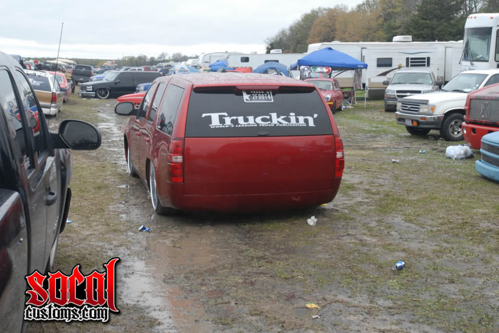

I would say that the only thing taken off the gate is the wiper, if the applique and license area plate are shaved and made even, it will look wierd.
Example:
Example:
Not a fan of roll pans on these NNBS's, but the shaved wiper looks good
