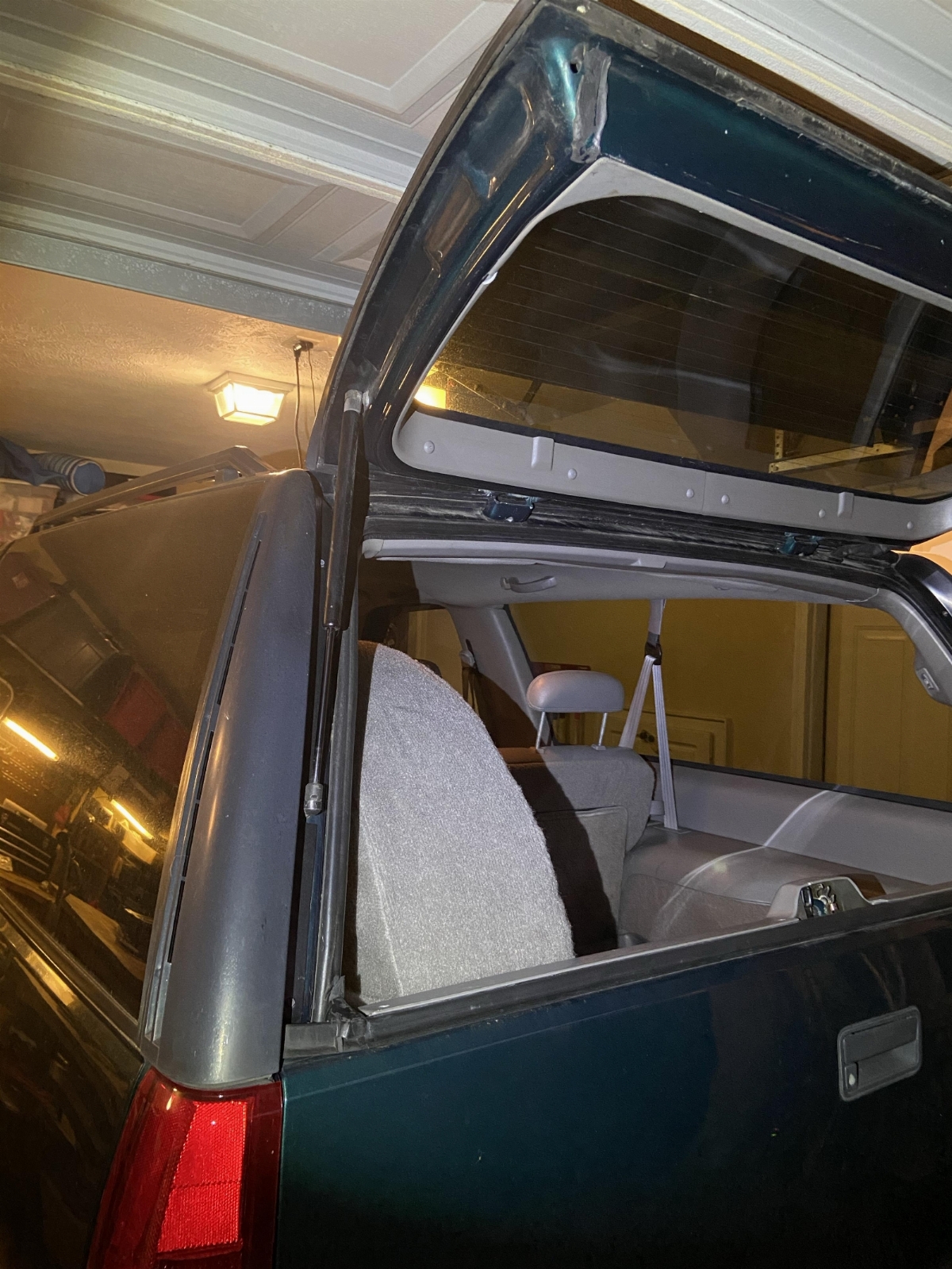

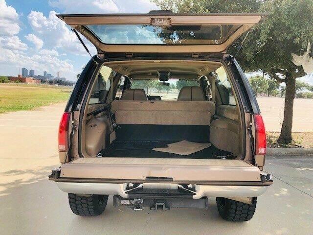

The attachment points did change between the early and later models, so the lengths may vary as well. On my 98, fully open, the pivots are about 17-1/2” on center with the entire strut being 18-1/4” end to end.
If your 95 does not look like this, try comparing your dimensions with a 94 K-Blazer as those are probably the older style mounting points. No guarantees, but it’s worth a shot.
Edit: here is a 94, the arms are a little higher on the body and lower on the liftglass.
