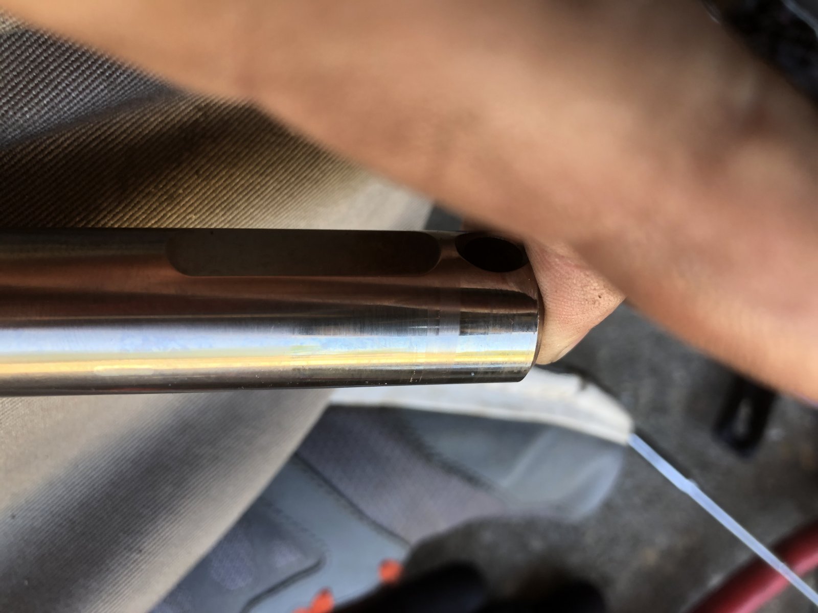

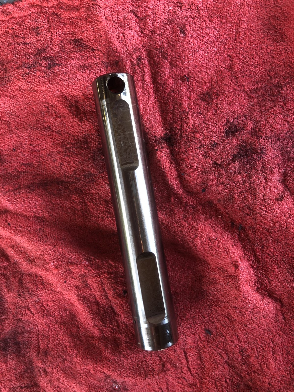

I took it out. The pin looked fine to me. Replaced c clips too. Bolt coming from amazon sunday
Erickk120
Mar 19, 2018
384
216
Pretty interesting, I would say it does look fine as far as wear but I don't like the amount of play it seemed to have in the video, normally the bolt should be able to hold it in place, without up and down movement. I would like to see how the new one fits in place, what did the bolt look like out of it?
This is normally what I expect in a ford, and most that slide out but you can still feel a tight fit. The one in the vid was pretty tight.
SKIP TO 2:18
Chris2144
Jul 13, 2019
222
192
Your cross pin looks like it wore out. The bolt hole looks egg shaped that is where the play is coming from when you push on it. As far as the axle clunk probably c clips. With that much wear I would check backlash with a dial indicator. Also disconnect the driveshaft from the yoke and check for play in the pinion bearing as they are typically the first to go. If any play ie movement is found I would buy a master rebuild kit along with a true trac or ls or locker of your choice and rebuild it. If the bearings are good then just slap a new pin clips and bolt in and be on your way. I didn't see significant wear on the ring gear however i could not get a close look at the spider and side gears though
Good observation, at first i thought I saw it too but then i also realized the image is tilted too, hard to say without looking at the hole at a 90* angle with light passing through it.
