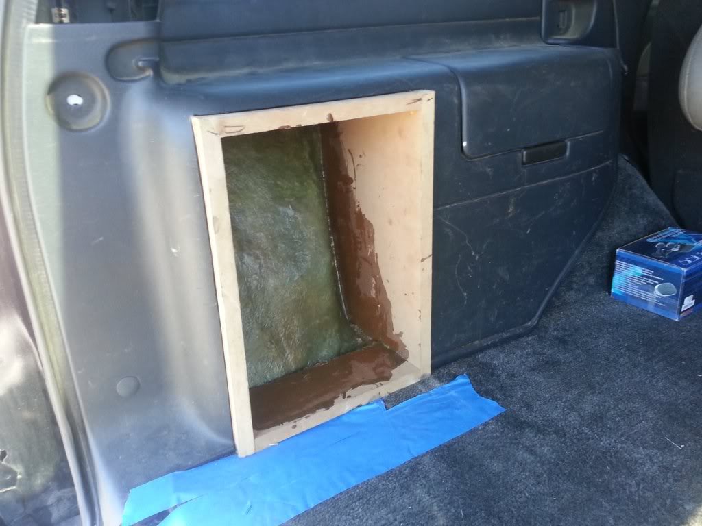

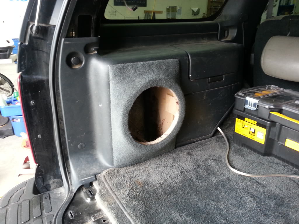

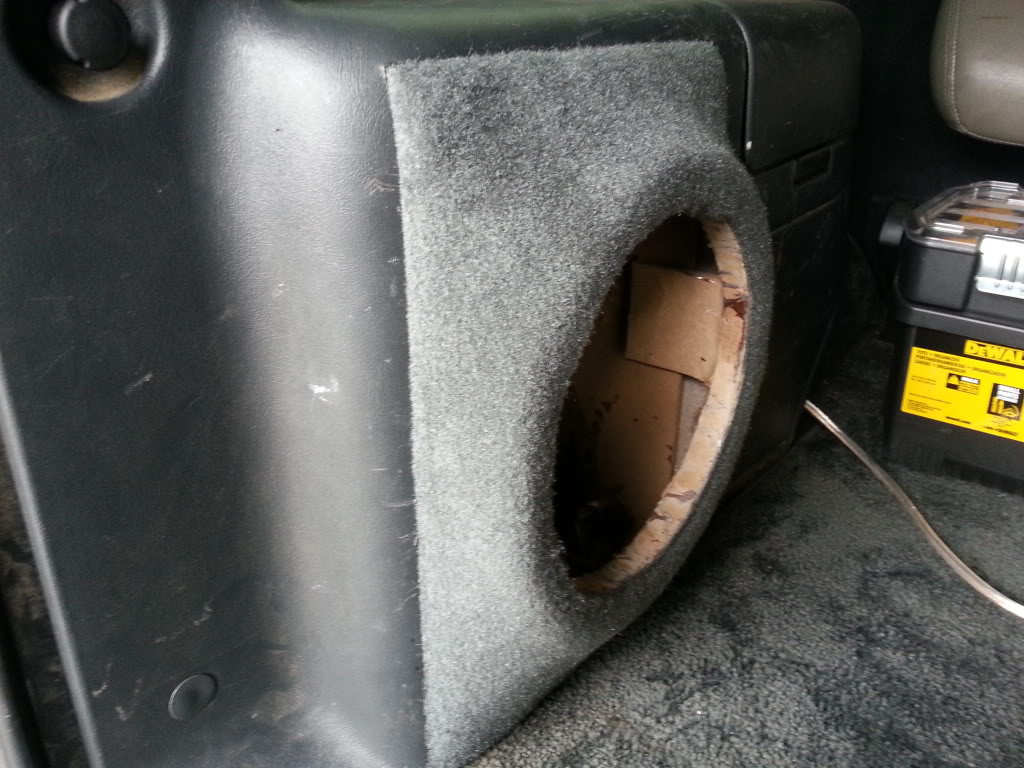

these are some pics of the box i just built for my 02.

Nice groundscr8pr I was thinking something like that too but still being able to keep the plastic cover over the box and if possible also over the speaker to make it look "stock". Here where I live bad people take a look inside the cars for valuables and if they see that box like yours they know it has a good speaker and amp and guess what happens next... broken window and things go missing -_-
Still that's for cars park outside I keep mine on the garage still what if I have to park it outside just don't want to risk it at all.
