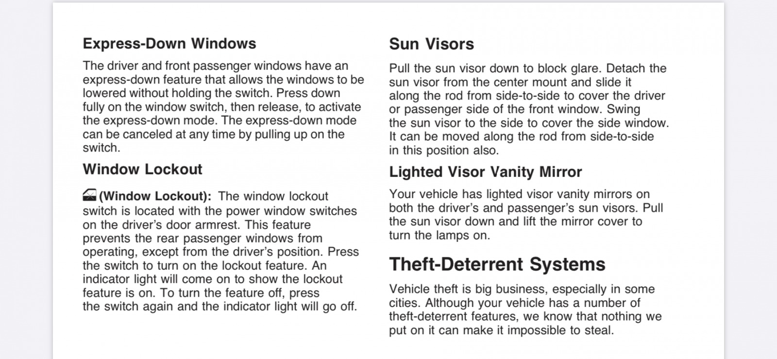

Silly question, but do you happen to have the window lock button pressed on the drivers door switch cluster?

The lockout switch may be faulty since the problem is with both rear windows.
