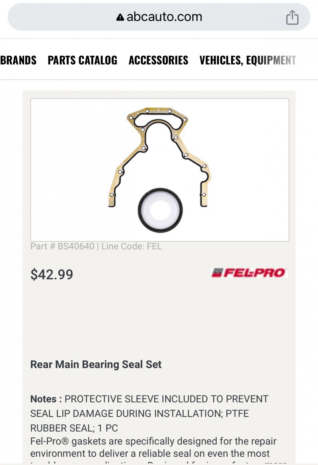

For my 03 Tahoe 2wd with the 5.3 I’m a bit conflicted on what brand I should get for the rear main seal and retainer gasket. I tend to want to stick OEM especially in a job this big but others are telling me Felpro brand is just as good if not better. I’ve got a local parts place here selling both for $42.99.
What do y’all recommend?

I've been using FelPro one for the 2 jobs I've done, but wouldn't hesitate to use the OEM.
Buy the centering/installation tool.
