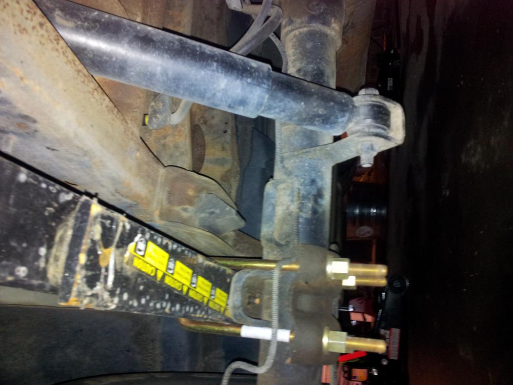

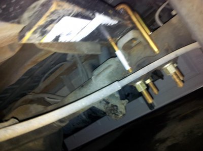

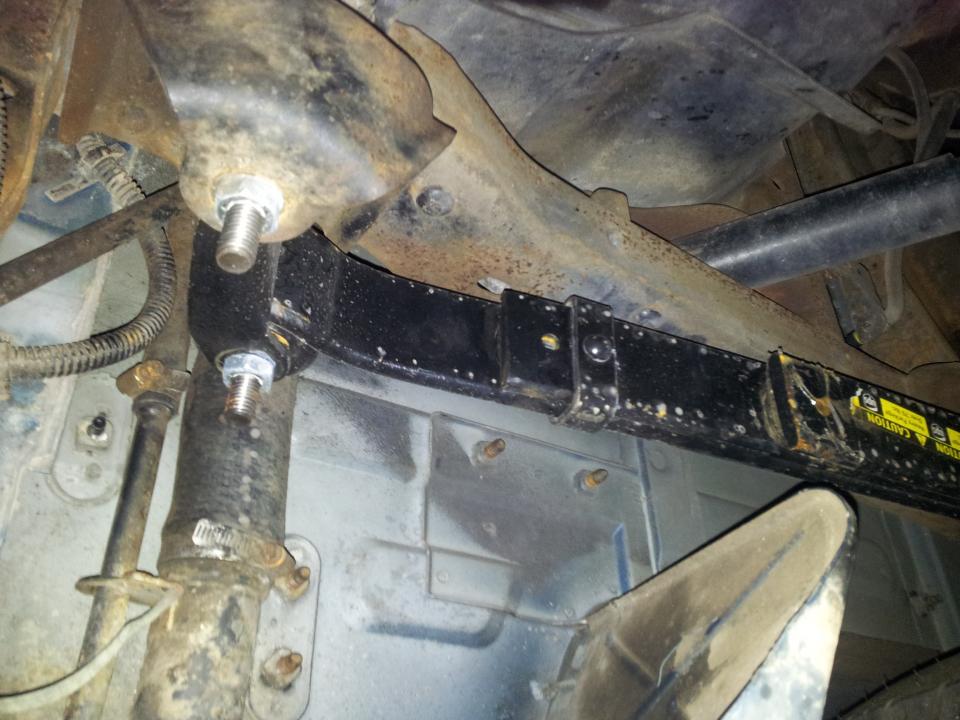

can you take a pic of the rear bumpstop?? if its oem i have to set you up with anew one.
97Supersport
Jan 26, 2013
NORCAL SS
SUV SUSPENSION GURU
Jun 9, 2009
8,744
610
unloosen rear shackles and drive around block and then torque down leafs. if its tigthened with no load will bind
that being said you need new rear shocks and new short bumpstops
are your front shocks bad?
