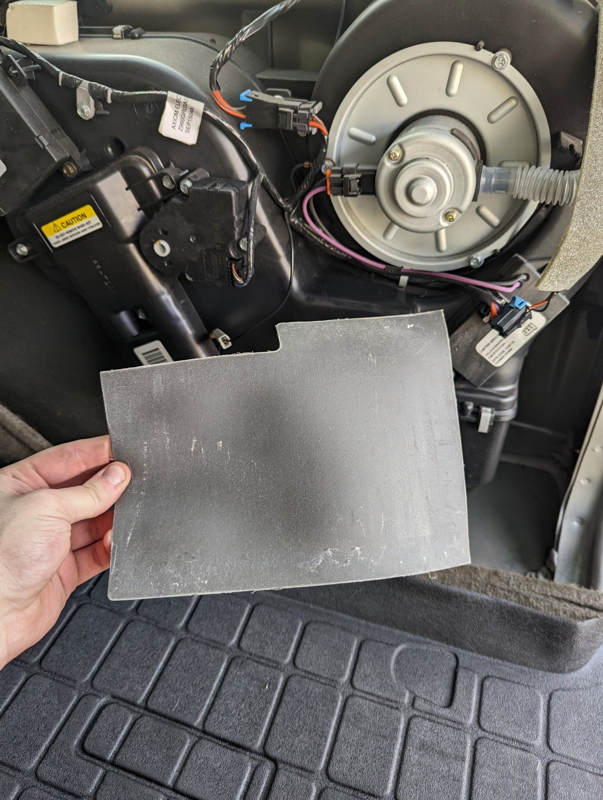

Been like this for a while now.... But it needs to not be like that.
Issue is this: the rear temp control doesn't change immediately. However, I can set it to all-hot or all-cold and days/weeks later, it'll finally pop over. Issue presents the same behavior whether using the front OHC controls, or rear controls.
I have codes B0429 and B0434.
Before I tear the thing open, I want to get my ducks in a row as far as diagnostic steps. Realistically, it looks like it could be one of the following:
- Binding blend door
- Blend door actuator
- Rear hvac control module
Binding would be easy to determine. But what I don't know is how to differentiate between an actuator issue or control module issue. I can't seem to find a pinout diagram / diagnostic info for this from my sources. Does anyone have info on this?
