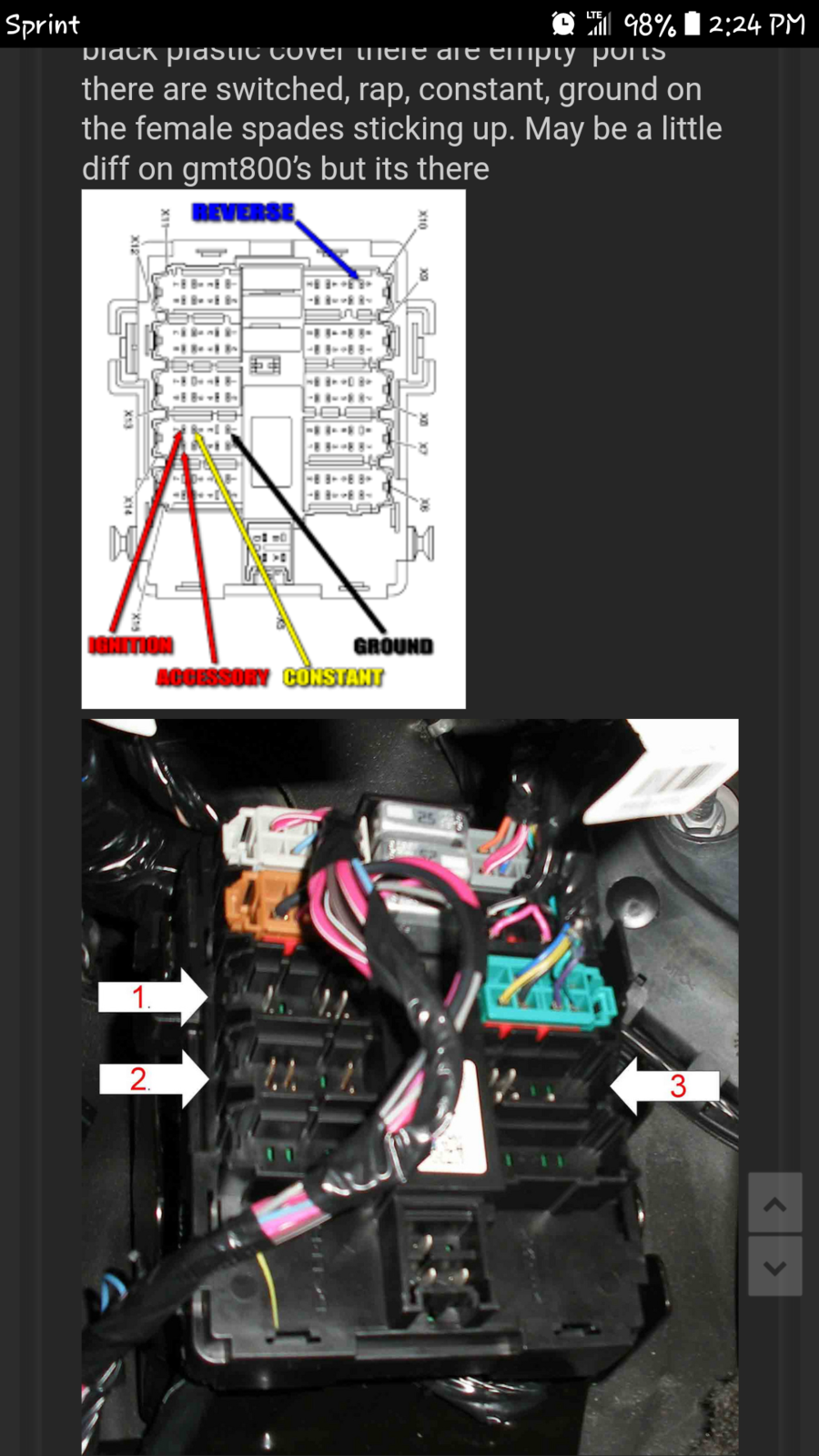

Tap into RAP on the bock under the dash.

Nice! All 3 blocks are basically the same then 1, 2, and 3?
