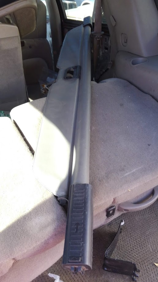

Rear Cargo Cover -roller, difference Tahoe v Suburban

Are the roller type, rear cargo covers different between a Tahoe and Suburban for the 00-06 generation? I recently came across one in an 00-01 Suburban and tried to snap it in place into an 05 Tahoe. It was too wide to get into place in the Tahoe. It appears my assumption that any 00-06 Tahoe, Sub, or Yukon all used the same rear cargo cover. Anyone know definitively what the case is on this? Thanks.
View attachment 268070 View attachment 268071 View attachment 268072 View attachment 268073 rrcover.JPG

Thank you Tonyrodz. Bummer I didn't realize they were different widths. Since they mount points in the side plastic look the same, I just assumed they'd interchange with the 3rd row out of the Tahoe/Yuk/Esc, which seems to be roughly the same length/depth as a Sub/YukXL/EscESV with the 3rd row in place.
With this being the case, I can honestly say I've never seen a short SUV with one of these then. All the ones I've seen were in the long wheelbase SUV.
Thanks again Tonyrodz.

Glad I could help. The swb covers are hard to find. I have 2 lwb for sale, and 1 is brand new. Not alot of people seem to want those.

Suburban, Yukon XL and Denali XL use the 66" cargo shade--extended iirc. They won't fit on the Tahoe, Yukon or Denali swb. Iirc those are 64". They also use different interior mounting points. They won't interchange.
