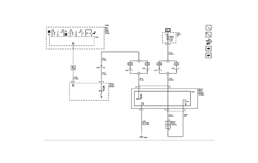

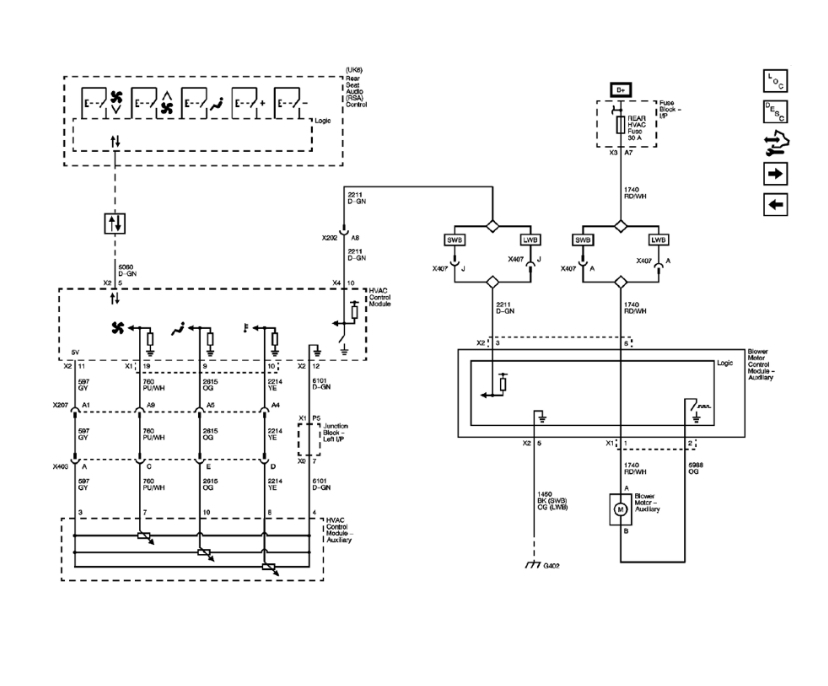

For my 08 Esky but I may get you close.
manual rear controls.
Auto rear controls
