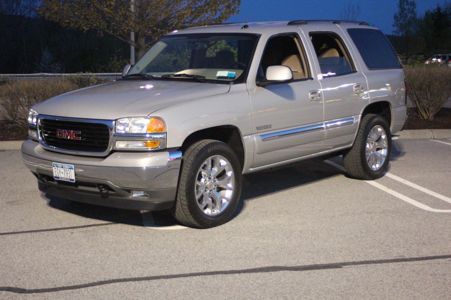

I have the stock autoride springs with billstein 5100 shocks, It sits slightly lower but certainly no sag.
I can have two passengers 300 pounds of dogs and a few hundred pounds of other stuff and it sits level. Unless you plan to haul more weight or tow a trailer with a lot of tongue weight you won`t have a problem.

As i said before if you`re not loading the truck with a thousand pounds you won`t have a problem. I can have 500 pounds in the back and tow 3-4 thousand pounds and still stick my foot between the tire and the wheel arch. It actually handles much better with the 5100`s than the autoride junk. I`m not disputing that they say you should replace them it`s just my opinion that there is no need.

Not to sound like a broken record but i`ll say it again for the third time, Without the autoride junk the ride is more firm and shock absorption is much better. I no longer have the rear end hopping around when you hit a bunch of small potholes in the road, Now the tires actually stay in contact with the ground like they`re supposed to.
Towing and loaded down it handles better than the autoride and has zero sway. If i ever need to haul more weight i`ll just spend a hundred dollars on some air bags to compensate instead of installing z71 springs and having the ass end of my truck in the sky and look ridiculous.

Shocks were fine when removed with no leaks. The only reason i got rid of autoride was the second compressor dying. I`m not sure why you think i`m lying about my current setup working perfectly but i`m done repeating myself, I don`t need autoride nor do i want it.
