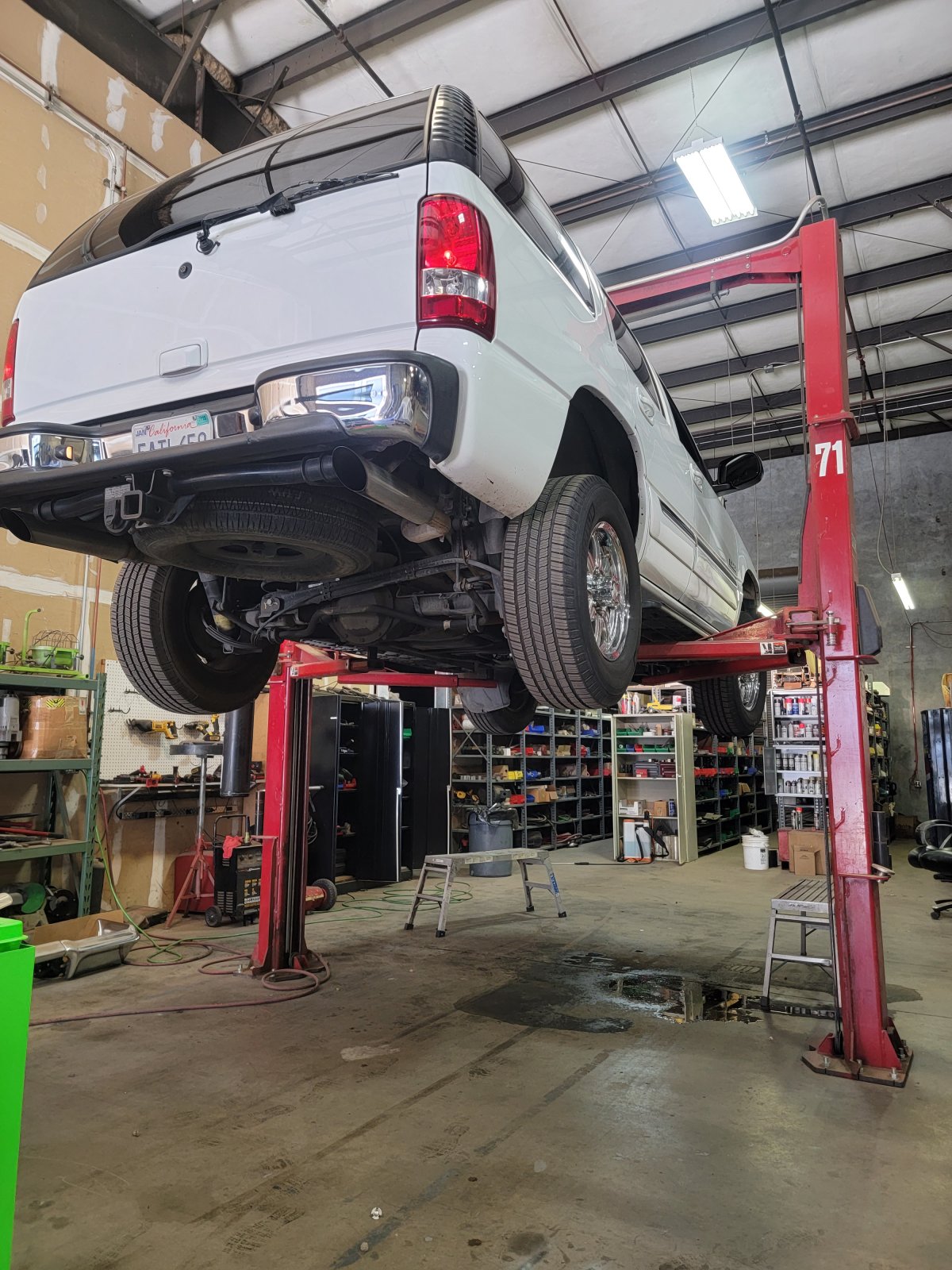

Thanks for the info Bill. I ordered the expansion valve from Amazon $20 and when I had time ran it to my friends shop to use his AC machine to drain before performing the swap. Changed the part and recharged the system. I've put probably 100+ miles since and no screaming any longer (knock on wood). No I'm chasing a oil leak that I fear is coming from the rear seal :-(. Lucky that I have a lift at my shop at least.
