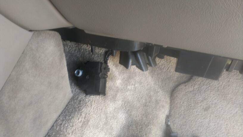

Front temperature actuator is working perfectly. To prove this, I actually removed it and moved the door manually. It is fine. (I can move the door and make it very hot up front or if I close it, it will make it luke warm)

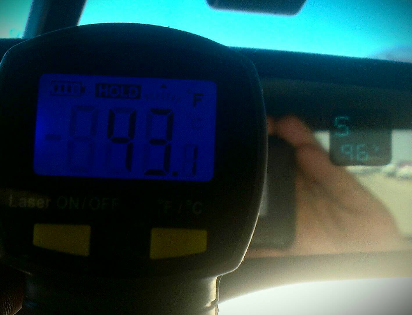

Now I'm bragging...
I'm getting 43F air when it is 96F outside.
