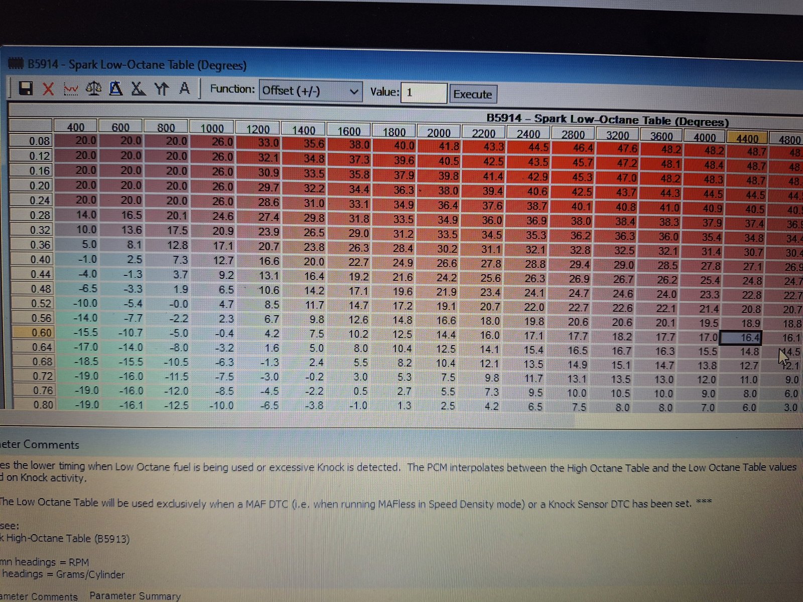

Okay finally got around to getting the timing tables looked at. Been a bad week around here.
Okay first up is low octane timing for an LQ4 and I have a generic cell chosen 4400rpm and .60 g/sec air flow

I'm having trouble with the site and posting more pictures. It says parsing failed... whatever that means. I'll try to get the LQ9 stuff up later. But the timing g difference between low and high octane for the same 4400 rpm and. 60 g/sec cell is 10 degrees of timing.

Almost 10 degrees of timing difference in the selected cell and anyone can look over the rest of those maps and see what timing for a given rpm/air flow volume each table calls for. So yes you can see more power with 91/93. And it is POSSIBLE to get better mpgs with it too. But cost offset of 87 to 91 you most likely will not recoup the money spent.

Your last 4 posts are GM OE tables of two 6.0L V8s, yes?
I'm sure a significant portion would be interested in the 6.2L V8 tables, as in,
Is the low octane table enough to protect a 6.2L from spark knock on 87? Something like that.

Yes those are the gen 3 6.0 engines.
I don't have the software for the newer computers that the 6.2s use.
