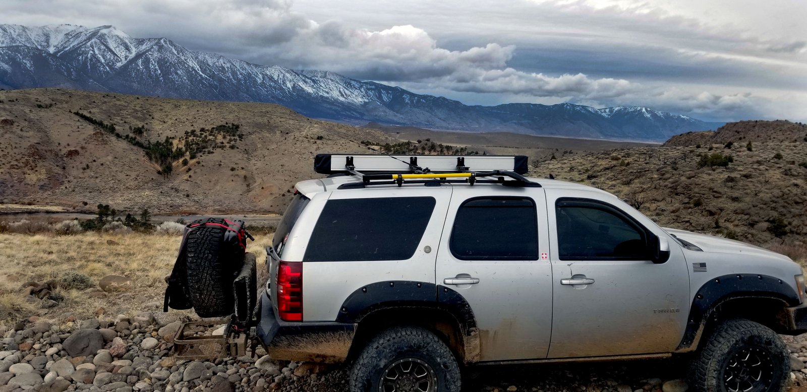

Easily. I did over 2800 miles off road last year. It pulls just fine in high range and if anything is that bad I just drop it in to low range.
This shot was taken running up hill in 4H.

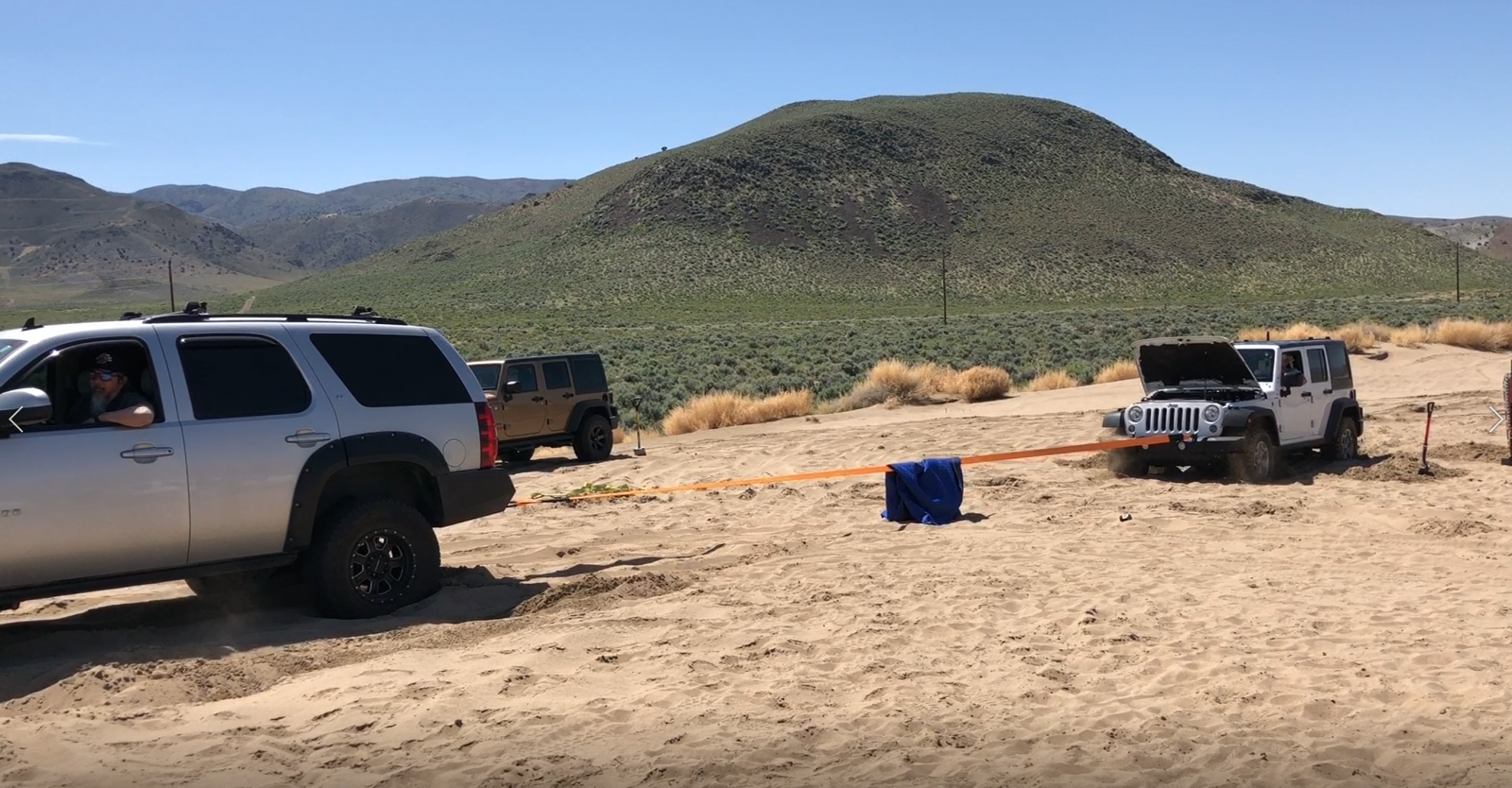

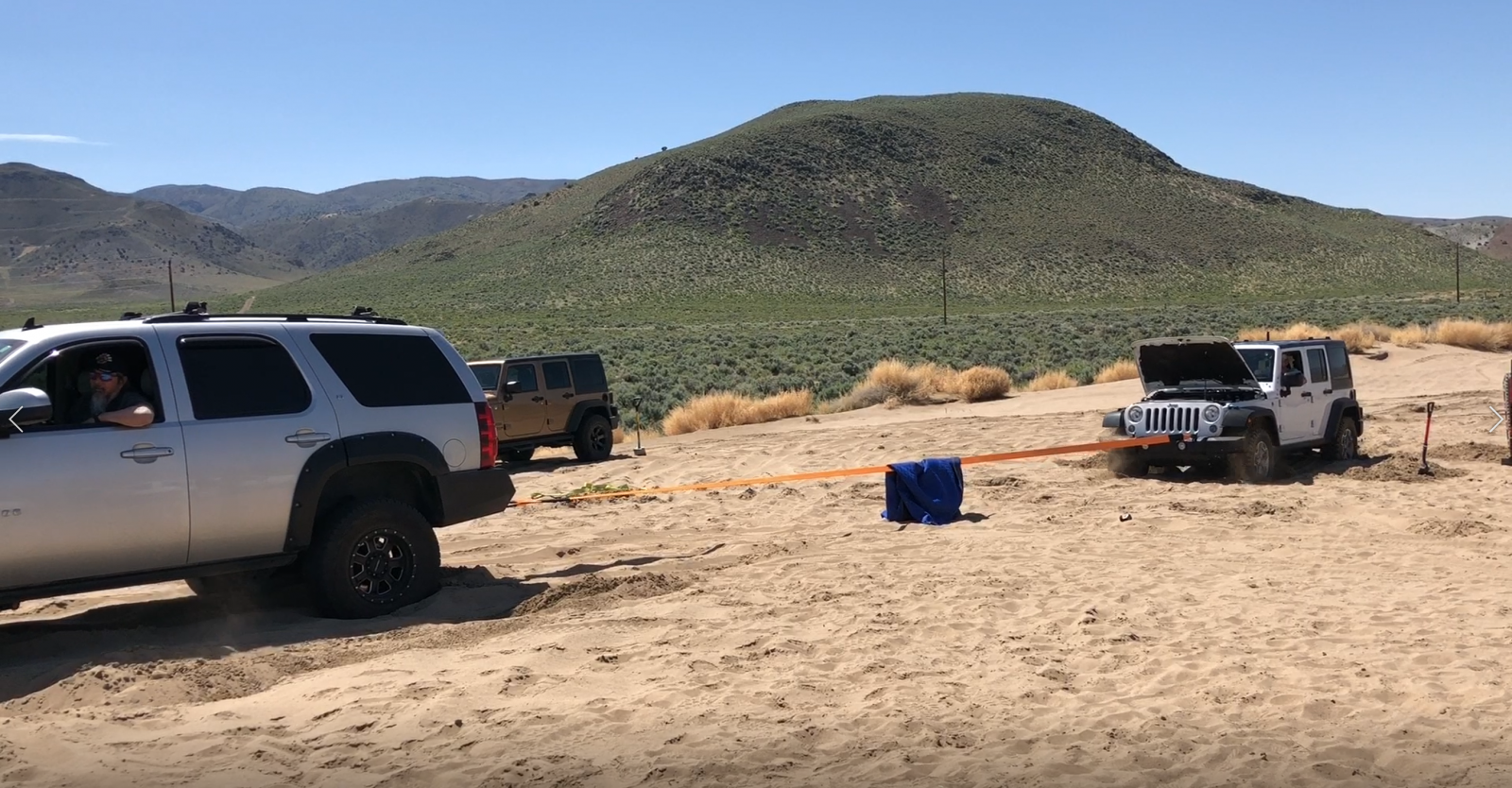

I pulled out a stuck Jeep with ease.
