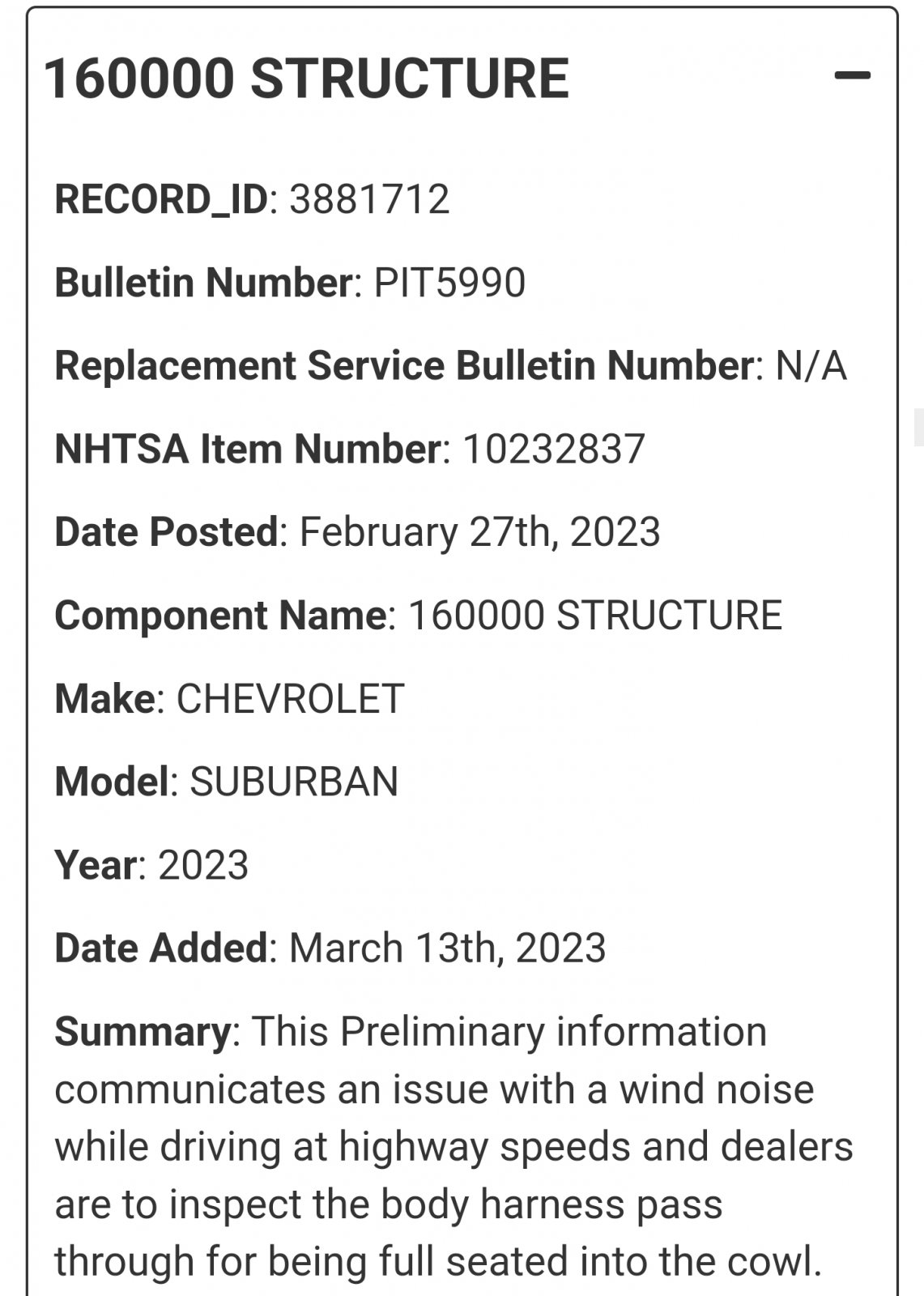

I think I know what it is.
Where can I go to find a copy of a TSB?

I'm going to look at these items on the TSB. I have a rattle that happens above 70 mph on both sides and to me, it sounds like it's coming from inside the A-pillar. I had the sunroof drain TSB resolved and I think it could be those lines. This noise doesn't happen if it is raining which leads me to believe it's those lines. Do they run through the A-pillar?
