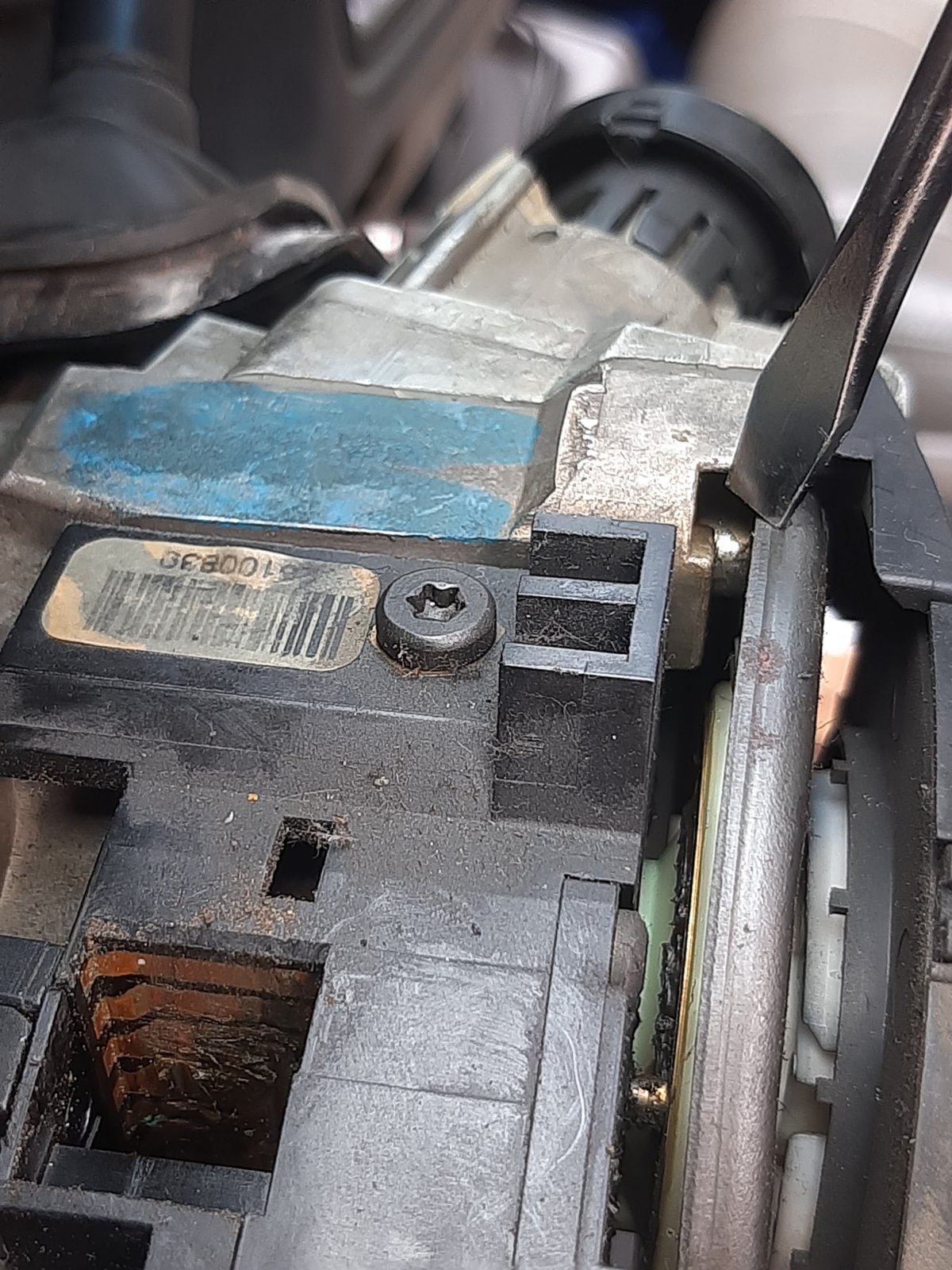

I have removed the plastic covers of the steering wheel and located the 2 bolts. They were pretty snug. But I have tightened them just a bit. In the process I have broken the hazard lights button. I removed the switch by prying on the side wall of the housing and pulling upwards, then I have managed to glue the pieces together (do not lose small metallic pin that resides in the side of the button and allows to fixate the button)
Next I have removed and lubed intermediate steering shaft and got rid of some minor clunking on turns - this became an annual procedure for me)
At last I think I have located the source of my initial problem: there is a steering wheel lock pin that engages when key is removed. It rattles when turning wheel side to side when engaged. I think it may rattle during driving as well as the sound is very much the same. I tried to apply a bit of some thick grease but I doubt that it helps - the part is likely worn out and requires replacement which in turn would require removal of the steering wheel assembly, shifter, etc...
Anyways I will check the behavior on the gravel road and report back.
P.S. picture of the pin attached
Thank you for assistance.
Update will follow
