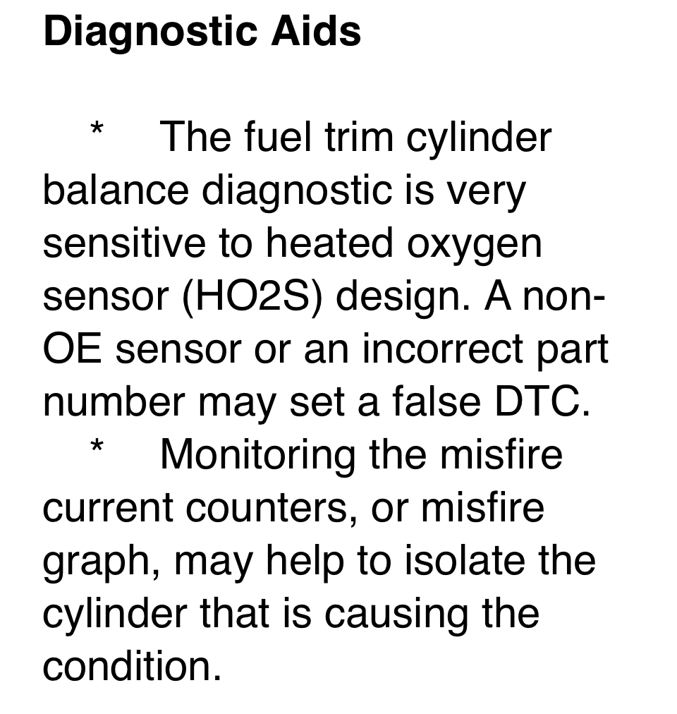

After going through that supplied link for the DTC and reading it, I’m kinda spooked about purchasing a counterfeit part that’d send me on a wild goose chase.

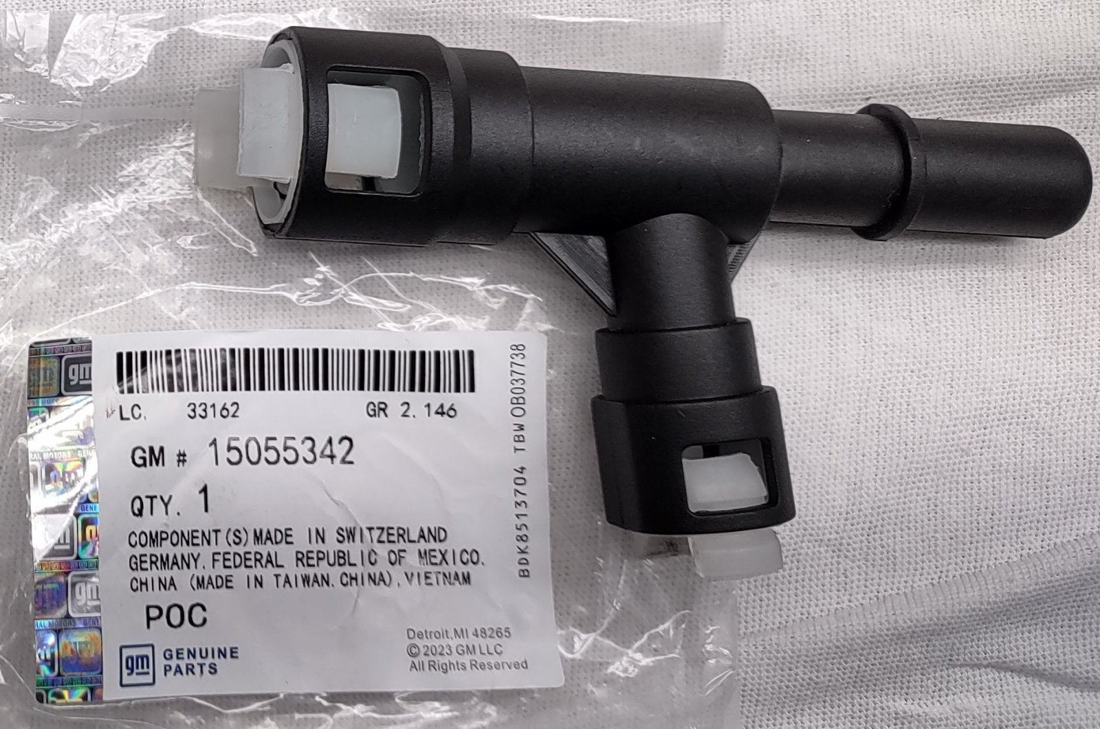

The disturbing thing is that what was OEM eight years ago, may not be the same OEM they sell you today. For some items, production has been moved to other countries, including China. Even though it's still an AC Delco part.... You have to wonder if it's really identical to the original in every aspect. Look at the country of origin on the below AC Delco package... I assume this item is being made in one of those countries, or maybe two or three or all of them... And it's not a generic package with that hologram. I'll bet 10 years ago they had one supplier for AC Delco, probably in Canada or Mexico. So yeah, unnerving to think about.

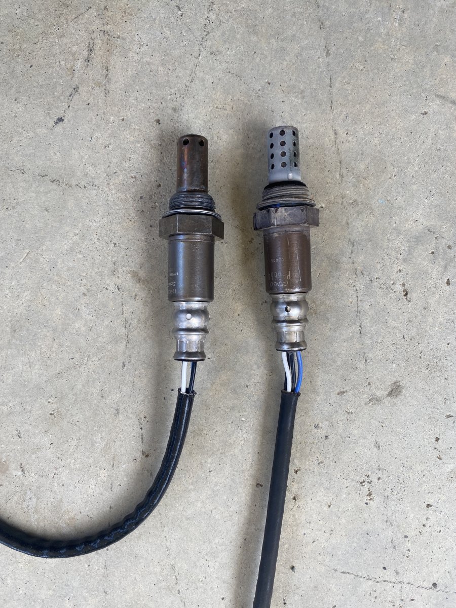

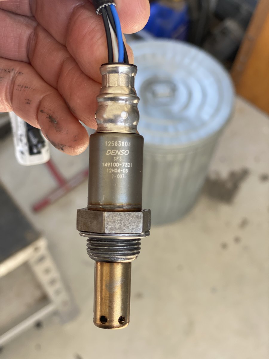

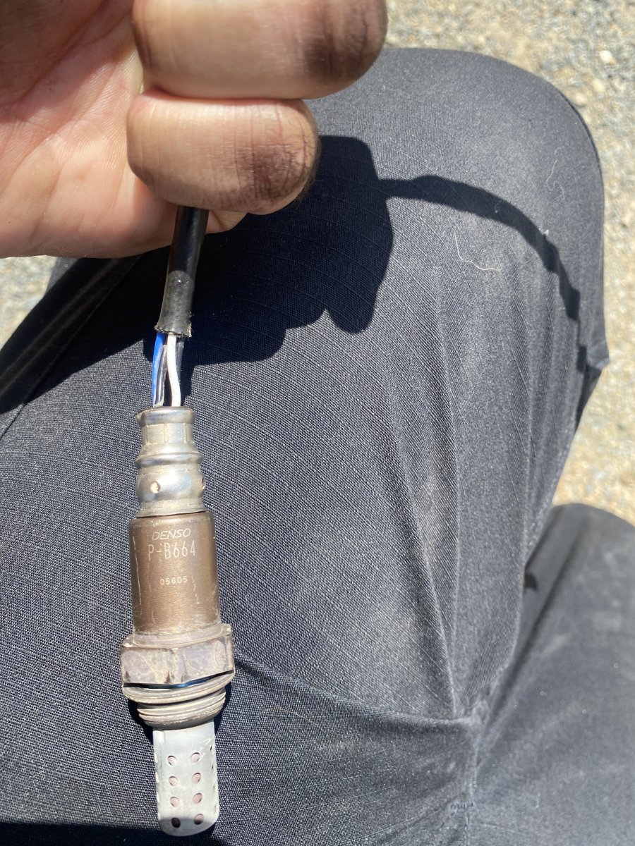

Yes..... I used Denso 234-4668 for upstream and Denso 234-4256 for downstream and I'm wondering if that may be the issue. This code is so "Random" i just don't know. I usually use only OEM parts but they were not available from RA when I bought the Denso's.
funny how there's literally only 3 parts in that bag and made in 6 countries listed lol.
