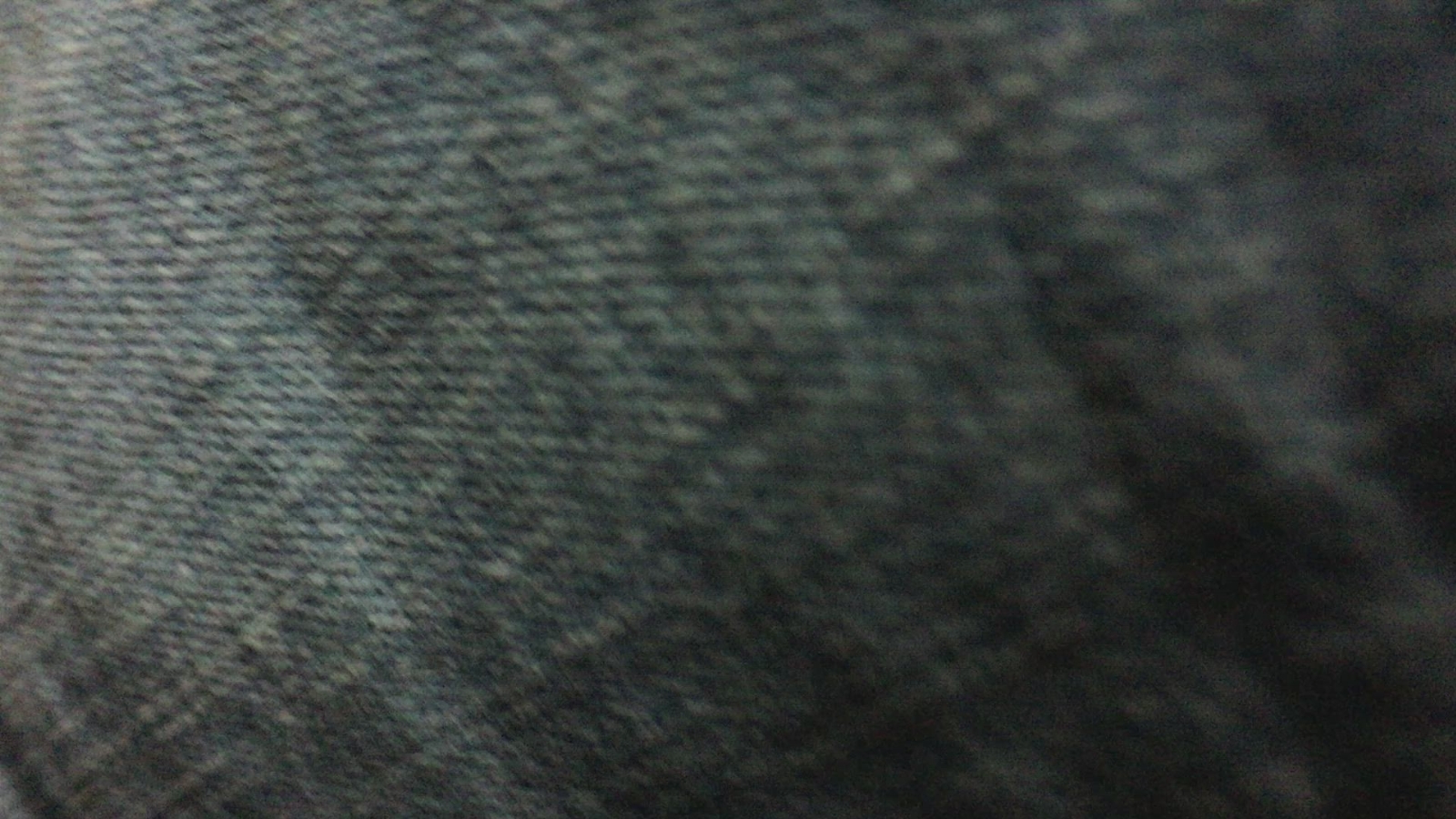

I tracked it down to the Bose speaker in the drivers side door. Please listen to the attached video…. I have the mic end of my phone right up against the speaker so it does sound a lot worse that it really is, but it is a very annoying buzz. I removed the speaker, unplugged it, then reinstalled the speaker without being plugged in…. no noise. Plugged it back in…. noise.
I don’t know if it’s the actual speaker, the amp, radio unit, ground or what but the noise is coming from the speaker and it’s definitely a signal issue vs a vibration issue. Even with the radio off or muted it still makes the noise. Only makes the noise when driving/moving at low speeds (27 mph is the sweet spot). Will not make the noise at a stand-still. Also there are some days when it will not make the noise at all, very random.

Sorry for the delay in updating.... dealer replaced the Bose speaker in the door about 2 weeks ago and the sound has never come back!
